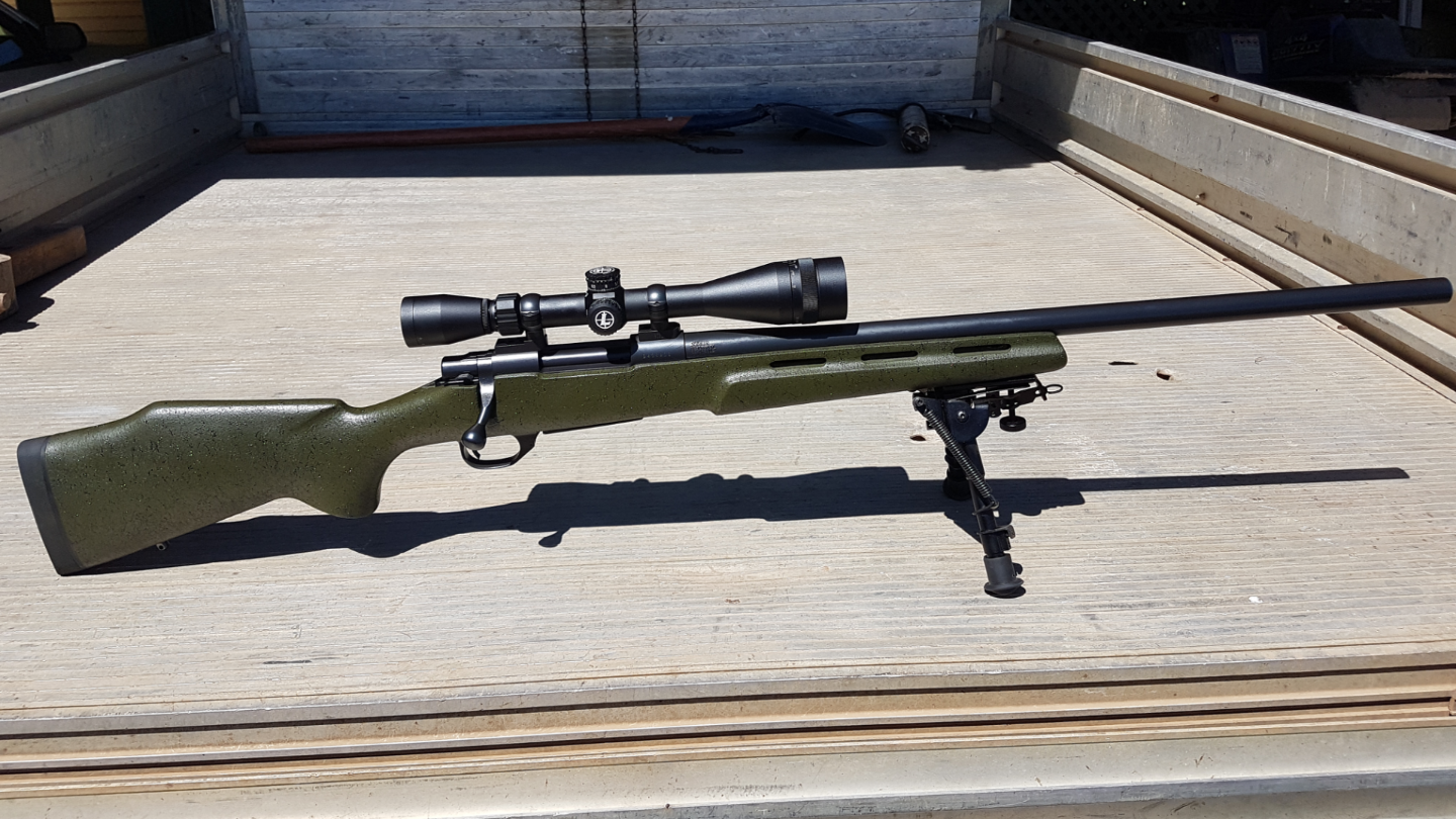

Yeah shes all new mate, bedded the action because the bell and carlson stock had the barrel sitting off center in the channel, and I was keen on learning how to bed so was a good excuse

Hi Kelsey Cooter. Is that a 26inch barrelled Howa? Will be interested to see how your load development goes.

Cooper wrote:Hi Kelsey Cooter. Is that a 26inch barrelled Howa? Will be interested to see how your load development goes.
nah I went with the 24inch, I looked into the 26" but for what I want I thought the 24" would suit me better
