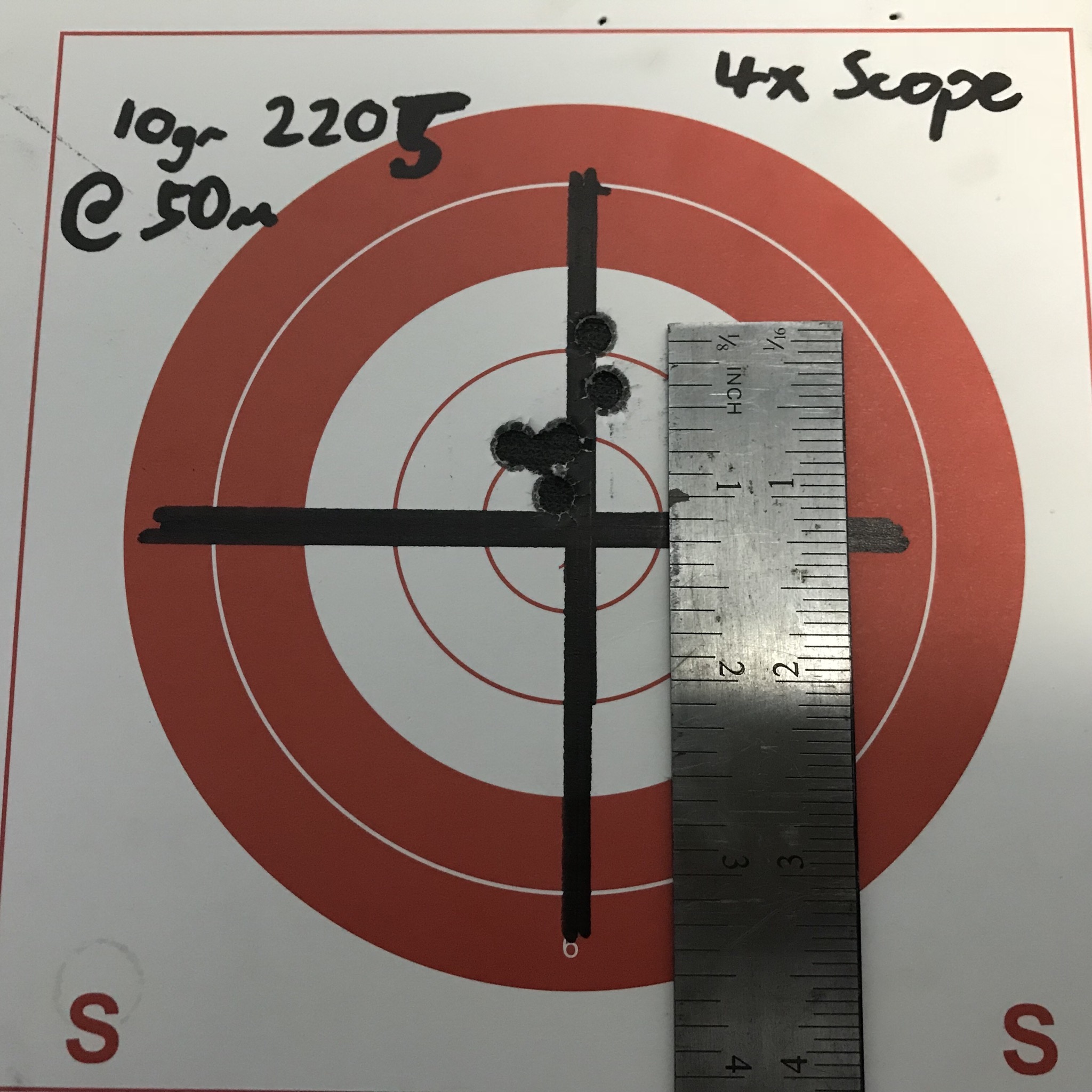

Post by in2anity » 19 Dec 2018, 8:23 pm
Chronoed these at 1420:
HRBC 115gr 32-20 .313”

Post by in2anity » 20 Dec 2018, 9:03 pm
I honestly think the .313” 115gr 32-20 bb bullets over say 9-10gr AP70N might actually work... If you lik I could send you a handful to try

Hadn't considered using TB in a 32-20! Very interesting. I'm using 2205 behind Redback 115gn coated cast FN pills. Out of my 1892 Winchester this combo works well, but your comment has picqued my interest.
I am planning on shooting cast in several of my 303's also, so will be keen to read more or your pathway to knowledge in this regard.
