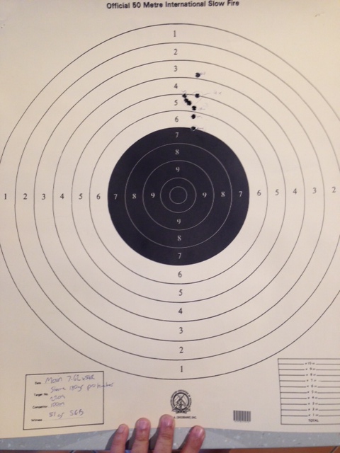

Mosin nagant rifles love long projectiles. Since I was using a 147gr Spitzer, I thought I would try the Sierra 180gr Pro-Hunters projectiles and at my last range session, proved to be a real winner. I tested five different powder charges ranging from 50.5gr to 52.5gr of AR2209 powder. I was amazed that now my 91/30 with plain iron sights can shoot sub MOA if I do my part.
This is one of the targets at 100m. There is two groups in this picture. The first group was a group of 4 shots that is very tightly clustered together next to the number 5. The 4th shot went though an existing hole. The 5 shot vertical string is a little weird but I think that was me due to just finishing lunch with a greasy grip and a little exited.

That was one of 5 targets, each target had similar results with the accuracy increasing and decreasing depending on the charge. I still have to go and do further testing to confirm that my target charge is between 51gr and 51.5gr of AR2209.
I had also took a shot at the 300m gong and the 500m gong and hitting them first shot. I did have to aim a 6 o'clock hold during testing and hitting the gongs. I am just absolutely amazed at what these 70 year old rifles can do.
