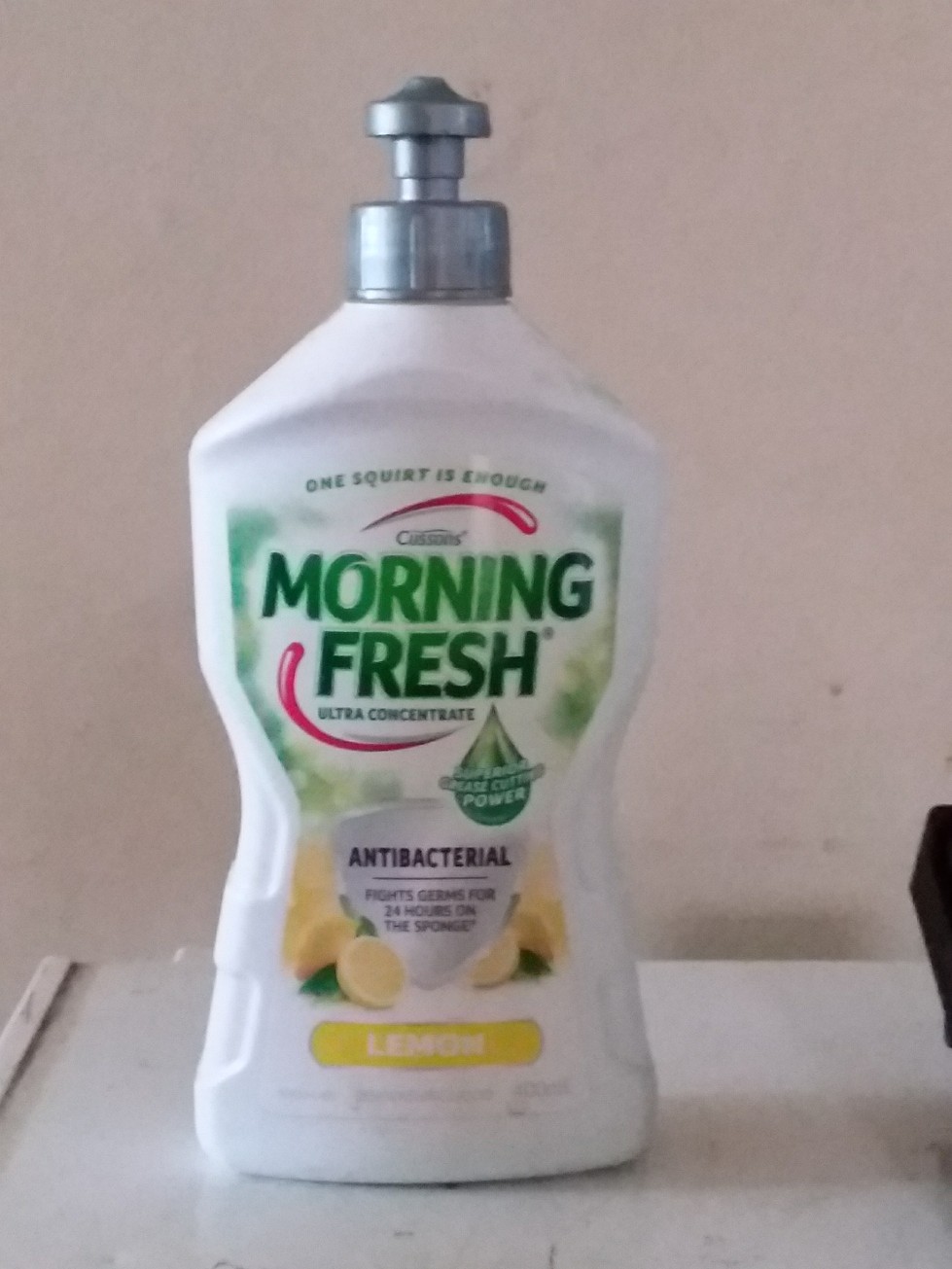

Post by deye243 » 06 Jan 2019, 2:06 pm

Simple I have been using morning fresh dish washing liquid for more than 15 years ....

Does your Mrs know you steal her morning fresh?

Dishwashing detergent, now that is something I had not thought of. I am always willing to experiment.

I used morning fresh dish washing liquid for some time as a lube for drilling steel
it worked a treat but all my drill bits that I had used over time rusted to buggery :unknown:
I would just make sure your dies were well oiled after use :drinks:

marksman wrote:I used morning fresh dish washing liquid for some time as a lube for drilling steel
Yep I wash out with lonolin spay
