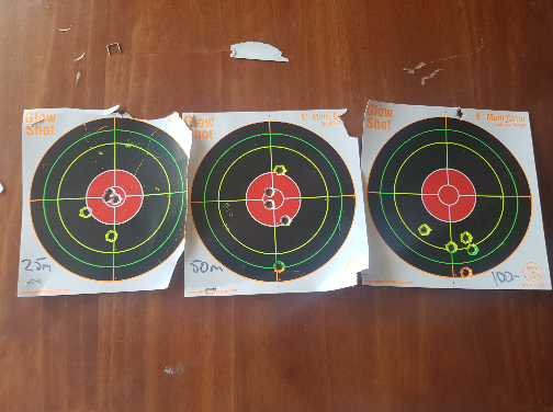

Finally got out to range. I think i need to get a taller front post as I am having to aim about 3 inches low at 100m and even lower at 25m Here are my groups. Have never actually tried using open sights. So i reckon bit more practice and my sights sorted, I should be able to make them a bit tighter

Good shooting mate, all considered I’d be extremely happy with that - your 100m group is tight for a pistol cartridge. A good example of Rossi accuracy potential.

Agreed, I'd be happy seeing that group at 50m, at 100m it's awesome!

Makes you think twice about having a play with a Rossi’s doesn’t it.
