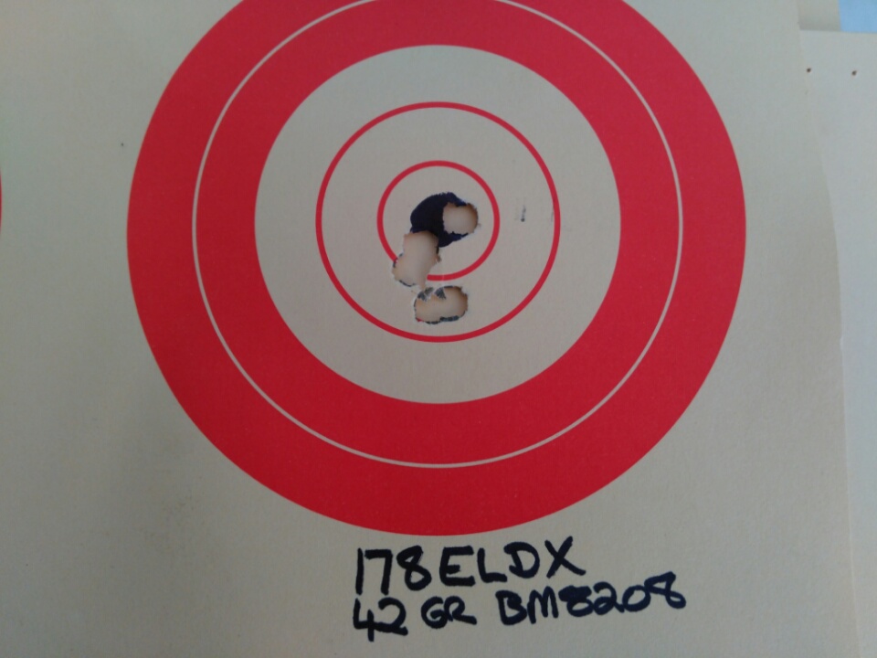

I went to the range yesterday to finalise my hunting load. I found I still had ELDX and Sierra match kings in the box that I had yet to group. I have attached some photos of the groups. I nikko pen the point of aim because the cross hairs on my scope are quite thick.
I was happy with the hornady ELDX also, honest groups at most test loads, the 150 gr did ok also. I cannot use these because the extra weight of this projectile does not match my BDC scope aim points.
178gr ELDX 42gr BM8208.jpg (130.28 KiB) Viewed 7490 times

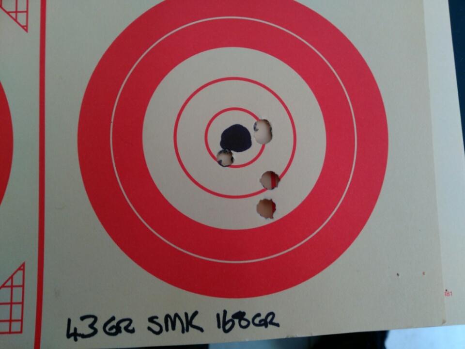

Might need some further tuning with seating depth, but I tried 4 different powder weights and had similar results. These are not a hunting projectile anyway, I was just keen to see if they performed as promised.
168gr SMK 43gr BM8208.jpg (135.41 KiB) Viewed 7490 times

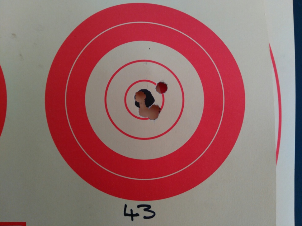

The winner. Case overall length 2.750 inch. This load matches my BDC scope near perfect. Piggies beware.
165gr SGK HPBT 43gr BM8208.jpg (129.52 KiB) Viewed 7490 times

Thanks for the info. I had the same result with the 168gr SMK, they don't seem to match the gun well. I will have to get the 165gr SGK and test them out. I will post my results.

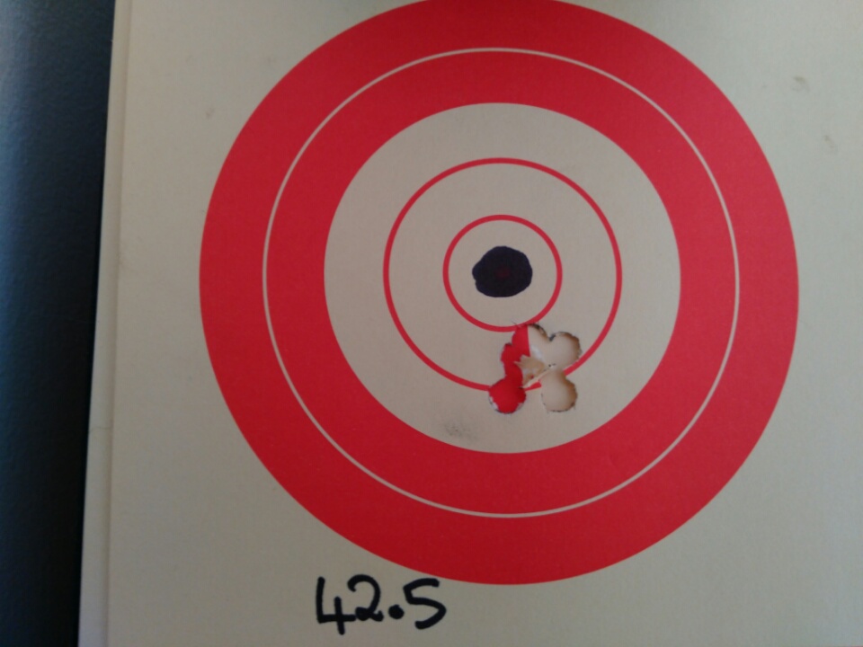

I have attached one more for your interest. This was the 165gr SGK HPBT at 42.5gr of BM8208. Still a good honest group. I discovered one more thing with this rifle. I was over cleaning it. I removed every trace of dirt and copper fouling after my shoots. It will not group this clean. I looked back through all of my previous work and found it would not group until it had fired at least 15 rounds through it. It seems to like being hot also. I was once rushed to finish some load testing before the range closed. The barrel was near sizzling to the touch but still could put 3 shots in the same hole. So take some fun ammo to dirty, and warm it up before you try your loads. I had no luck in seating the projectiles out towards the rifling. I actually found bigger improvements seating them deeper. I had some 130gr Speer hollow points, flat base things left over from my Omark. The Lithgow did not like them one bit, sounded like a howitzer going off. I pushed them back to COAL of 2.61 inch from memory and Shazzam, through the same hole. They actually out grouped all of the other projectiles that I tested that day. A fast and devastating projectile on anything, even large pigs. Add them to your list if you are looking for a varmint style round.
You should find a good load somewhere between 42.5 and 43gr.
165gr SGK HPBT 42.5gr BM8208.jpg (122.56 KiB) Viewed 7443 times

Buster cap, that 165gr HPBT @42.5gr seem a bit of alright! If was me I would go up 4clicks and call it job done! As for the “hot” ammo shooting better, I remember reading something about snipers in the Middle East laying their rounds out in the sun to improve the accuracy.
