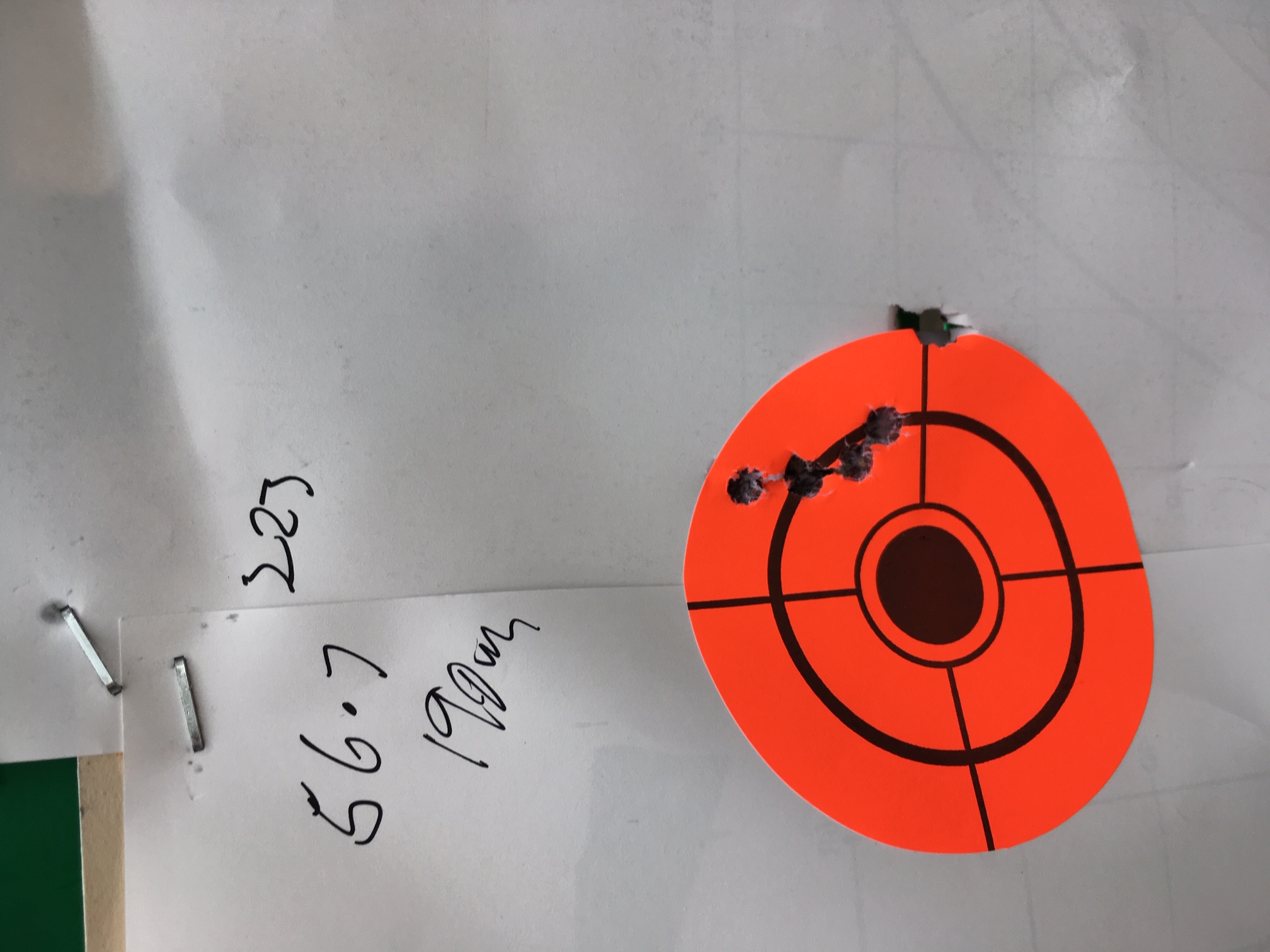

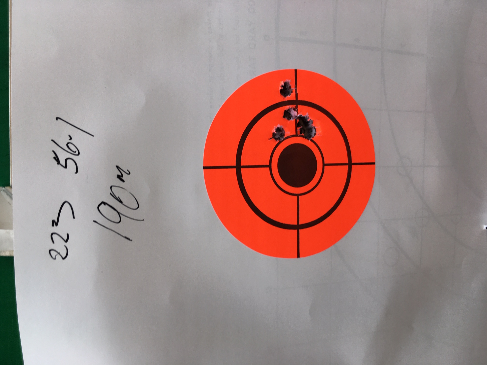

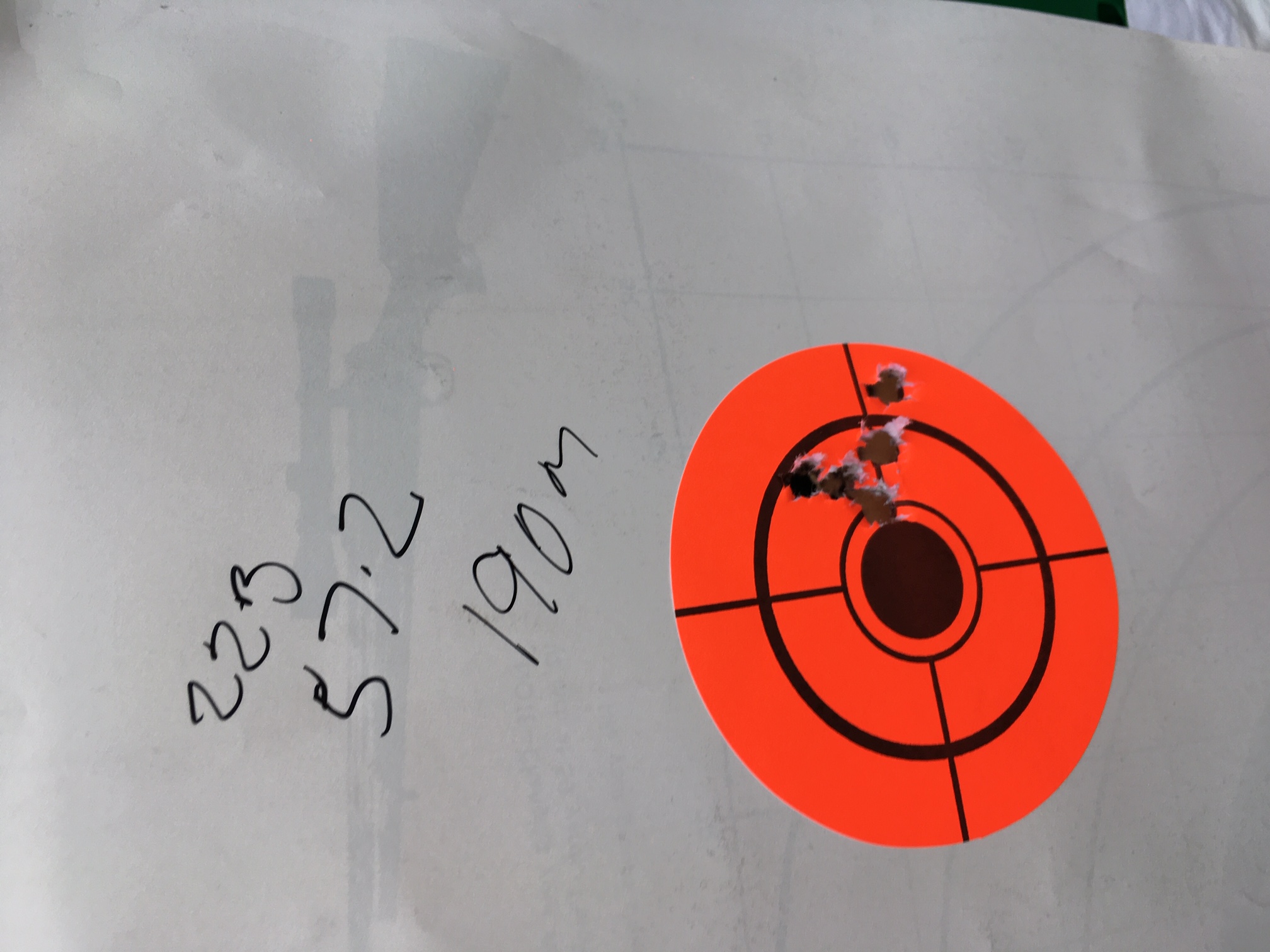

Got a couple hours away this evening and thought it a good time to check some seating depths on the ole roo max 55 gn's.
Ive already played with the powder charge and found 24.5 and 26gn of AR2206H was pretty close - so this for this test I went with the 24.5gn of ar2206h and varied seating depth across 3 lengths.
Shooting at 190 metres, small shooters table and bi pod, AR 4.5-18 scope on 223 steyr varmint. No wind and 15% c. The orange targets are 3 inch in diameter.
I really struggled with the scope at this distance - the reticle was obscuring the centre target.
All pics are out 90 degrees - they needed rotating to the right but didnt get option to do so.
57.20
223 57.2.jpg (554.7 KiB) Viewed 7499 times
56.70
223 56.7.jpg (570.58 KiB) Viewed 7499 times
56.10mm
223 56.1.jpg (555.5 KiB) Viewed 7499 times

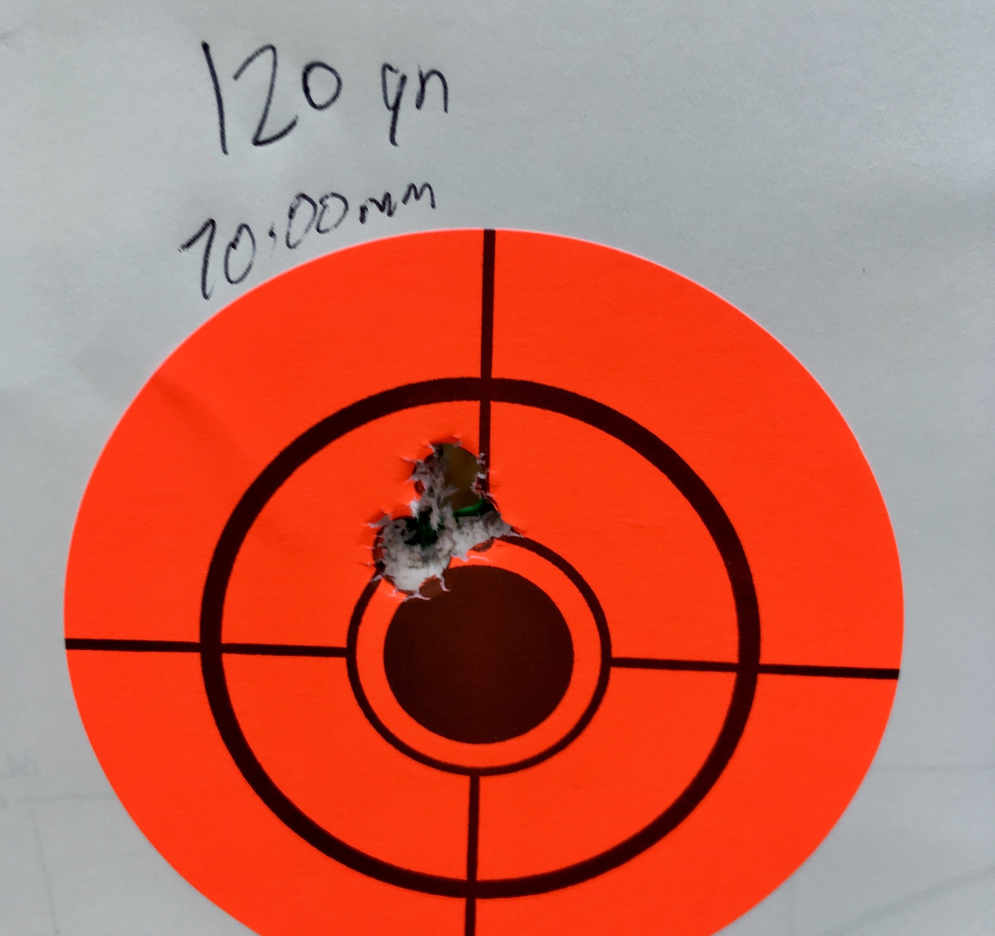

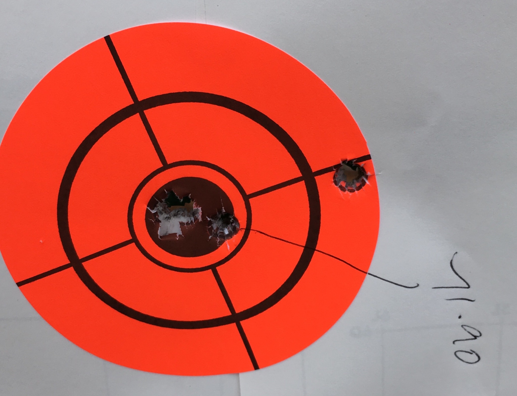

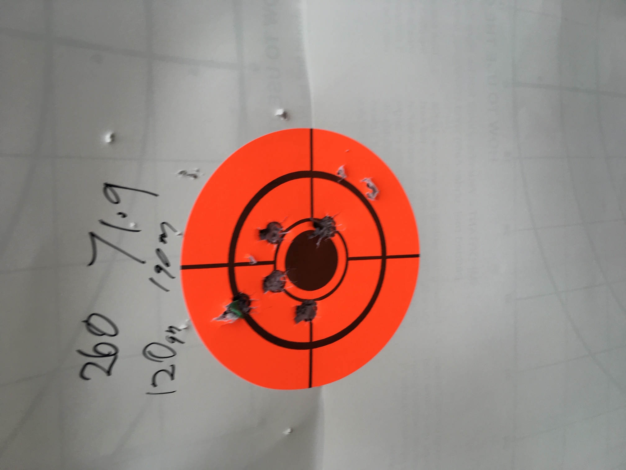

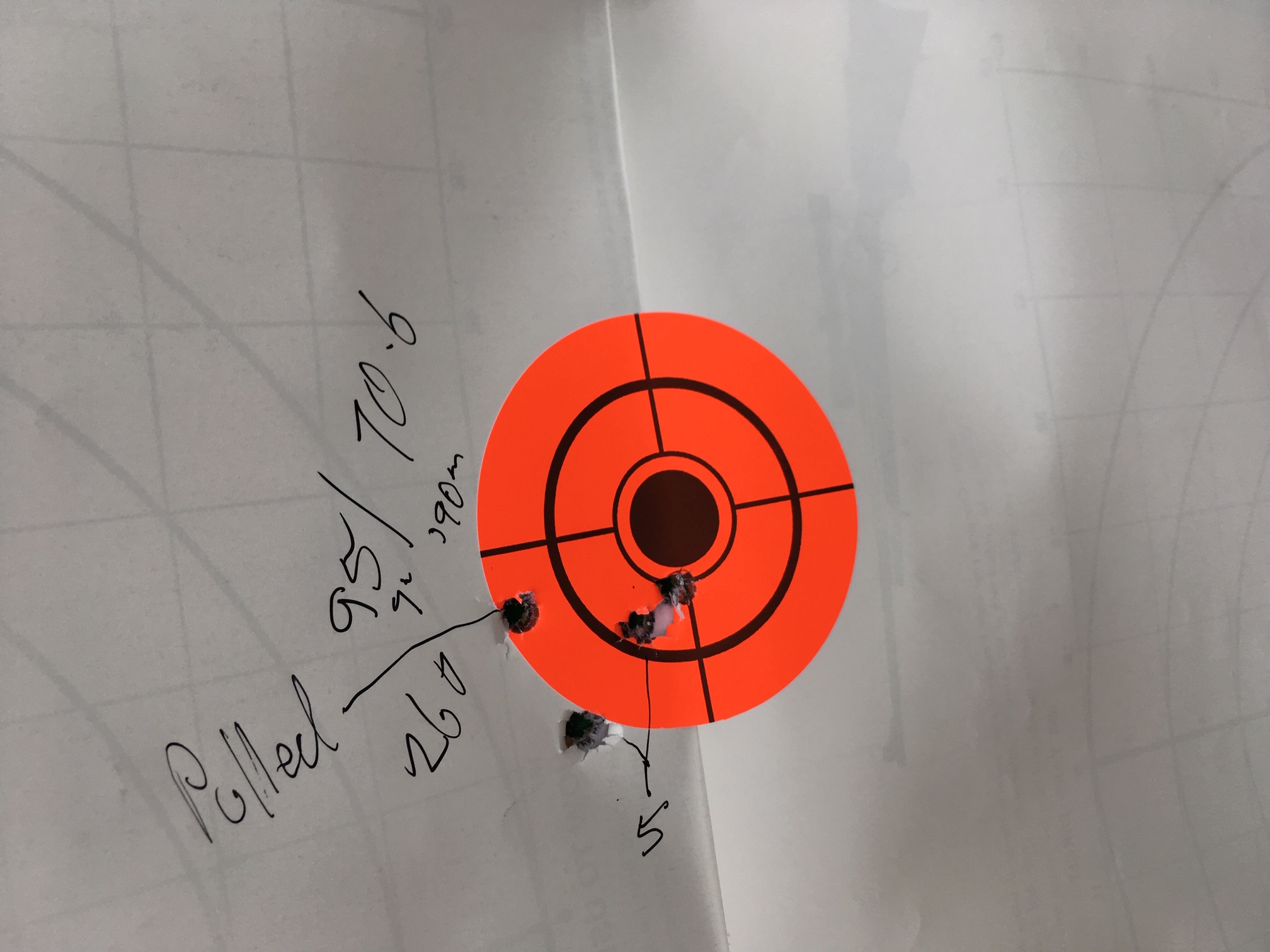

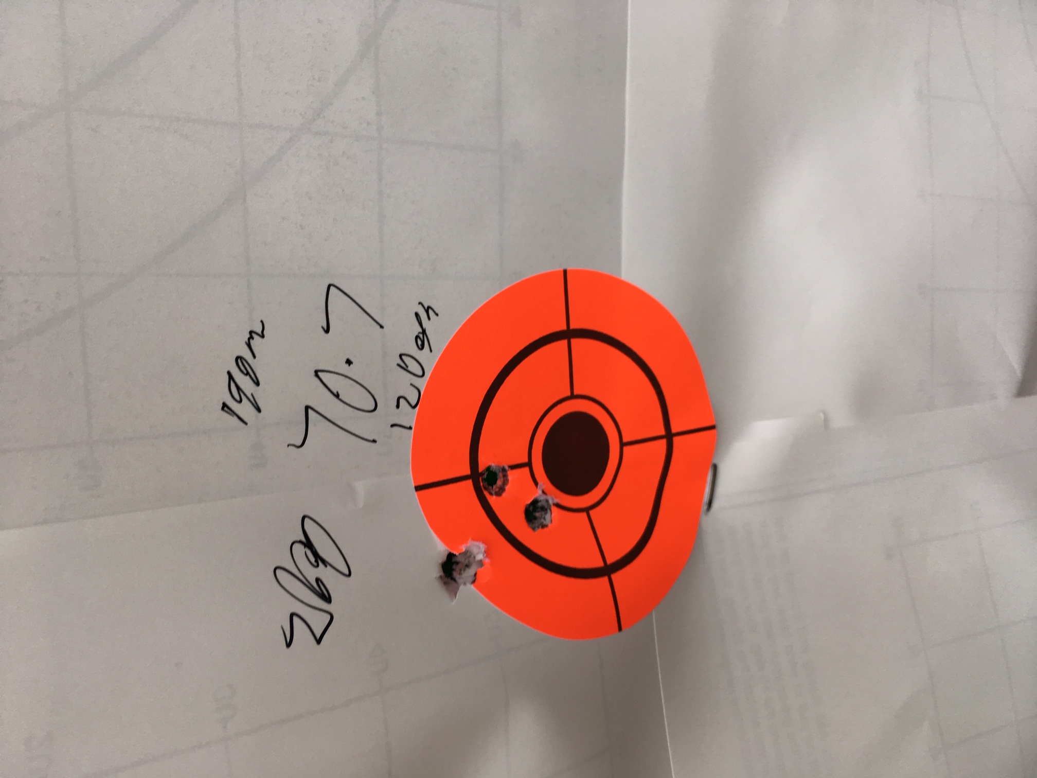

Also got some time with the 260 - using 120gn noslers, bi pod, small desk was a bit wobbly on this one. The 6-20 leo scope is much better on this than the 223...
190meters x 5 shots each grouping. 3 inch targets and I called the pulled shot...
Frustratingly - not as good as Ive shot this rifle but I know it was me / set up and the 95's I shot last - I was just all over the shop and not on the ball at all.
rem 260 95s
rem 260 95gn amax 48gns powder 706.jpg (576.34 KiB) Viewed 7496 times
70.70
rem 260 120gn nosler 70.7 5 shots @ 190m.jpg (599.31 KiB) Viewed 7496 times
71.90
rem 260 120gn nosler 71.9 @ 190m.jpg (520.14 KiB) Viewed 7496 times

They are excellent Tassie, and you are using very cheap projectiles. What was the size of the smallest group? Do you think seating depth made much of a difference? Was there a difference in speed betweenthe longest and shortest? Were you able to jam the pill into the rifling?

Cheers - always room for improvement. 200 yards is pushing my eyes to the limit...scope might be getting changed to a Leo soon I think...this rifle deserves it.
It’s strange - the 56.10mm is a LONG way shy of the rifling and the most accurate. Approx 1/2 moa at that distance - didn’t formally measure yet...
The 57.2mm was at the max length distance that I could load as the roo max are shortish projectiles and I wasn’t comfy seating them longer - but that’s still were short of the 63mm I’ve loaded with 60gn ballistic tips.
