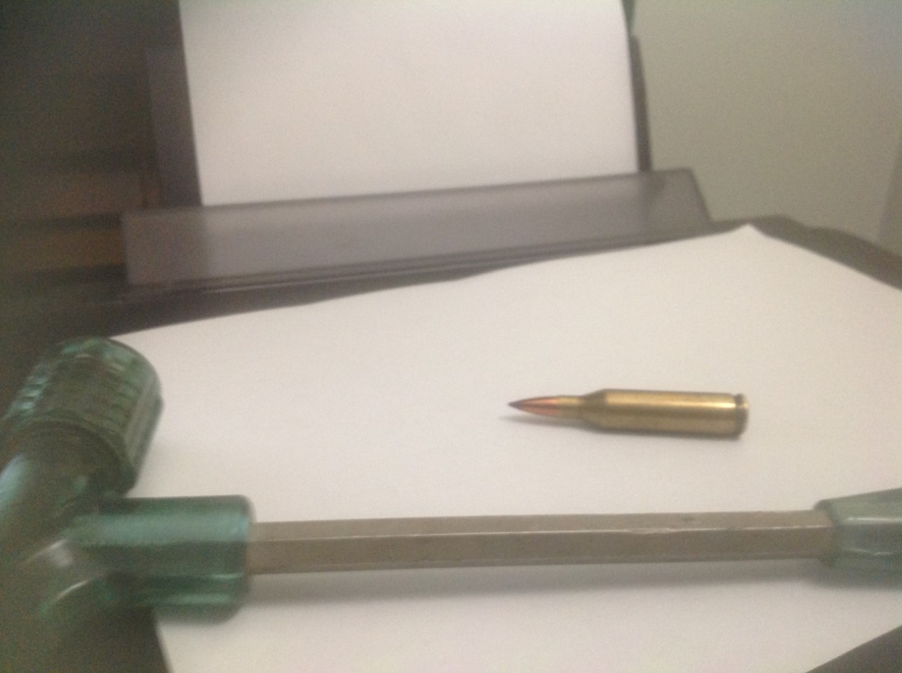

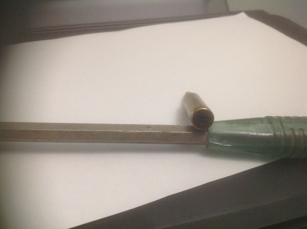

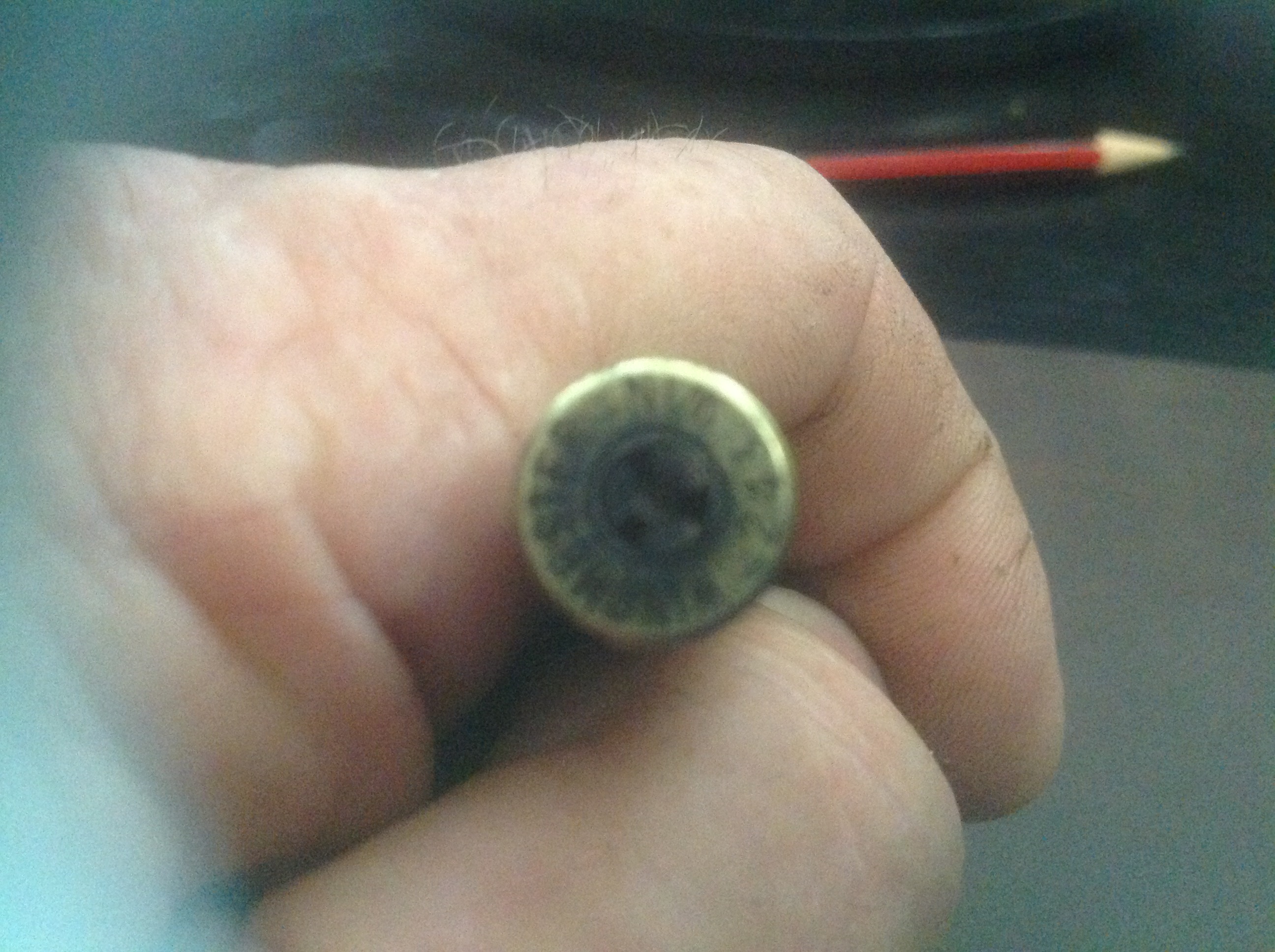

This happened.I am sure the flash hole was blocked and the primer has taken the worst of it.When I pulled the round it had powder and the projectile had not moved.These purple nylon tipped rounds were assembled by one of my team now I don't trust the rest of them.I am gratefull it did not happen at the range.Anyone else have this happen :unknown: :unknown:

Was it put in upside down and set off by the firing pin I can't tell as the pic is crap

Post by duncan61 » 26 Feb 2019, 10:37 pm
Thank you I will go have a better look that could be the case

Post by deye243 » 26 Feb 2019, 10:53 pm
It looks like the anvil is concave.....
If so you might want to pull the firing pin assembly and give a good clean .......

Post by duncan61 » 26 Feb 2019, 11:05 pm
yes it was in backwards well spotted

Post by straightshooter » 27 Feb 2019, 6:53 am
If what earlier posters have surmised is in fact true then your firing pin may be somewhat off center.
Have a look at a normally fired round and evaluate just how far off center the firing pin blow actually is.
A seriously off center firing pin can contribute to erratic ignition as distinct from missfires or hangfires.
