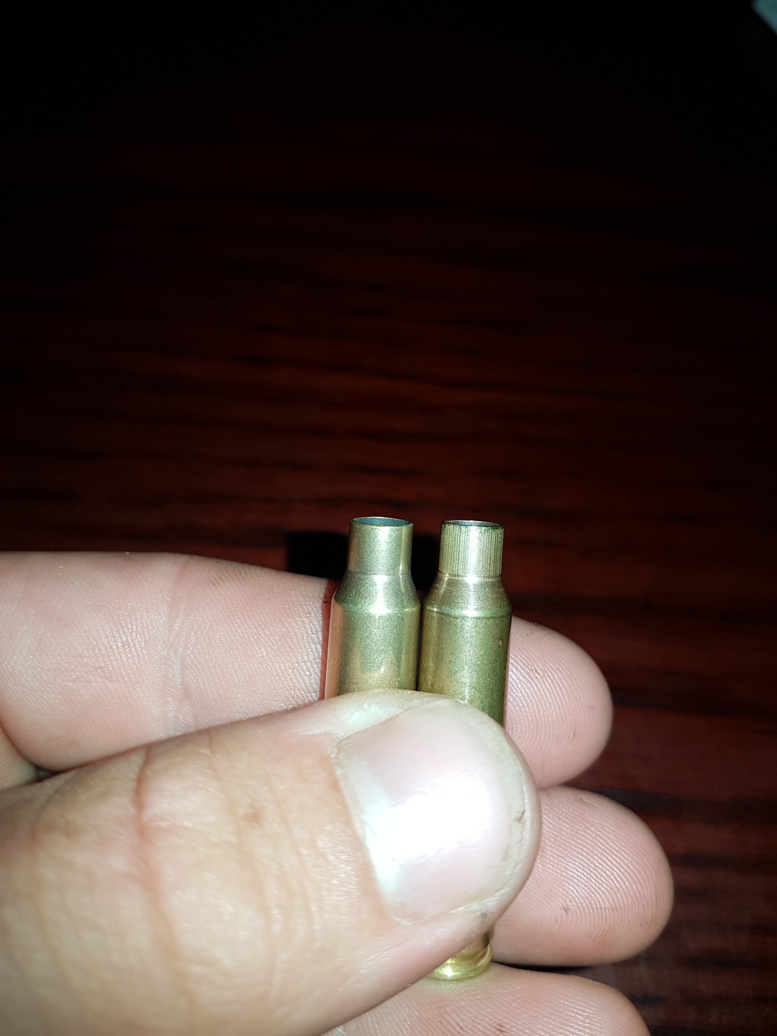

Post by Kelsey Cooter » 05 Mar 2019, 4:20 pm
What do you blokes think of this? My lee 308 full length dies don't leave marks like this. I know I saw on here blokes talk about polishing their dies, do I need to do this? Or is this not a drama? Or do I need to invest in a higher quality dies?
The die has marked the necks from new but I didn't really know any better until I started loading 308 and noticed only the 223 FL sizer does it.

Post by goldiexxxx » 05 Mar 2019, 6:00 pm
Hell man, that doesn't look right!!
Try poking a sharp pointed object inside the die and see if you can feel what may be causing those marks. Give the die a good clean by dragging a cloth patch through maybe. Your brass should not look like that as you have already identified.
Take the die back to the shop and see if they will exchange or provide an option.

Post by Oldbloke » 05 Mar 2019, 6:06 pm
Give the die a long soak and a good scrub in kero.
Re: My Lee 223 FLS dies leave scratches/marks on the necks
Post by marksman » 05 Mar 2019, 6:09 pm
pull the die apart and clean it, it is rough in the neck area
then get an old 22 cal cleaning brush in a drill load it up with some steel wool and some metal polish
I use autosol but if I had nothing I would use some oil or spray
then polish the inside of the die body especially the neck area and it will come good, steel wool with autosol will not scratch your die
I do this with all my dies :drinks: I also give the seating stem a good polish the same :thumbsup:

Post by SCJ429 » 05 Mar 2019, 6:51 pm
Interesting marks, I am with Marksman. Clean them and a bit of Autosol. Lee make very good dies for the price. Let us know how you get on.

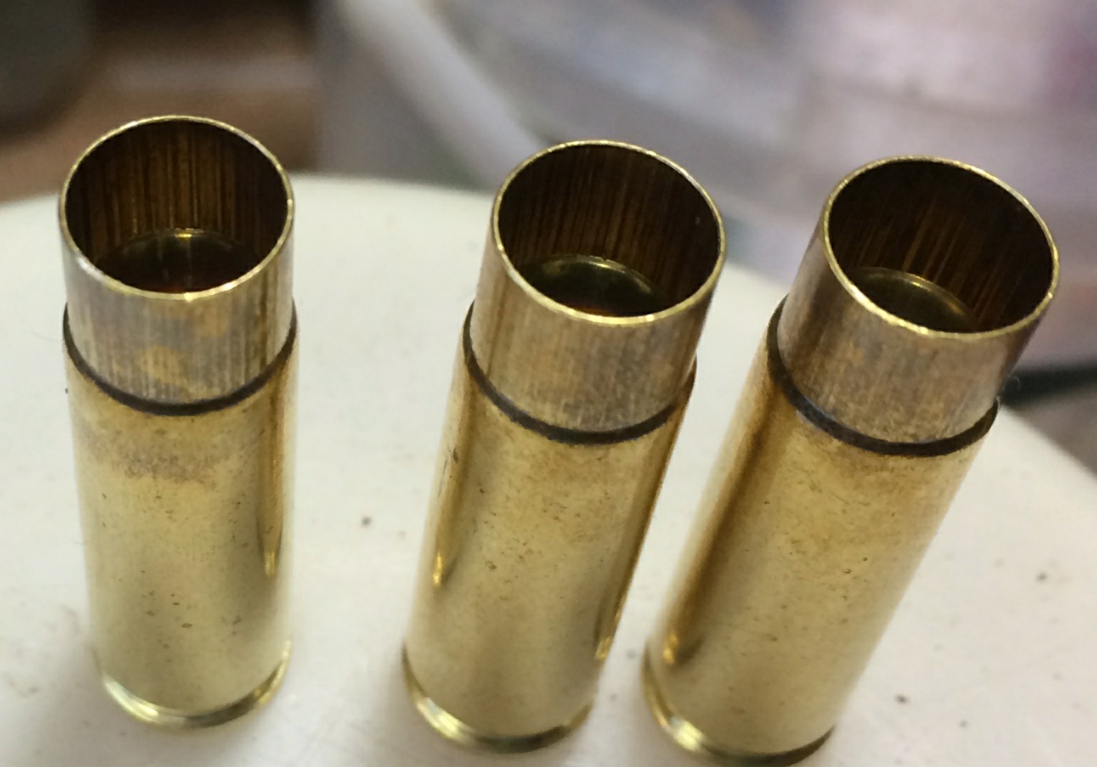

Had exactly the same problem with my new 300AAC dies. sent a photo and email to manufacturer, got a new die in the mail, problem fixed. I posted it here last year.

Post by straightshooter » 06 Mar 2019, 7:09 am
Kelsey Cooter wrote:What do you blokes think of this? My lee 308 full length dies don't leave marks like this. I know I saw on here blokes talk about polishing their dies, do I need to do this? Or is this not a drama? Or do I need to invest in a higher quality dies?
First point. How do you know the so called scratches were caused by the die?
Have you examined cases under magnification before and after firing and before and after sizing.
Just how deep are the striations? Can you feel them when twisting the case under some sort of probe?
If they feel significant then you need to track down where is the machining artefact that has left the burr causing the striations?
If they don't feel significant then worry about something else.
I would be more worried by the burr on the mouth of the case to the left of the photo.

Post by Gamerancher » 06 Mar 2019, 7:48 am
As Marksman has said, polish the inside of the die. Also, clean your cases before sizing. Carbon is very abrasive and when left on case necks can scratch up your dies. Also, look after your brass if you intend reloading. It never ceases to amaze me the way some blokes treat their brass. Slamming the bolt back and chambering the next round as fast as they can....., why? It 'aint like someone's shooting back! The spent brass goes flying off into the dirt or onto the concrete, getting knocked around and filling up with sh!t, then they go home and size it before cleaning / tumbling. :unknown:
Even if you're out bush, develop a habit of catching your brass as you eject it. It doesn't take a lot of effort to do this, even if you get onto a mob of pigs or goats etc, you can do this. You wind up with a handfull of brass but that can be quickly chucked in a pocket as you reload or re-acquire another target. Works for me. :thumbsup:
Post by deanp100 » 06 Mar 2019, 3:11 pm
I reckon the marks look good. Sort of a nice contrast to the rest of the case. Looks is everything you know.

Post by madang55 » 06 Mar 2019, 6:18 pm
As you can see in the photo. New cases, fired cases, didn't matter. What was interesting was that the striations were very evenly spaced. Made me think that it was actually the neck of the die being ever-so-slightly under size. It wasn't scratching, there was no residue, i.e. no shavings left behind. The case was evenly reduced all the way round, then smoothed on the way out leaving corrugations not sharp edged scratches. I gave it a quick turn with some 0000 wool, even an investigatory probe with a couple of cotton buds.Nothing. Sent an email off, new die in the mail.
