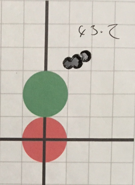

My go-to load is 123gr Lapua Scenars in the same brass with 43.2gr of 2209. But that's a target load that gets shot mostly out to 200m.

143 ELD-X left (Federal brass, dummy load), 123 Scenar right (loaded Lapua brass)

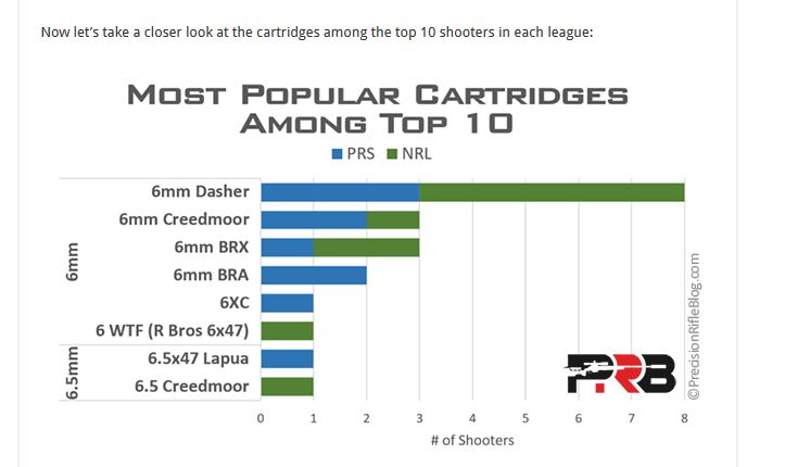

Well I guess apples to apples, the 6mm Creedmoor is getting up there in popularity in national comps, so it must be doing something right.
6mm dasher 2.JPG (40.14 KiB) Viewed 16474 times
6mm dasher.JPG (67.6 KiB) Viewed 16474 times
On the 6.5 side of things, you could argue the 6.5CM has the potential to be more accurate than 6.5x55, as it has a stiffer short action and tighter chamber tolerances than both the Swede and 260. In practice, I know there have been tests showing little difference, but it remains the 6.5CM is far and away more popular than the other 6.5 cartridges (excluding 6.5x47) when it comes to competition, so again, there must be a reason for it.
I agree on the Lapua brass - that's one of the reasons I went 6.5CM and not 6.5x55 - but you could add to that Hornady's match-grade factory ammo. It allows those who don't reload to get good accuracy out of their Creedmoor, and as far as I am aware, there are no similar offerings for 260 or Swede. (EDIT: Hornady offers 130gr match ammo for 260, but 6.5CM has a choice of 120, 140 and 147gr ELD-M; nothing for the Swede)
Originally I was going to buy a Swede, but the short action and ammo/brass availability swayed me to the Creed. But that was just me.

The statistics are for PRS shooters, it is a small sample and PRS is less about pure accuracy and heavily weighted towards the shooters ability. In pure accuracy competitions the Creedmoor is under represented. In a head to head shoot off with a competitor who knows what they are doing, you can get cleaned up by a 223.
