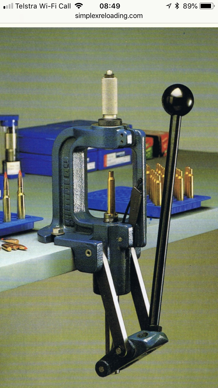

Re: Rerloading equip
Post by JimTom » 18 Apr 2019, 11:46 am
I just run one of these mate. Very simple as the name suggests.
