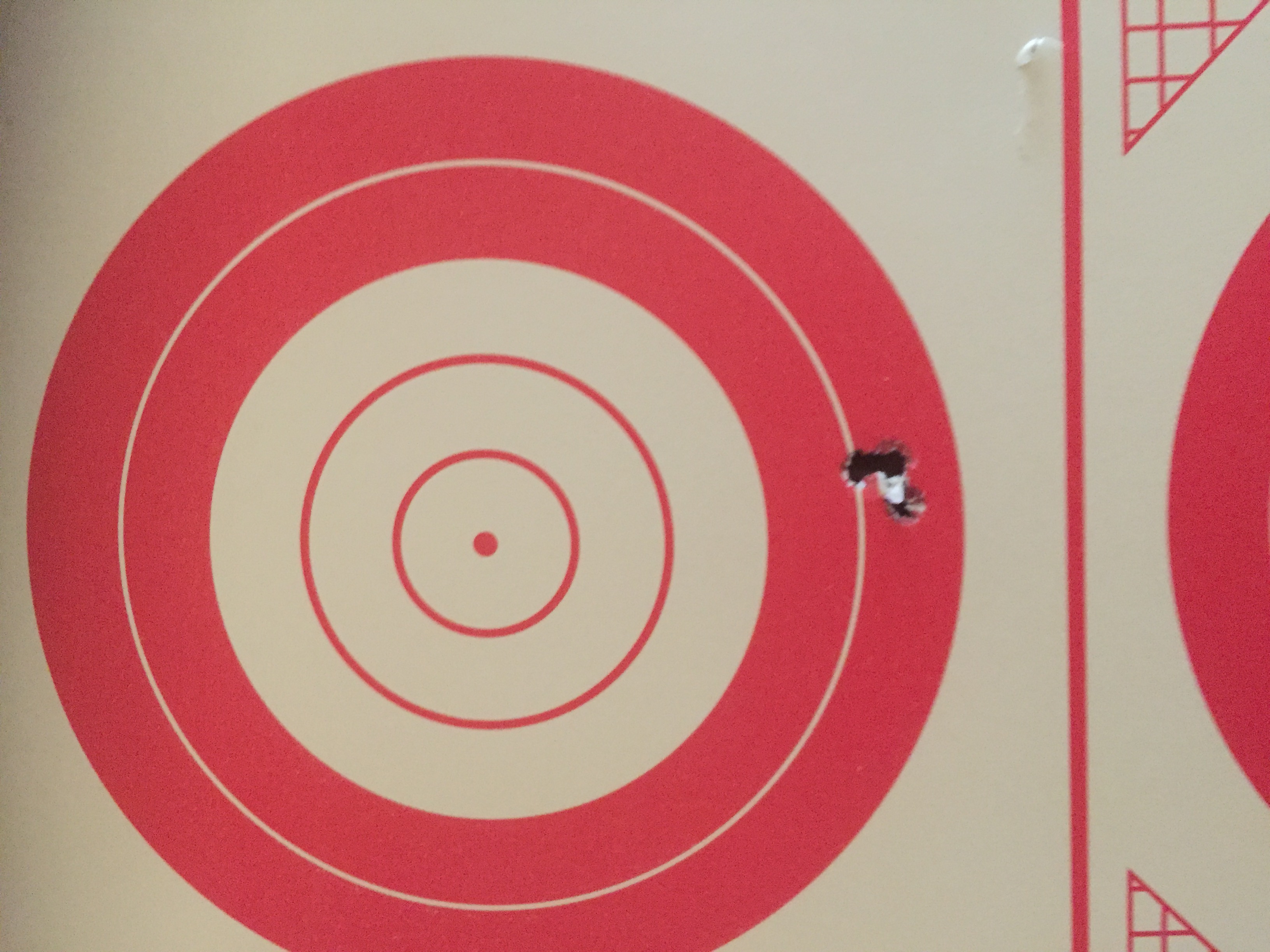

Here’s a group at 50 using the trail boss load with a 35gn vmax at approx 1550fps point of impact is a lot lower compared to my usual load

Post by Bill » 21 Apr 2019, 6:08 pm
now thats a nice bunny/fox load.....just dont make the distance too great

Post by bigrich » 21 Apr 2019, 8:30 pm
Bill wrote:now thats a nice bunny/fox load.....just dont make the distance too great
i'm experimenting with this load to try to acheive a extremely accurate "quiet" load for just that reason bill . might try it at 100 yards next to see how it goes . it doesn't get pushed around as much as 22lr by wind either. going to try 40 gn speer soft points i got sitting around too :thumbsup:

my crimped 12.5 gn loads shoot as well at 100 as the trail boss loads at 50 in the pic i posted. i actually keep my trim length as long as possible to get enough projectile in the neck of the case for neck tension , as well as crimping. keeping coal short seems to help with accuracy in my rifle as well .what projectiles are you using MM ? 40 h/point and 40 gn "hornet" s/point sierra's give best accuracy in my old krico .40 vmax shoot great but are too long for the magazine i love getting on forums to help others with tips MM, i've learned alot from surfing the net on forums as well . what goes around, comes around....... :thumbsup: all this talk about hornet rifles, i'm waiting for stix to drop in on this conversation :lol:
