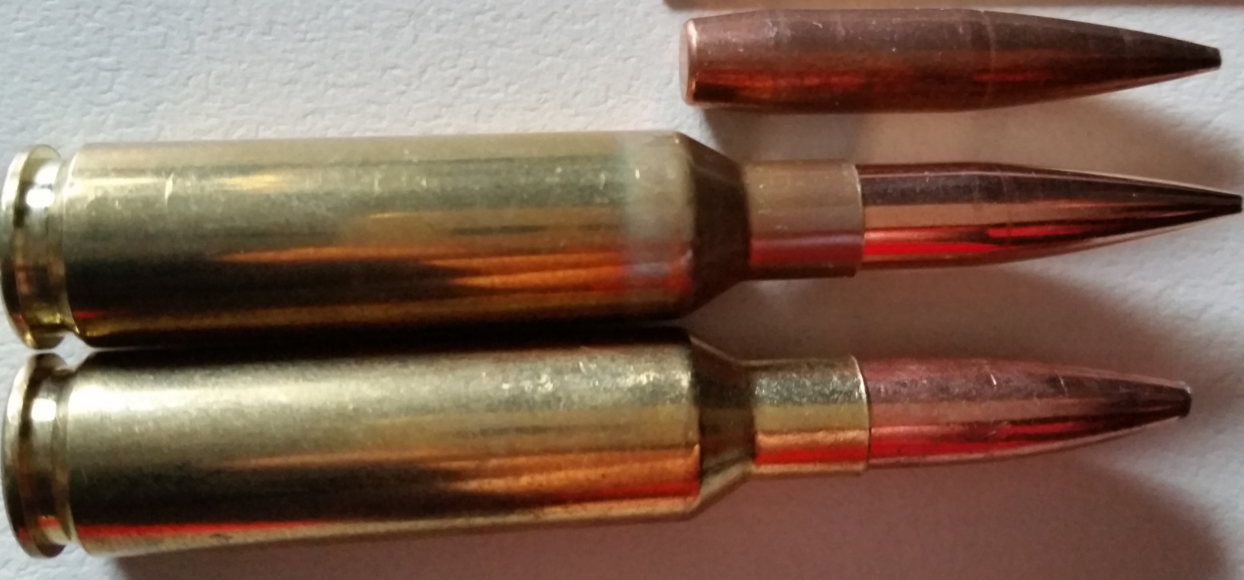

New to reloading so 1st batch. Have loaded 50, 6.5 Creedmoor 140gr ammo (Lapua cases, Berger VLD Target projectiles). Watched a video on youtube by the ‘6.5 Guys’, who are a couple of enthusiasts so not considered authoritative I guess. They indicated at the 43.48 (minute) mark that if loading/seating (to Saami specification length, but should that make a difference here?) ‘… make sure that the heel of the bullet is not going below the neck-shoulder junction …’. Now unless I have misinterpreted ‘heel’ to mean the bottom of the bullet/projectile, I have definitely exceeded this as they are seated near the bottom of the shoulder [shoulder-case junction] (see image, top cartridge is my reloaded round with the same Berger VLD Target projectile used above for indication of depth, bottom cartridge is a Federal 140gr Soft Point 6.5 Creedmoor factory round, unrelated but just for comparison of how much difference b/w case bottom to tip length differences there are for different projectiles). Are Saami specification bullets a lot shorter than Berger bullets, thus what the 6.5 Guys have indicated here is in fact correct?
So, do I have anything to worry about here? These bullets are seated to be 0.020 of the lands, 2.2510 inches ogive, thus their seating depth.
Top Cartridge is reloaded one, bottom is Federal Factory Cartridge

Post by bigfellascott » 18 May 2019, 7:49 pm
Looks alright to me. :unknown:

Post by TassieTiger » 18 May 2019, 7:58 pm
Does the bullet you have loaded, fit in your magazine ?
Have you test chambered the reloads ?
Sami specs are general size only ( my understand - the saami stipulated sizes will chamber and shoot in “any” rifle of the nominated chambering size, so have to be a lot shorter as a result) - you can load longer as long as your not jamming the projectile into the rifling when chambering.

Post by cirles » 18 May 2019, 8:03 pm
bigfellascott wrote:Looks alright to me. :unknown:
Hi bigfelascott,
That's what I was thinking as have double checked all measurements so a bit stumped at what the 6.5 guys are saying.

Post by cirles » 18 May 2019, 8:15 pm
TassieTiger wrote:Does the bullet you have loaded, fit in your magazine ?
Hi TassieTiger,
Had tried a bullet in my magazine & it apprears to JUST fit (around 2mm of the wall), though maybe that is not ideal when it comes to operating with a mag. That is not a problem for the moment though (if doesn't fit the magazine) as will single load if I have to for fly shoot etc, but will make up loads for the magazine at a latter time if I need to shoot at a more rapid pace.
Have test chambered a reload appears to be fine.
Main thing is what I have done here fine?
The NOT seating below the neck is puzzling to me, even for Saami spec bullets as suggested by these 6.5 guys

Post by TassieTiger » 18 May 2019, 8:28 pm
You haven’t done anything wrong that I can see - and 2mm clearance is fine in the mag. I’ve a 260 and load that so tip actually just drags with some BT’s.
Maybe I’m mis reading something but it sounds to me like they are saying not to seat the projectile deep below, into and passed the shoulder, which would result in a too short bullet, not too long.

Post by cirles » 18 May 2019, 8:41 pm
TassieTiger,
I don't know enough about reloading so can only speculate but they indicate the neck-shoulder junction (top of shoulder area) & not the shoulder-case junction (bottom shoulder area). My thoughts were perhaps they were thinking about reduced case capacity seating too low & therefore potential pressure issues with powder loadings. They did mention something about 'donut' issues related to this seating (neck thickness & concentricity issue?) but can't make out the connection, and as indicated know next to nothing about reloading.

Post by SCJ429 » 18 May 2019, 10:26 pm
When you seat deeply you make your case effectively smaller and raise pressures. When you seat longer you have more case capacity and potentially more speed. Of course many bullets perform better with less jump, the bullet is presented to the lands straighter. The best option is to have the bullet jammed, the bullet is supported by the lands, pressure is high and you have plenty of case to cram powder into.
Of course this all goes out the window if you have to load to a magizene lenght, then you have to choose a bullet with a ogive design that tolerates jump.

Post by TassieTiger » 18 May 2019, 10:32 pm
SC - can you not introduce pressure spikes via jamming into lands as well?

Post by SCJ429 » 18 May 2019, 10:41 pm
Yes you will raise pressures by jamming the bullet into the lands. This is not usually a dangerous spike in pressure unless you are on the ragged edge with a load where the bullet is jumped to some degree. Work up you load with a jammed bullet as you would as a matter of course.

Post by Oldbloke » 19 May 2019, 12:16 pm
You should know how far you are off the lands. Suggest you measure it. From what ive read, 40 thou to 15 thou seems to be the area. 20 thou works for me.

Post by marksman » 19 May 2019, 6:49 pm
the idea of what they are talking about is to miss the do-nut area in the neck and get the most out of your reloads,
more powder, more velocity less pressure
to be able to load like this you need a long throated chamber like you have, if you have do-nuts either remove the do-nut or throw the case
just understand that every rifle is a rule unto itself, you shouldn't be looking at what some other guy said/did, do it yourself
my advise firstly is to forget sammi, if you want sammi buy factory loads
secondly that length you are using is ok but only just, when the throat increases in length I would advise to load to the base of the neck for less runout
you should IMHO have your bullet seated at least a caliber into the neck
it may be beneficial if you read the article on the effects of cartridge over all length COAL by Brian Litz
https://bergerbullets.com/effects-of-ca ... to-part-1/
https://bergerbullets.com/effects-of-ca ... to-part-2/
I shoot the 140gr bergers in my 6.5x284 and can confirm that they are a brilliant bullet :drinks:

Hi marksman,
Can you please explain more about ‘…secondly that length you are using is ok but only just, when the throat increases in length I would advise to load to the base of the neck for less runout’ - I do not quite understand what you mean. Did you mean ‘re seat’ longer/deeper in depth (thus the ‘less runout’ [bullet centralized] reference) when you said ‘load’, or did you mean load up powder to the base of the neck?
My bullet is seated (not including the boat tail area, just the bearing surface) approx. 2 ½ to 3mm from the bottom of the neck (neck-shoulder junction), the cartridge width (.264) is just 1 mm above the bottom of the neck, therefore I am about 1 ½ to 2 mm shallow for what you recommend as a minimum (have read about that rule of thumb before). Was it from eyeing the image that you indicated ‘… secondly that length you are using is ok, but only just,…’ ?
I believe I understand the 'donut' thing now, shoulder cartridge material gets pushed into the neck area causing a thickening of the area that can have detrimental effects on bullet seating tension consistency & potentially cause dangerous pressure spike problems. Would you then not feel this when seating a bullet (feels considerably harder to press), unless of course they were all affected by it :o. Is there an easy way to see this on a case?

Post by marksman » 20 May 2019, 9:11 am
I will try and explain
"that length you are using is ok but only just"
the bullet is already not seated 1 caliber into the neck,checked by measuring off the puter screen, :thumbsup: the way you have it seated is ok if you are touching the lands but if you are jumping your bullet should always be at least 1 caliber length into the neck for better runout [bullet centralized]
"when the throat increases in length I would advise to load to the base of the neck for less runout "
as you shoot more rounds through the barrel the throat will wear moving the throat forward giving you a bigger jump to the lands, IMO it would not be a good idea to seat your bullet further out of the neck trying to keep a say 20 thou jump so you will be getting way less than a caliber of the bullet seated in the case, you will IMO be better off getting a sweet spot for powder volume with the bullet seated just after the do-nut area in the neck and dealing with jump
"shoulder cartridge material gets pushed into the neck area causing a thickening of the area that can have detrimental effects on bullet seating tension consistency & potentially cause dangerous pressure spike problems. Would you then not feel this when seating a bullet (feels considerably harder to press),"
spot on :thumbsup: , yes you can feel the bump at the base of the neck and with a do-nut you will get high pressure spikes
you can also check for do-nuts by inserting a projectile into the neck of a fired case, if there is a do-nut present the bullet will stop at the neck base junction or be harder to push through that area when your bullet gets there :drinks:
I have a few custom chambers, my 6.5x284 being one of them, I get the reamer made to suit the bullet (chamber leade) at an OAL I want, it's the only way I know of to have the chamber made for what you want, when dealing with someone else's design you have to adapt to what they did with what will work
I think you already have your head around this :drinks:
here is a photo of the OAL sizes of my 6.5x284 with different bullets seated at the neck base junction, this is also where my bullets touch the lands

Seating depth = 3.430 Desired “jump” to lands= .015 Load cartridges to an OAL of 3.415

Post by cirles » 20 May 2019, 12:59 pm
Hi Oldbloke,
Thanks for the very detailed methods explained here for finding Lands measurements, if other newbies follow this thread this is really useful information for a method they should consider.
I did find the measurements needed via using the Hornady OAL gauge. Had real issues in the beginning using this as was getting inconsistent measurements way larger than what I should have. Once I figured out what the cause was (holding the tube against the shoulder of the chamber but inadvertently slightly lifting this when trying to keep the tension there) I was getting consistent measurements within range of what I should have. Big relief that as I thought a person who reckons you can get measurement consistency to 1/2 a thousandths of an inch was exaggerating, but now think that is definitely possible.

Post by cirles » 20 May 2019, 5:28 pm
marksman wrote:this is very informative
http://www.youtube.com/watch?v=TWmIwPwLyyg
I wonder how light the seating tension is for this (0.020, 0.010 - Less, more)?
Would sizing the case via normal dies make it thin enough for the bolt to just drop as he showed?
Having to remove the ejector from the bolt, is that difficult?

Post by TassieTiger » 23 May 2019, 7:07 pm
I’m not what id call experienced in reloading by any stretch but an old friend of mine who worked in the forces as a sniper is...and I agree with OB here.
When I started, the very basics of reloading were easy...then as I started getting results, I wanted to get better - so I bought a comparator, an OAL, etc and instead of getting better, I opened too many conflicting doors... I started to get completely lost as I moved further away from the basics - so much so, I asked my friend to step in and show me where I had screwed up.
He does NOT suffer fools lightly - so I set up my 06 on a bench, had the dies, cases, OAL gauge, comparator, etc etc all laid out for when he came over...
He walked in - picked up everything except the rifle - placed it all in a draw and said “do not open this for 2 effing years. “
He loaded a dummy bullet a little long on purpose and test chambered it - he then lowered the seating depth .005 each time, continuing to test chamber each time, until the bolt eventually closed without unusual resistance (he handed to me each time to feel the close force)....in the end - he handed me the bullet and said “here - in the field, this bullet will be with in 1-2mm’s of anything anyone can produce by other technical measurements...” after testing a few, I cannot argue with him.
I’m back doing the basics for now. Lesson learned.

Post by Oldbloke » 23 May 2019, 8:26 pm
TassieTiger wrote: he handed me the bullet and said “here - in the field, this bullet will be with in 1-2mm’s of anything anyone can produce by other technical measurements...” after testing a few, I cannot argue with him.
More like within 5 thou of an inch. Good enough, for sure.
