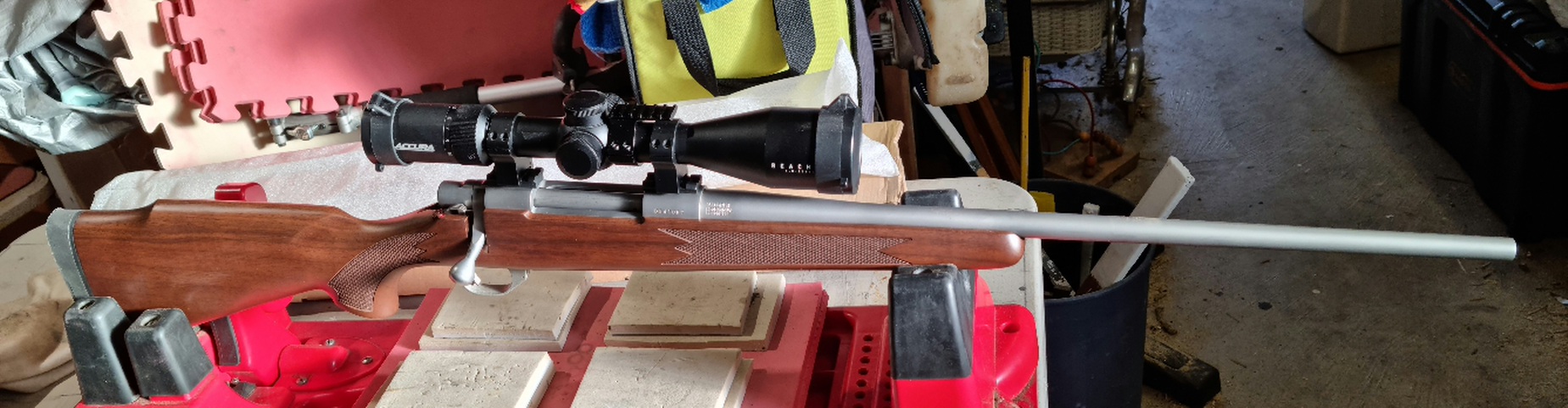

Been a while since the last reloading comments here. Have any of you guys used the 87gr Bertrams? Whats the go to powder for all projectile weights on the 25-06? I recently picked up a Howa with a Hogue rubber stock and replaced it with a Walnut. I think will do much better now.
I replaced the rubber stock with a Walnut
thanks

Re: .25-06 hunting loads with 117-120 gr projectile
Post by No1Mk3 » 30 Aug 2023, 9:11 pm
I use 2217, currently Hornady 117g A-Max
