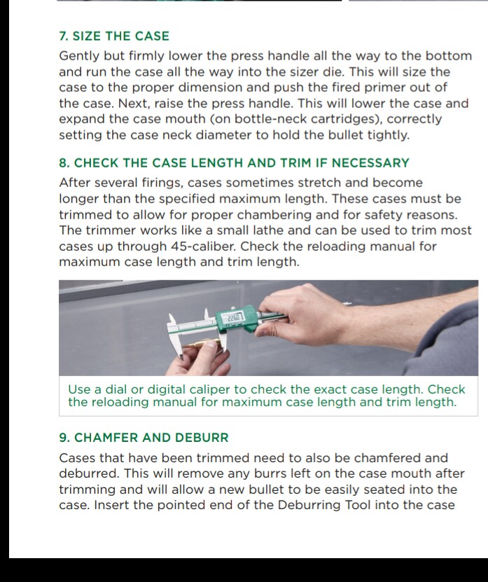

Post by Oldbloke » 20 Aug 2019, 8:12 am
From RCBS.
