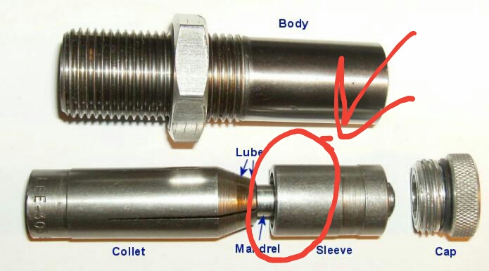

I finally got around to getting my 22-250 collet die all sorted & happening...
But...couldnt pull it apart... :unknown:
Ended up having to punch the insert out... :crazy:
Turns out, the insert is so dam tight it wont go back in either--well, not without a good bit of persuasion with a hammer & punch of some sort... :wtf:
Is this normal...?
All clips on the choob show the internals just fall out...but the one ive got is too bloody tight to get in & out without extreme force...FFS...!!! :unknown: :evil:
Anyone have any ideas... :unknown:
Guess im not shooting tomorrow ffs...!!!
Why the fuk is everything i buy these days a fukn peice of sh1t... :evil: :evil: :evil:

Good point, I've seen a similar problem with motorcycle fork legs that have been locked in a vice to loosen the fork caps.
Posts: 14002
Re: Lee Collet Die Problem
Post by Stix » 12 Oct 2019, 1:52 pm
Ok...it was new...
Ive sized one batch with it, using Lee's instructions...which are clearly wrong--or so badly written they give a totally wrong interpretation for correct use.
Hasnt been bent out of round in a vice...
Body is visually round...
Cap is easy to thread in or out...which confirms body is round...
I wonder if its made of a different material-possibly softer...(the insert)
I also wonder if excessive pressure on the press has compressed the insert causing the bottom section to flare out radially, making it a squillion'th larger diameter than the inside of the thread... :unknown:
Unfortunately its too big for the chuck in a drill, & i dont have a lathe--or i could 'sand' down this section with some wet-n-dry...
The bloody collet is surface rusted too... :unknown: ...bloody hell...
This is the section that is too large & binds on the thread...
2019-10-12 12.53.47.jpg (136.6 KiB) Viewed 7503 times
Its in the die & appears to be working for now...but ill have to get it sorted so i can lube the bits...

Which bit is sticking the top outer part or the mandrel down the centre in that top outer part. I have on one or two occasions just given the bottom part that does the squeezing a very light wet and dry on the inside of the hole and down the slits. Using like 1000 wet and dry.
Be careful if you do any polishing of the mandrel very easy to take off a few thou which will result in too much sizing and neck tension.
Post by Stix » 12 Oct 2019, 7:58 pm
sungazer wrote:Which bit is sticking the top outer part or the mandrel down the centre in that top outer part. I have on one or two occasions just given the bottom part that does the squeezing a very light wet and dry on the inside of the hole and down the slits. Using like 1000 wet and dry.
The outside of the insert..as ive pictured and (badly) circled, is too wide to come out past the thread for the cap...
The mandrel slides in & out easily...
The insert has play while inside the body--its just getting it out that is the problem...
Ive punched it in & out twice now, & appear to have done no damage to the thread as the cap still screws in & out quite easily with no notable binding...
Ill have to punch it out again & lube the collet though...
Thanks for the warning on the mandrel sungazer- :) :thumbsup: -ive never done that before & wondered how quick & easy it is to remove too much.
For now, ive no choice but to use it as is...but ill order another mandrel & when i get it, ill polish this one with some lapping compound or autosol/JB abrasive...
Edit---its only the area circled, up to the slight 'indent' on the sleeve, that is binding on the thread...the upper section of it--where it increases in diameter again, slips past the thread without binding---so if i put it in upside down, it goes in fine until that lower section reaches the thread...
(Ive tried to explain that as best i can...)

Post by sungazer » 12 Oct 2019, 8:46 pm
Sounds like you've got a bit of a strange one. All mine drop in and out without any problems. Only issue I have had and it was more to be picky was to give the fingers a little polish. Sounds like yours is still operational and not going to cause loading problems. You do want that mandrel to have a little play so it is all making concentric ammo.

Yes the mandrel & insert both have a little play independant of each other...
Cant find the bloomin receipt...dam...
Ill ask the store if i can get a replacement die cos its obviously not right...& they will remember me getting it so will hopefully find copy of sale on their POS system...
Post by marksman » 20 Oct 2019, 7:04 pm
Marksman--does this go for pushing one in by hand as well as pulling one out....?...(I can set the die such that there is enough to push one in, but not pull one out, or turned a fraction more into the press & cant either push or pull one in or out)...
yes this does go for pushing one in by hand as well as pulling one out
this is usually done before I start testing loads and what I am trying to do is make everything exactly the same so I have a scribe mark on the die and press so it is repeatable the next time, this is a part of my setting things up so it can be repeatable and consistent from the get go, being micro (anal or ocd) :lol:
TBH l usually find that when a good load is found anything I try after detunes the load, your proven load needs less powder because having more neck tension gives higher pressure, as l have stated plenty of times I like a smooth entry and release when reloading for precision so l always try for less neck tension even if l am using a light crimp to get a more even start pressure because I am jumping the bullet
Post by Apollo » 20 Oct 2019, 7:35 pm
marksman wrote:the way I set up the collet dies is to only tighten the die down enough so that you cant pull the bullet when seated with your fingers
so start with a case being sized with the collet skirt only just touching the shell holder and adjust the die in till it grips the bullet and you cant move it with your fingers, I believe this is light neck tension, works for me :drinks:
So, what are you using these rounds for, target shooting.. ??
What happens when you push the loaded round against something like your reloading table, can you push the bullet into the case by hand..??
The reason I ask is that I have a target rifle (6.5x47 Lapua) which is very accurate but it's also a very tight neck chamber, .286 compared to say a "No Turn" neck of .294/5 so with 0.010" neck walls it has very little grip on the bullet. So much so that if rounds are loaded long the simple task of closing the bolt pushes the bullet back into the case so the bullet cannot be jammed into the bore. That's where it's most accurate rather than any jump to the lands. The problem I found is that in transport, rounds sitting up in cartridge boxes they can vibrate enough to cause the bullets to be shorter than ideal. Solution I used was to seat everything long and final seating before a competition shoot.
I would never load rounds for hunting/varminting like this as in my view they will change over time being transported so you will end up with rounds where the bullet seating varies. Now, using bushing dies I can increase the neck tension quite a bit but I loose accuracy. It's still not a lot of tension given the neck walls are so thin.
Apollo
