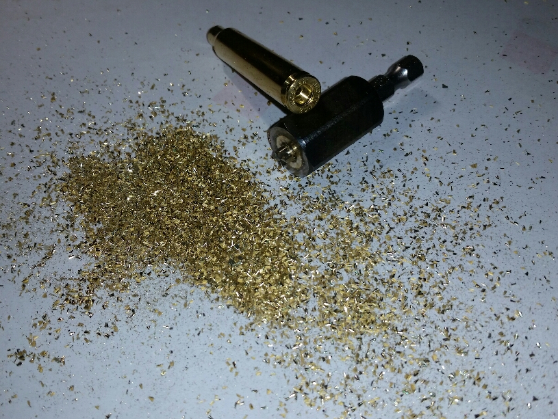

Post by Stix » 13 Nov 2019, 11:13 pm
Finally...
Two hundred n' fifty flash holes, & the same amount of primer pockets...all done...
Dear lord im glad thats done... :|
Here is some "trimmings"...

2019-11-13 23.39.12.jpg (548.42 KiB) Viewed 5081 times
Doubt i could work on a factory line...

Post by SCJ429 » 14 Nov 2019, 6:48 am
Wow, that is some brass there. How deep do the primer cups sit once they are seated?

So i dont know how far below--i guess they'll be the same as other ones, just a little below the head level--enough to feel...

Post by SCJ429 » 14 Nov 2019, 6:20 pm
Two to five thou is good. So just below flush.

Ok...ill have to measure when loaded to see what they are...
Id have thought they might be deeper than that as i can easily feel them being set deeper than flush...

Post by grumpy308 » 14 Nov 2019, 10:00 pm
Stix. There does appear to be quite an amount of removed brass on the bench. The pockets do look fairly deep and the flash hole quite large. Could you give some measurements on the finished pockets and flash hole diameter and a photo more square on to the head of the case. It may just be the angle of the photo that makes them look a bit deep. Regards Malcolm.

Post by Stix » 14 Nov 2019, 10:46 pm
Hey Grumpy...
There was a lot of cases there...poss up to 250...
But i was getting a good amount of brass out of some cases... :unknown:
They appear to be .120-.122 deep...only one out of about 10 measured .120...the rest .1215"-.1220"...(i only measured 10)...im not measuring all 250 of em... :crazy: :lol: )

I did at one stage have a printout of primer pocket depths on the bench but cant find it now...from memory ive checked it & they a=were ok then...
If theyre too deep theyre ruined...cos.they're all done now. :unknown: ..Unless they'll blow my face off, ill shoot em anyway...by the time ive spent on them theyre worth about $10 a bloody case...!!
Ive not altered the depth of the cutter, so all my 204 & 222 (400 in total) brass are cut to this & i havent had any blow back issues or stuffed cases...(where is the 'touch wood' emoji...?)
