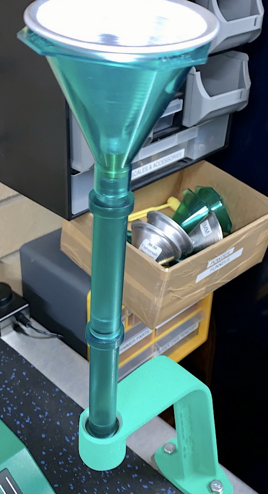

I too use a mild crimp. I load 13.2 grains of Lilgun with a 40 grain Vmax and “long” drop tube. The little hornet can be a bit fiddly and I find I need an extra set of hands, so I use this setup just for the Hornet. It works perfectly and consistently.
