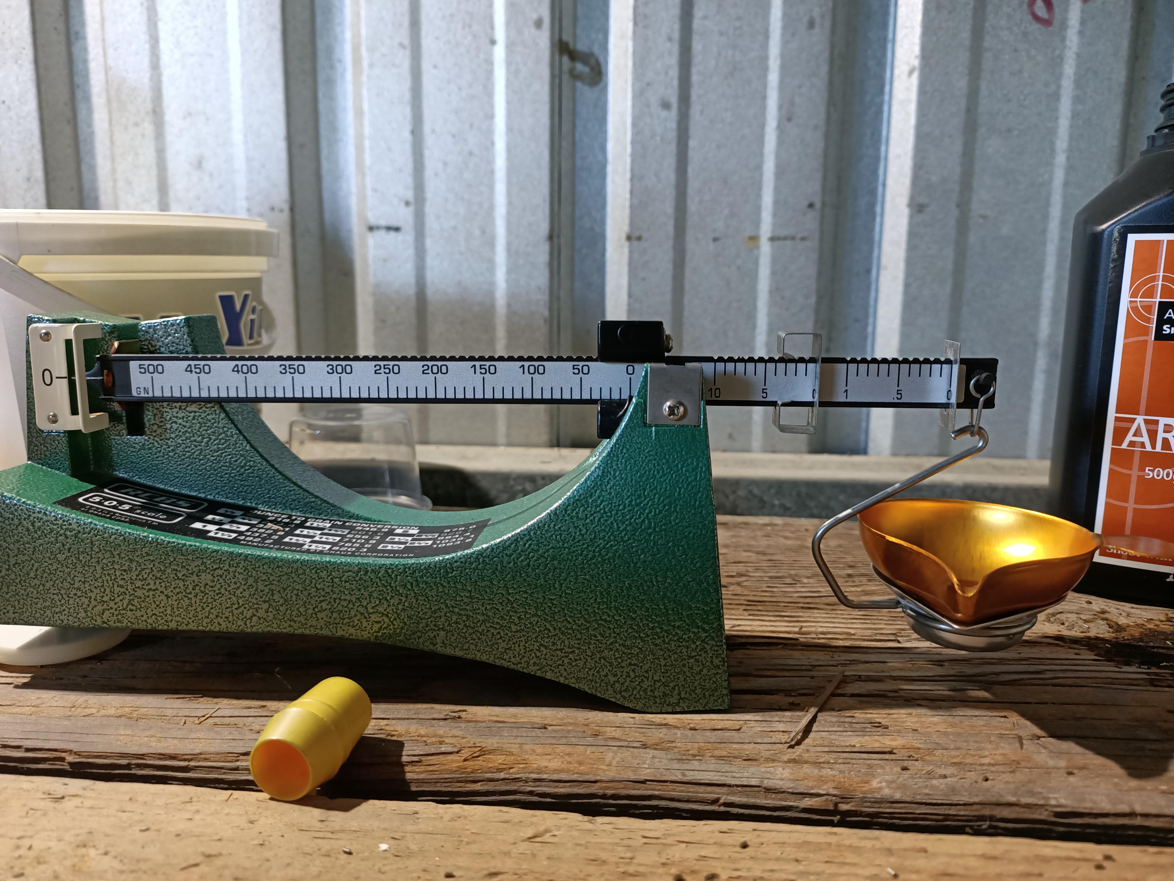

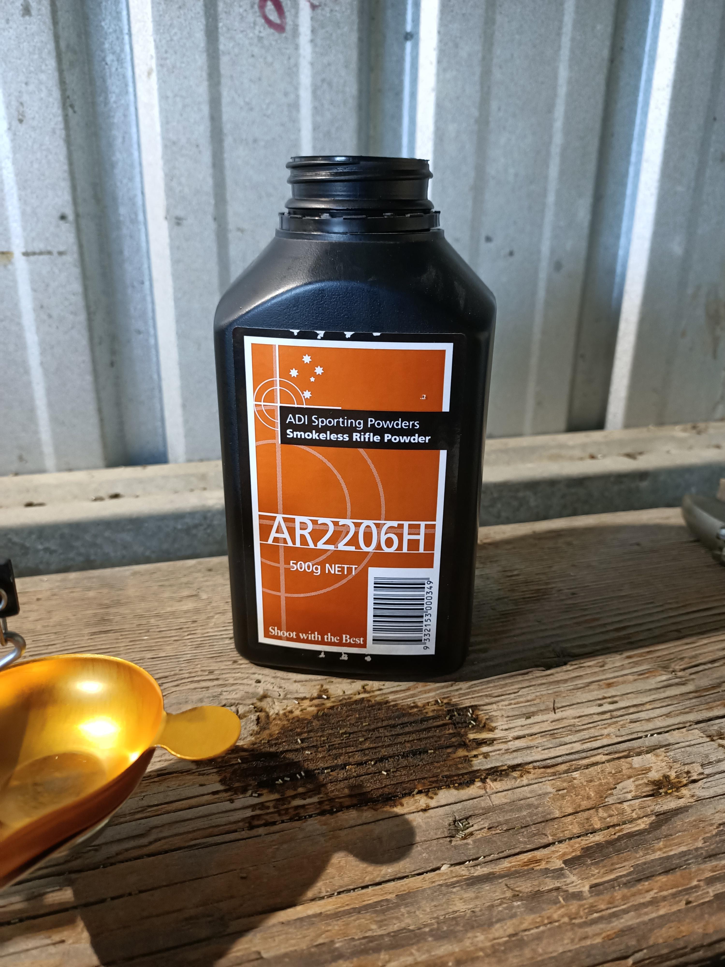

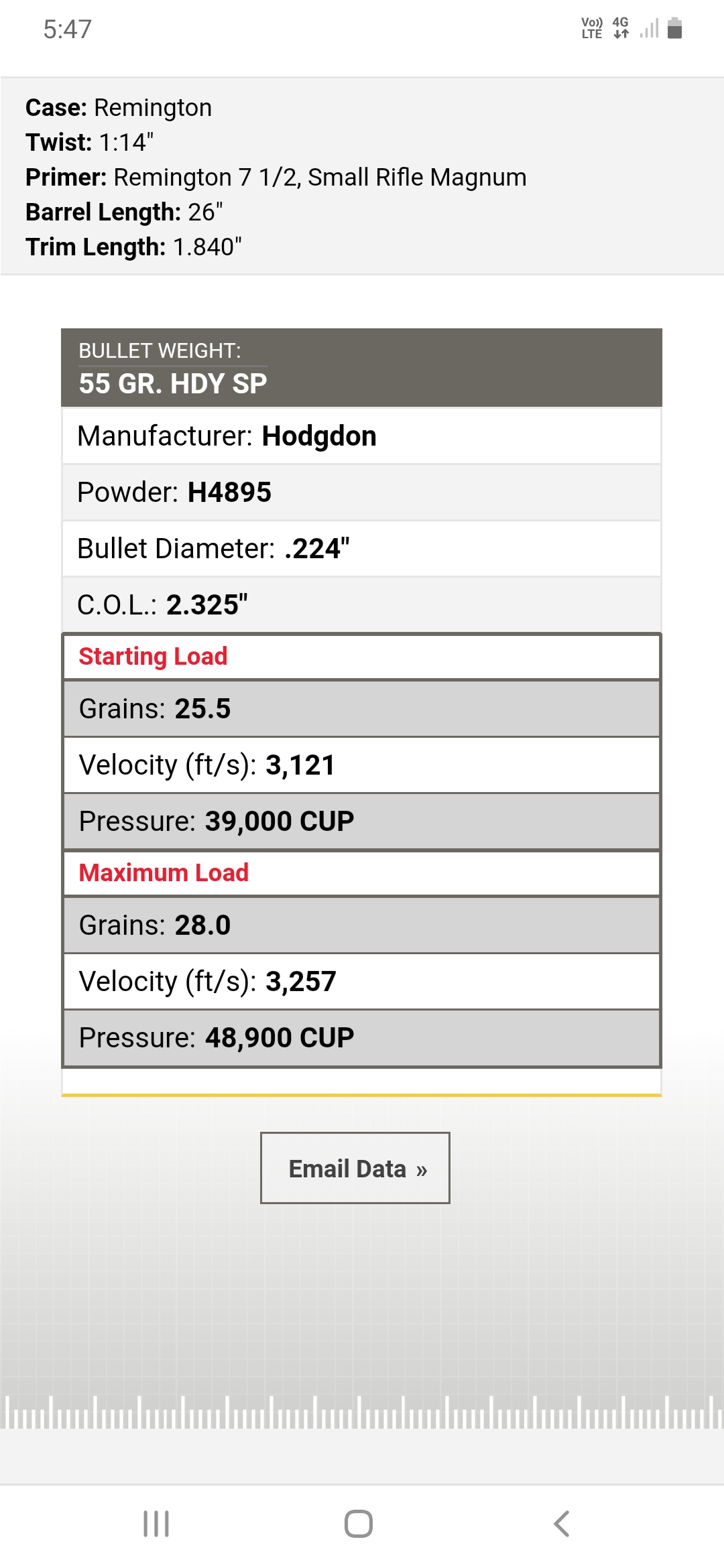

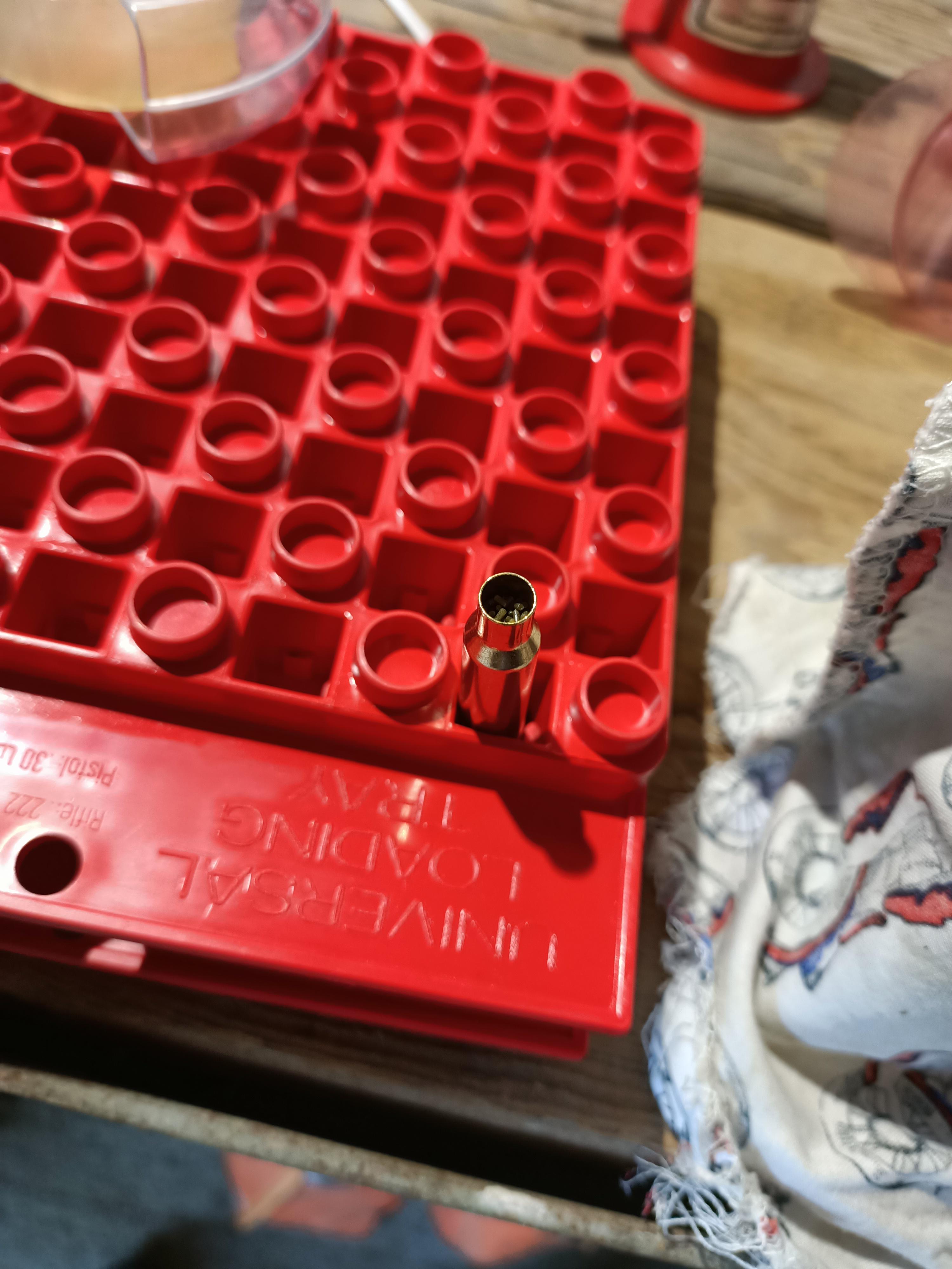

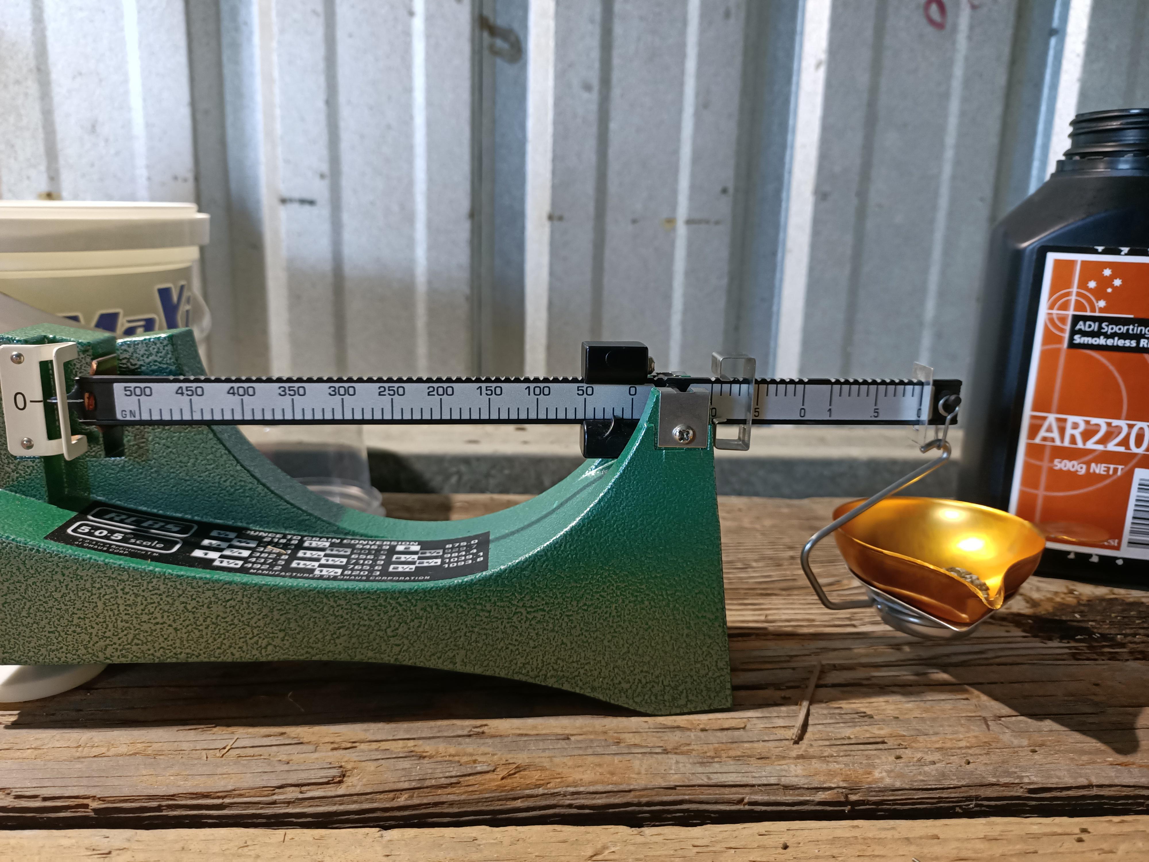

So I have a live update. Photographic evidence however my photos are way too large and I need to shrink them. Zeroed RCBS 505 scale. Checked bullets, on the dot. Tub of 2206H sitting in front of me. Brand new Sako stamped .222 rem mag brass. Checked against brand new Nosler stamped .222 rem mag brass. Perfect. 26 grains on the scale. From the pan through a powder funnel into the case. The powder filled to 3mm below the top of the case about halfway up the neck.

Post by Am88 » 02 Jan 2020, 5:46 pm

Be very careful using different reloading manual data. They are not gathered using the same circumstances, barrels, barrel length etc.
ADI and Hodgdon will allways be the same since ADI do not do any load testing at all. It's all done by Hodgdon in the USA.
So, ADI/Hodgdon, Nosler and Hornady all use different testing proceedures and would be all different for the same bullet and powder.
The only powder testing ADI do is for a new powder batch from a previous one to ensure it's withing a few percent of the same. Powder batches many batch numbers different can have a substantial variation from an old batch.
I can't see any Nosler data for H4895 currently for the .222R Magnum online. In an old reloading manual I can see IMR 4895 listed but it isn't anywhere near the same powder, different manufacturer.
I don't have access to a .222R Magnum case so I can't test anything even though I have powder scales that are very accurate and can measure the weight of one/two granules of powder.
ADI don't list 28gr of H4895 as a compressed load so something seems to be amiss somewhere.

If the manual said 28 grains and I can get that plus some in a 222 Mag case and a 204 case. You get the same results in two different brands of cases. I can only conclude that your scales are measuring 28.8 grains as 26 grains or you have placed the measure on the balance beam two grains past where you intended. Pop around to my place and we can check your scales.
Re: Differences in manuals .222mag
Post by Am88 » 02 Jan 2020, 7:41 pm
Just verifies scales with 4 different bullets and 3 different brands. 55gr VMAX, 87gr Speer hotcor, 135 Sierra HP and 165sst's. The sst's actually all came back .2 of a grain heavier. 5 of each bullet. I also posted a photo showing 26gr on the scales. Possibly the powder? Do you have something else to compare with a full case, I have 2207, 2209, 2208 and 2206h on hand. The tub of 2206h is the only run I have of it and only one I've ever bought.
