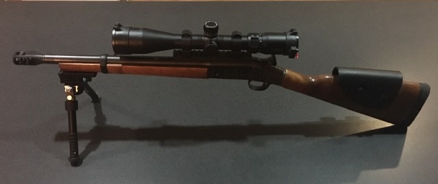

My pet load is a .459 Spartan hard cast 500 FP over 31gr 2207. This load turns up 1,230fps in my GS (and my pet Project Wombat - a modified H&R Model 155 single shot) and is phenomenally accurate!

Project Wombat!
6 shots at 100yds with ‘Project Wombat’

Holy Cow that's accurate, Tank :o :thumbsup:
And it's got a barrel band too, which can be problematic, in my experience but not yours. Onya mate :thumbsup:

Thanks for that, love your Wombat too, that things looks beast!

The barrel band is ornamental....it’s plastic and is held in place with a grub screw. But I hear you!
It far surpassed my wildest imaginings for accuracy though!
