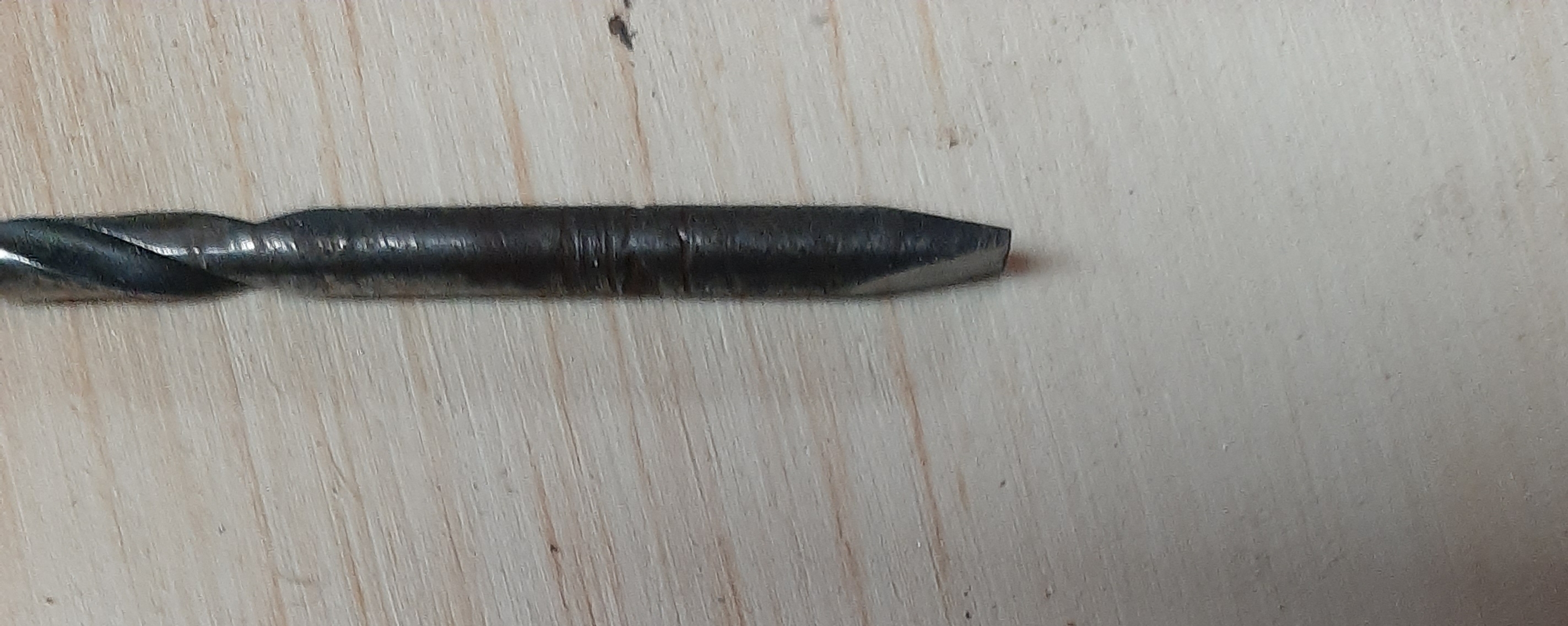

DIY Primer pocket cleaner. Drill ground into a screw driver like shape

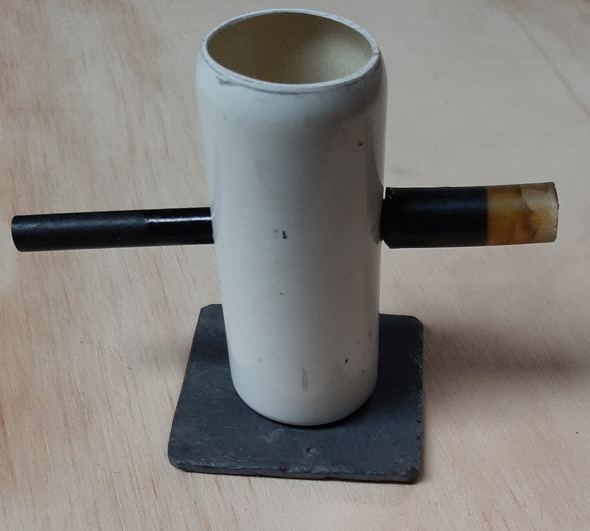

DIY Trickler. Just a pill bottle and a piece of hollow glass fishing rod. Lead sheeting to act as a base.

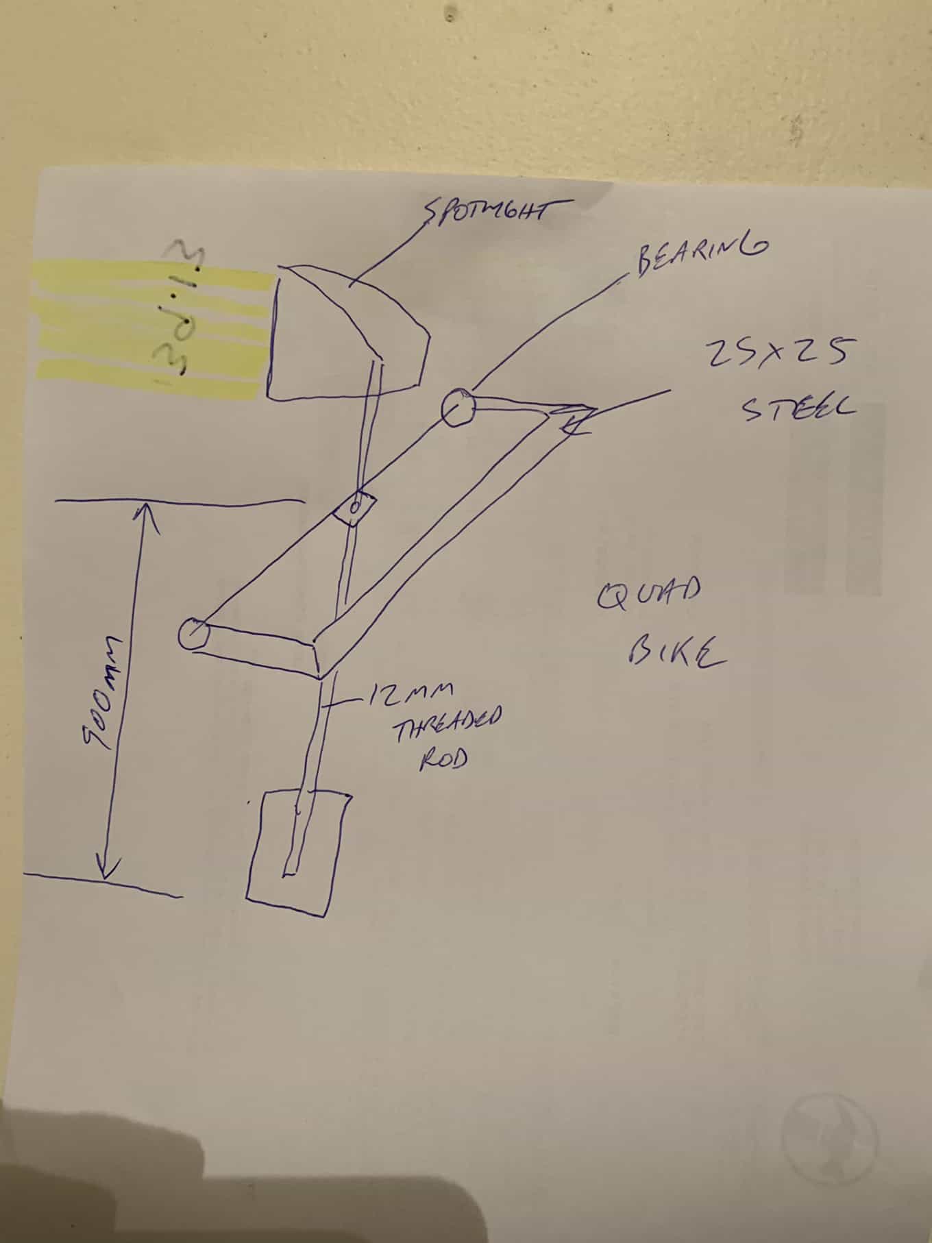

It’s a workshop drawing of a bracket I made up for roo shooting off my quad the 25 box steel attaches to the roof rack on my left hand side of the quad The big lead weight at the bottom acts like a pendulum ensuring that the light always points perfectly horizontal reagardless of the camber of the dirt track I’m on. I can swivel the light left or right manually if I need to but the idea was that while operating the quad putting along at night the light is always in the paddock instead of falling up or down Then when a roo is seen I just stop and adjust left or right and I can let go of the light without having to lock it’s position A faster system is what I wanted so this is what I came up with. But I just loved the idea that I could have better control of the bike and alternate between paddock scanning with my eyes and keeping an eye on the track in front ..... whenever I took my eyes of the track in front I could instantly see that my hunting spotlight was on track already in the right spot ready to pick up Roos .... but I think I only used it for one night then I got thermal gear and threw tthis unit away when having a back yard clean up

What a great idea Blr243. A real KISS idea.
Necessity is the mother of Invention.
What does it swivel on? Ball joint?
Posts: 13398
Re: DIY Reloading tools
Post by Blr243 » 05 Apr 2020, 11:19 pm
The vertical pole is 12 mm threaded rod It penetrates a 12 mm nut which is directly welded to a horizontal 12 mm threaded rod At both ends of the horizontal 12 mm rod is a bearing in some sort of houseing that I can’t remember Nothing beats a human assistant on the light but I’m too cranky and set it my ways to invite anyone along ......I think I might allow someone one day if they were good at getting out to open gates , able to keep their mouth shut , sit in the corner and not be allowed to touch a rifle ( but that’s no fun for them )

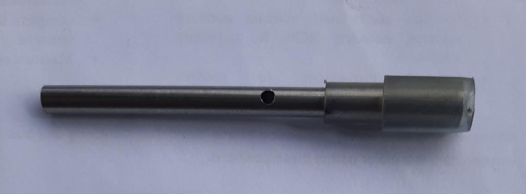

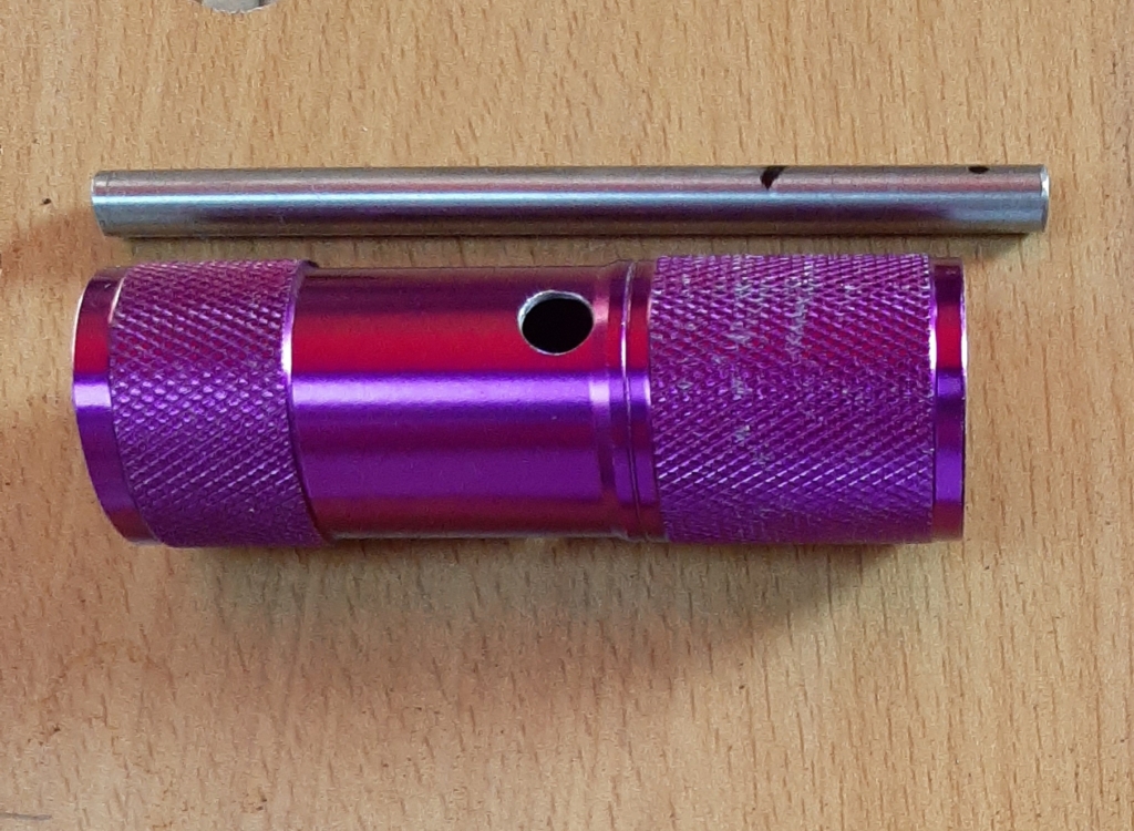

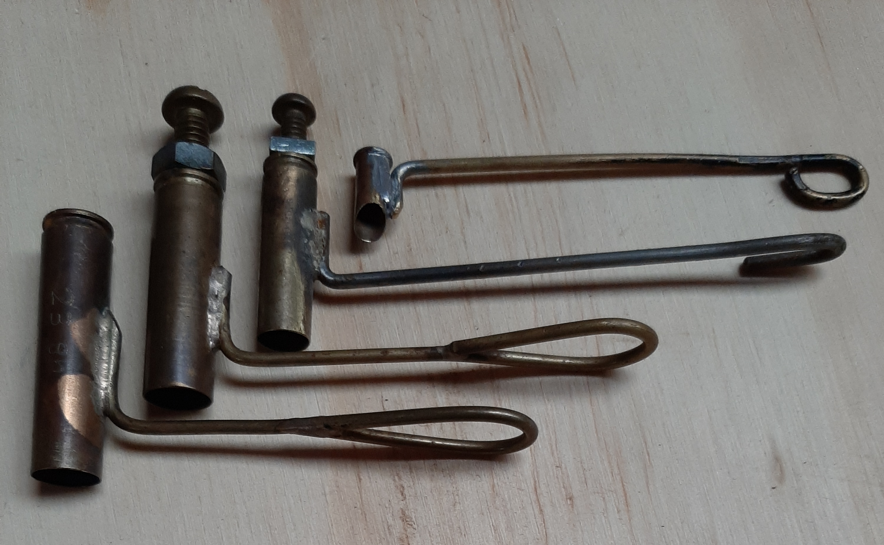

I decided today I would make a new trickler. As it happened a couple of days ago I found an old broken car radio arial in the shopping car park. Just what I needed as I already had the other half of the project put aside, an old LED torch. The ones you often see in a cheapy shop. I already have a DIY trickler but for some time felt I would like to up grade.. (see above plastic version)
1. First I removed the guts of the torch and cut the piece of SS arial to approx length. Removed all burrs later once I had the correct length just right.
2. Drilled 2 holes in the torch same size as the diameter of the arial. In this case 6.5 mm. One hole about 1 mm lower than the other giving the tube a slight incline.
3. I then mixed up about 40 grams of No 5 shot with 2 part appoxy and poured it into the base of the torch body & allowed it to set. This serves to give the trickler additional stability when in use.
4. I then drilled the arial (3mm) and added some plastic tube to create a small knob. Job done & works a treat.

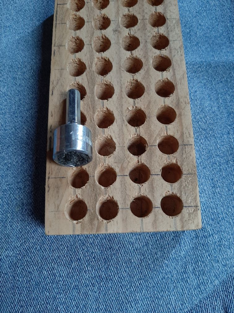

A couple of very simple ones.
A DIY reloading block and a socket filled with steel wool. Run in a drill does a good job of polishing the case mouth.

Post by Blr243 » 16 Apr 2020, 12:47 pm
It was just a hid. White light , standard run of the mill shoot some Aussie Roos with a spotlight sort of light ... some ran away some didn’t I rigged up my rifle pointing fwd on the quad and loaded with the bolt handle lifted. Ready to go. I know I only had seconds before they got nervous and hopped off so I figured I have not got time to lift and swing the rifle around. My aim was always too shoot them before they had time to think about if they were hanging around or not .
Posts: 4779
Post by Blr243 » 16 Apr 2020, 12:52 pm
I had a massive car battery on the front of the quad. It was linked to the main original quadbike battery. During daylight hours I would disconnect them and trickle charge the big battery. It was the only way I could punch out a bright light for 6 plus hours spotlighting without getting stranded flat battery in the back blocks

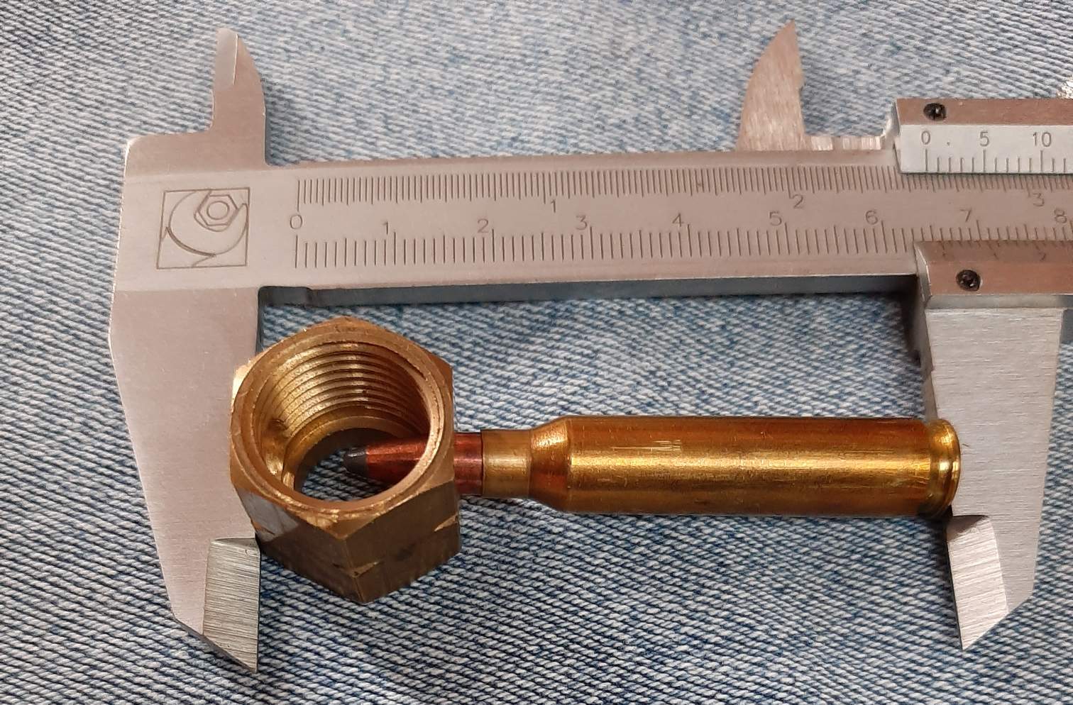

One thing I have made is comparitor gauges similar to the Hornady Gauges used to measure shoulder set back. I made some for that purpose and also to measure on the ogive of bullets or at least at a point as close to my barrels dimensions as possible. In the future I will use the bits of new barrels that get cut off when they are replaced.

So I remembered today I made a Bullet Comparator about 2 years ago to measure off the ogive. It works OK. More consistant than measuring off the lead tip. Just a brass nut with 2 holes drilled one for 308 and the other 224 cal. They may not be precisely on the ogive but since the measurement is only reletive I dont think it matters.
I dont recall the drill sizes but after drilling I cleaned up the burrs with some very fine wet and dry paper.

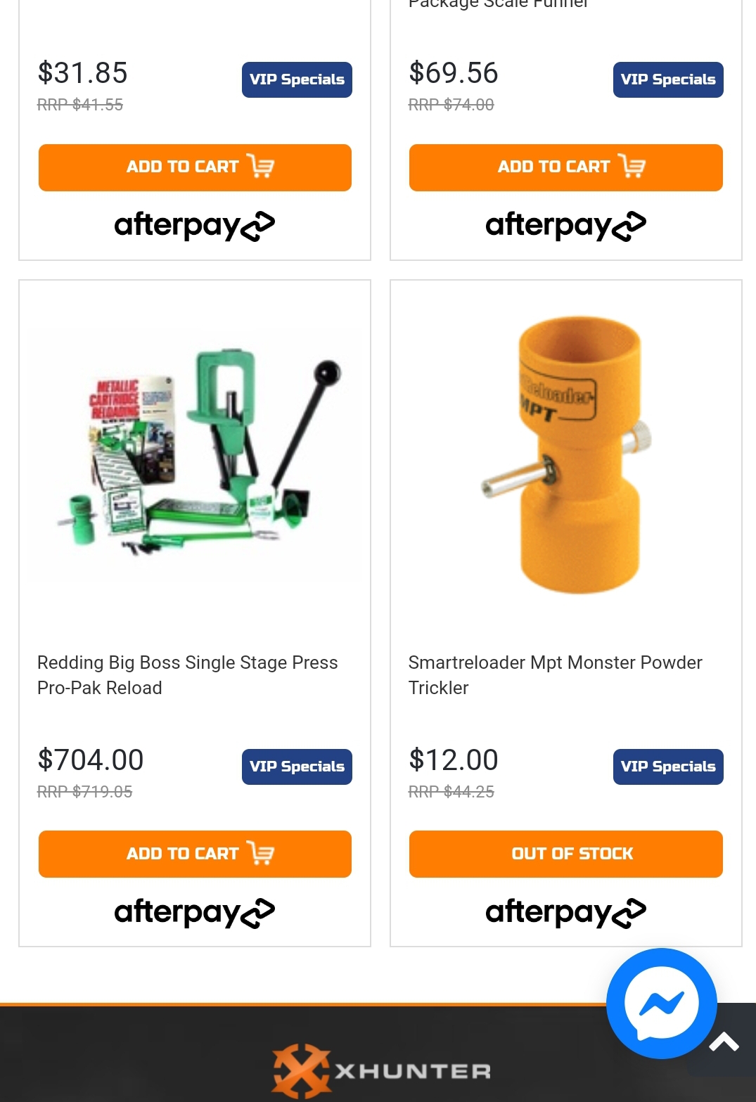

I spotted these. At Xhunter. Pretty cheap. Made in China I guess.
