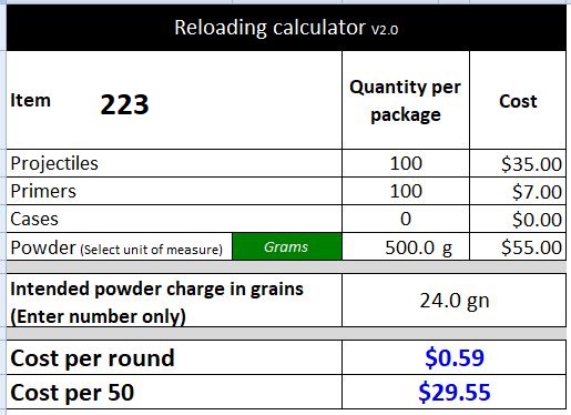

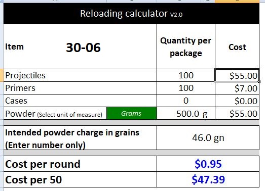

To give beginners an idea of current reloading costs I ran some calcs in an xls sheet I have. NOTE: The costs I punched in were from memory and obviously if you bulk buy you can do better. But should serve as a guide.
223 Sample.JPG (68.33 KiB) Viewed 10376 times
30-06 Example.JPG (68.36 KiB) Viewed 10376 times
