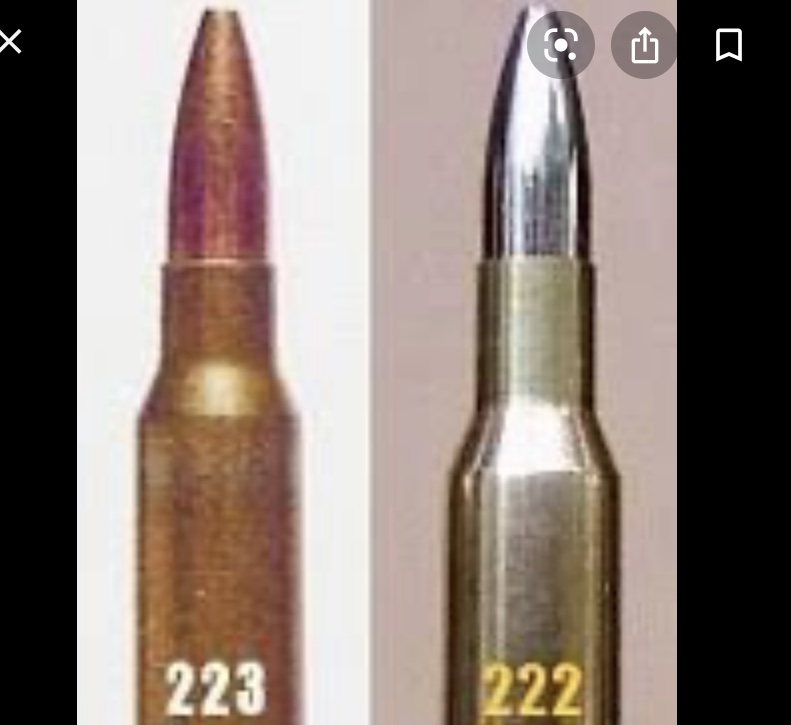

Am I wrong? 222 case fired in a 223 chamber. Case would just expand to fit the chamber? Would it not?
Well under the 25.3 max for 223. Id have thouvht it would be ok. Perhaps someone with more experience can comment.
Re: Overloading the Powder
Post by TassieTiger » 15 May 2020, 11:05 pm
I would have thought the 222 case wouldn’t be able to fill the 223 chamber without giving way...thus the back blast. If you look side by side at cases, that’s a lot of shoulder to fill...it’s going to get thin in areas...
Post by Oldbloke » 15 May 2020, 11:11 pm
TassieTiger wrote:I would have thought the 222 case wouldn’t be able to fill the 223 chamber without giving way...thus the back blast. If you look side by side at cases, that’s a lot of shoulder to fill...it’s going to get thin in areas...
Thats why in one of my earlier posts i asked if the case split near the shoulder. But that isnt the case
On second thoughts, perhaps the charge was slightly compressed rapidly increasing pressure. Just a guess. That would be back to the original theory, an over charge.
Post by animalpest » 17 May 2020, 12:40 pm
The .222 case could not expand enough to fill a .223 chamber and still stay intact when using full power loads. I would think a case head separation would be inevitable.
Headspace would be extreme resulting in a blown up gun.
Post by marksman » 17 May 2020, 2:17 pm
animalpest wrote:The .222 case could not expand enough to fill a .223 chamber and still stay intact when using full power loads. I would think a case head separation would be inevitable.
Mike
after reading this thread that is what l thought myself :thumbsup:
"Headspace"
its just a bad accident and lucky the op is ok :drinks:
and could have the bolt repaired
thanks for posting it up :thumbsup:
Post by Oldbloke » 17 May 2020, 2:43 pm
Mike
Bloody he'll so obvious once pointed out. Doh.
Post by Oldbloke » 17 May 2020, 6:34 pm
Mmmm, no expert here. MM is probable more experience here.
For rimless cases the head space is the gap between the shoulder of case and shoulder in the chamber. If you look the 222 is a lot shorter than the 223. (At the shoulder)
For rimmed cases it is created at the rim.
Could easily be corrected here but when fire forming normally fairly light loads are used. Because of the head space.
Just guessing but if there is a lot of head space the case may not grip the chamber in the normal way increasing the pressure onto the bolt face.
