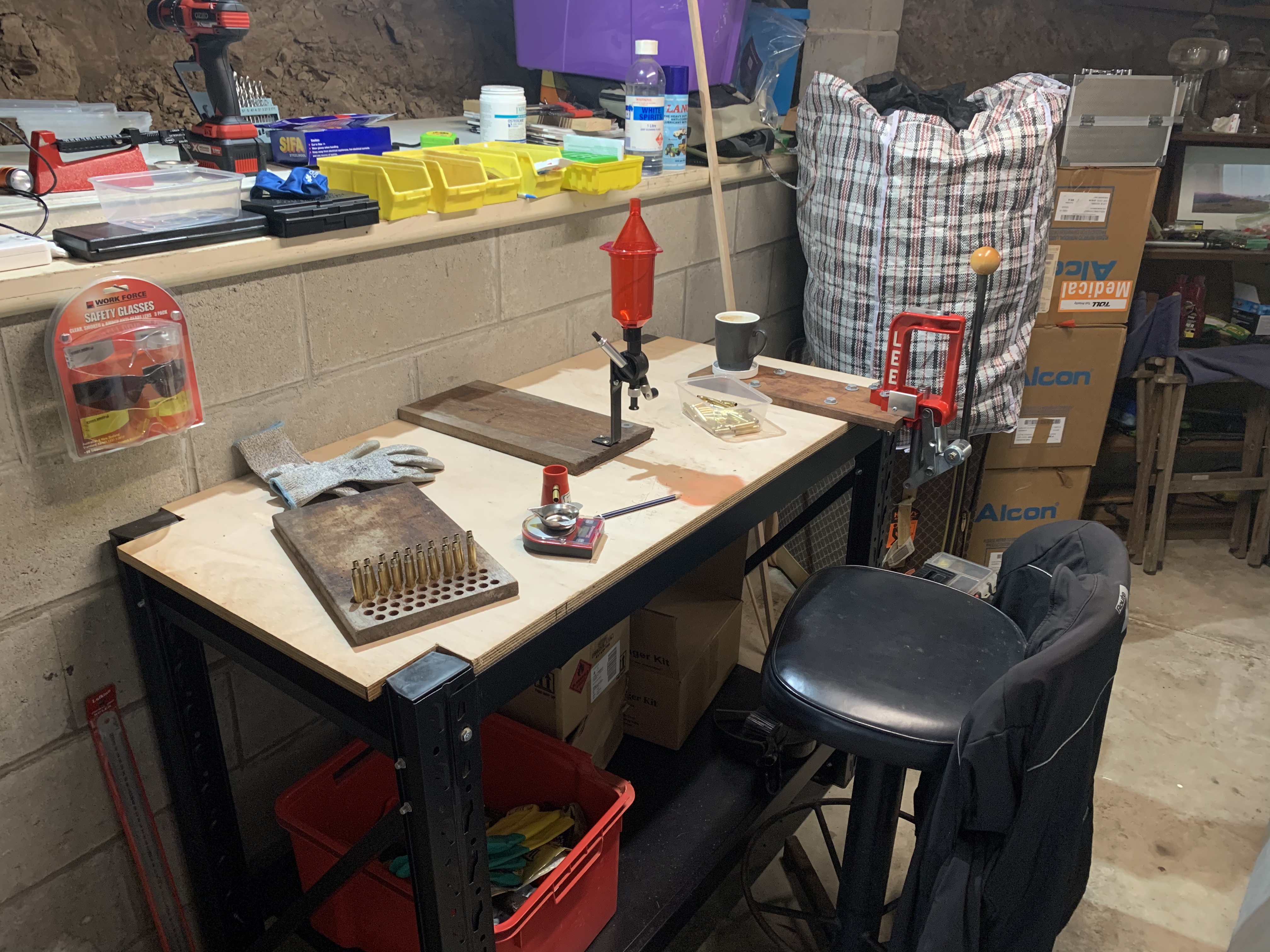

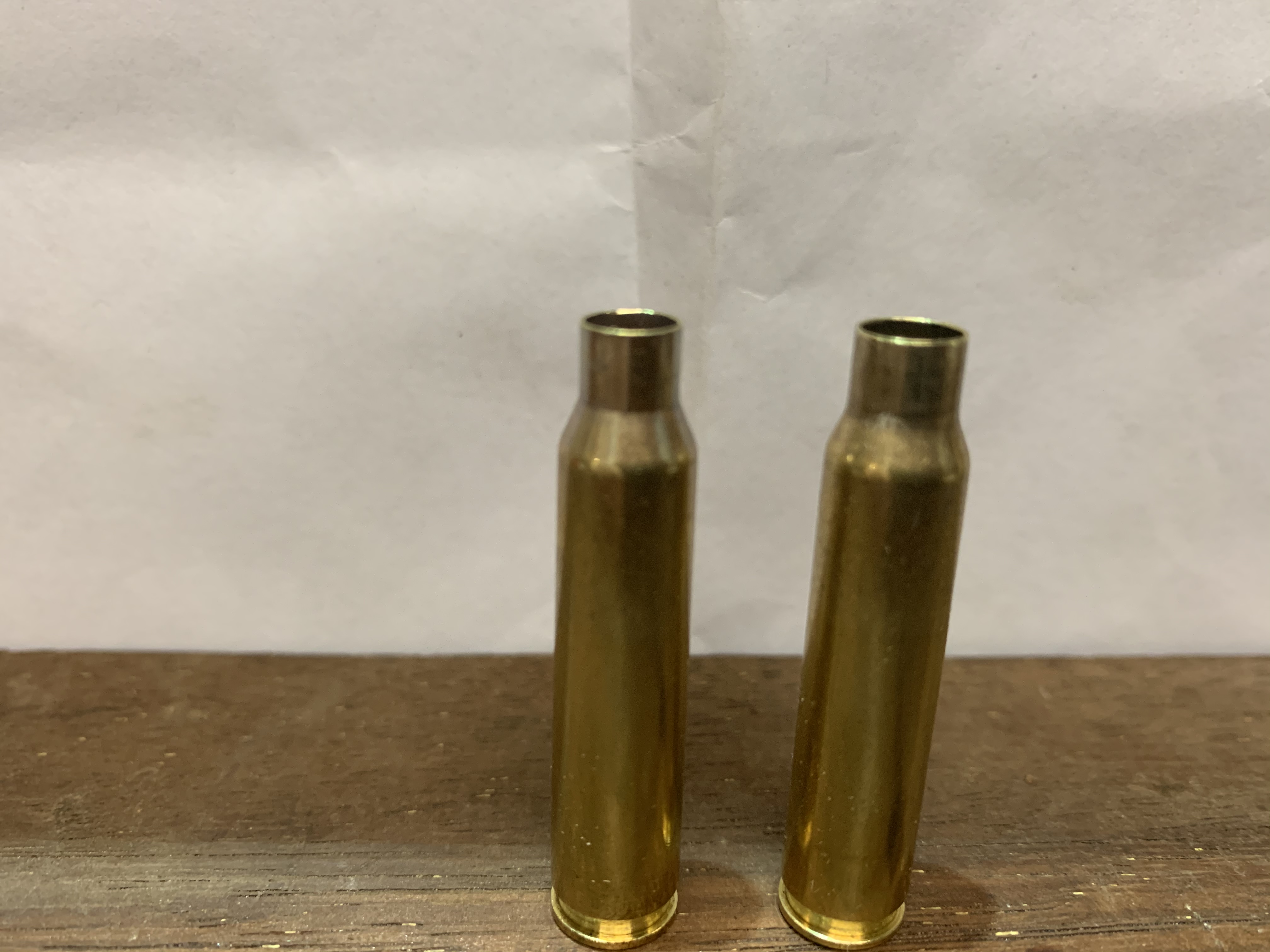

Post by Rathie » 13 Jun 2020, 1:29 pm
New reloading bench and a before and after shot of resized case

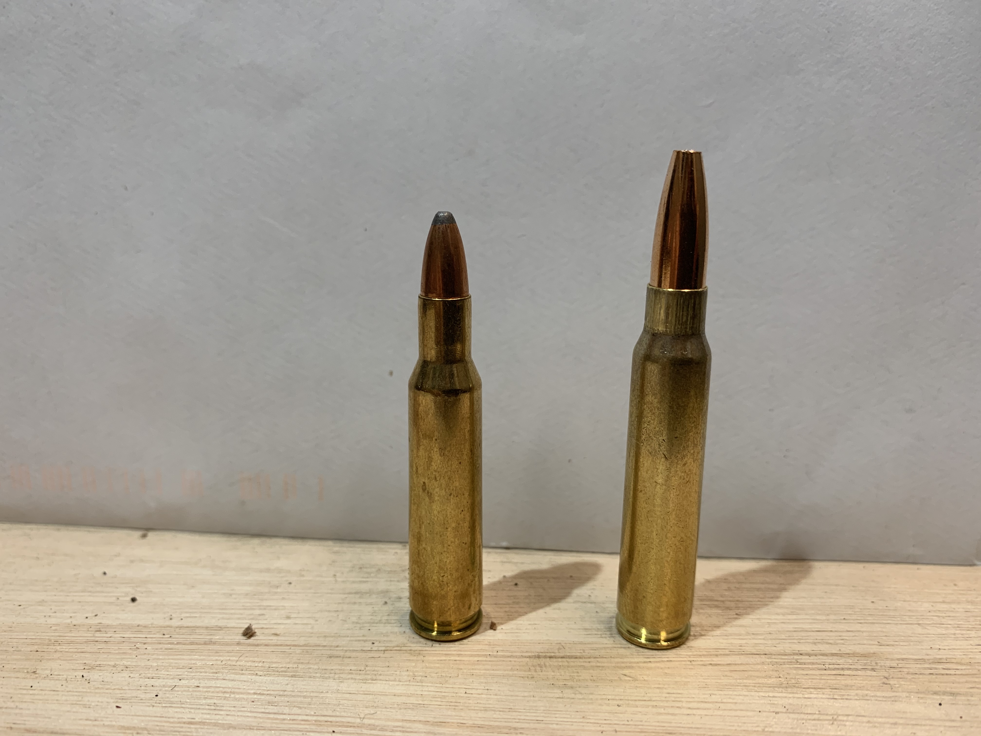

Post by Rathie » 13 Jun 2020, 4:10 pm
Kissing Cousins. 222 on the left and 6x45 on the right. To be fire formed in 6TCU chamber.
