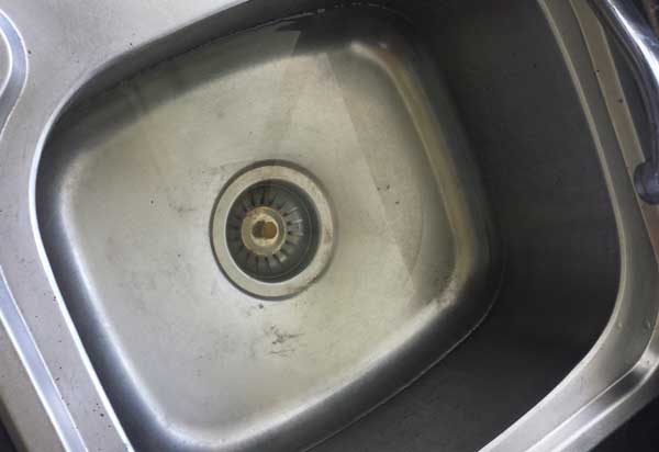

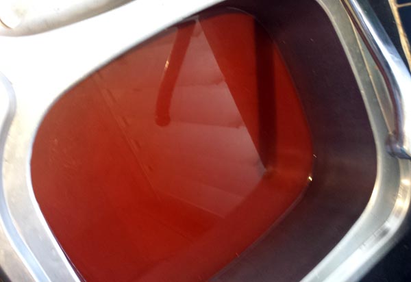

Post by Lorgar » 11 Mar 2014, 4:55 pm
For anyone thinking about washing their tumbler media to get rid of the dust on your brass when tumbling...
Before washing my walnut media...
washing tumbler media
After washing it...
This was from less than a kg of media.
Worth doing, brass is infinitely cleaner after tumbling once I'd washed the media.
Happy reloading.

And the wife is bitching about her dirty sink :lol:

Holy crap that's a lot of dust :shock:

Post by Lorgar » 11 Mar 2014, 9:07 pm
Guliver wrote:And the wife is bitching about her dirty sink :lol:
It actually took some serious scrubbing to get that crap off the sides of the sink :lol:
petemacsydney wrote:how did you pull it all out of the sink? pillow slip or something?
Yeah, I put all the media in a stocking and tied the end. Dunked the stocking in the sink and worked it all around to get the dust and lube out of the media.
To start with I didn't think it was going to do much... After a few seconds working it around literally nothing had happened, then the crap started coming out in waves.
After giving it a good slosh about I hung the stocking up in the sun for 2 hot days and it was good as gold.
Baldrick314 wrote:How long had you been using that media mate?
It's probably done about 600 brass or so? All lubed and re-sized before tumbling so a bit of lube in there too as mentioned above.
