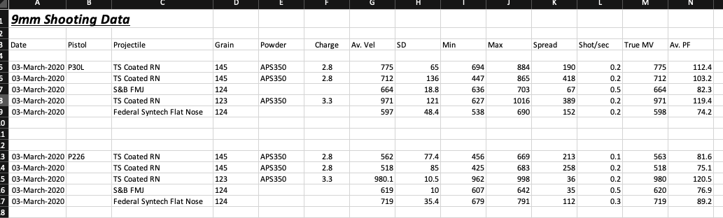

Hi All,
I recently got a Caldwell Ballistic Chrono to test my reloads, took it to St Marys where you can't have it beyond the firing line so I had only around 1-2ft between pistol muzzle and chrono. everything I read suggests around 10ft minimum, will this invalidate all my readings?
I was testing some reloads so had no idea what to expect here, some behaved as I might expect others not so, but not knowing Muzzle Velocity of these it was hard to tell. using APS350 powder which doesn't seem to have any helpful info on ADI site, their max loads wouldn't even cycle the slide consistently so I'm out in unknown territory..
I tested some Federal Syntech and Some S&B FMJ's which read significantly lower than their noted MV.
Am I chasing my tail as I'm so close to the chrono?
Results fwiw. all strings were 10 shots or more.
Thanks for any advice.
9mm Chrono.png (62.09 KiB) Viewed 5776 times

As long as it's reading accurately it won't invalidate the data.
I try to keep the chrono as close to the muzzle as possible, but some of the bigger stuff blowing out huge clouds of debris and gas can knock the chrono around and give very strange readings, if it's not stable move it further away until it is.
Max listed loads were max in their test firearm under those specific conditions, it may be well short of max in your situation.
I take ADI data with a large grain of salt as I don't believe they do any actual load development, I think they just feed it into a computer.

Main problem is I don't know what I can trust here, the only real data I know is the Federal Syntech Training Match ammo has a MV of 1150 on the box and I was reading 600-700 depending on pistol, so I have to believe all readings are suspect. The differeing velocities of the same 145gn reloaded rounds coming out of 2 different pistols also leaves me scratching my head. The S&B stuff is supposedly around 1150fps too although it was a 250 box so have no idea if that stuff is a 'cheaper' round. I'd question whether 70-80 PF would actually cycle the pistol though. They 'felt' like good rounds so I suspect its all pilot error on my behalf.
I guess the next step is to try and get the chrono further away somehow and try again to see if they repeat the same.
