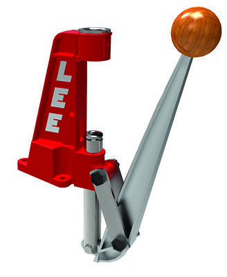

Post by Oldbloke » 27 Jul 2020, 2:32 pm
This might be another cheapish option.
OK for light work.

Post by Gamerancher » 27 Jul 2020, 3:21 pm
Yeah Oldbloke, while they aren't a bad little press used appropriately, I believe they are the one that give Lee presses a bad reputation. They don't tolerate a lot of force and tend to flex. They also get pretty sloppy quickly, not enough bearing surface on the ram to hold it straight.
I use one when I travel overseas as it's light, small and with an aluminium plate affixed to it, is easily clamped to any flat surface for reloading in a motel room.( Just don't tell management ) :lol:
I have the hand press and I mainly use it for de-priming cases with a universal de-priming die before I wet tumble them prior to reloading. I have used it to do some case prep in front of the T.V and fire in the house but, as something to use constantly for reloading, yeah,....NAH.

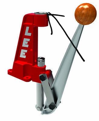

For a single stage press that will spend it's life at the bench I reckon these are hard to beat for "bang for your buck".
Lee Breech Lock Challenger Reloading Press 90588
Re: Lee Breech Lock Hand Press- worth getting?
Post by Oldbloke » 27 Jul 2020, 4:05 pm
Yeh, C type presses were popular yonks ago. But the O style is far better and now the dominant type in use.
Same price as the hand press. $71

Post by bladeracer » 27 Jul 2020, 4:29 pm
Oldbloke wrote:This might be another cheapish option.
OK for light work.
Yep, that's the C-Press I like for fiddly little cartridges, better access and you don't need the strength of the O-Frame.

Post by Oldbloke » 29 Jul 2020, 5:39 pm
Put a shim here.

Post by bladeracer » 29 Jul 2020, 5:53 pm
Oldbloke wrote:Put a shim here.
It's an interrupted thread though, shimming it just reduces the amount of contact of the thread. Half of the thread has been cut away leaving three sections, each about 12.5mm wide. If you shimmed it to be .75mm higher then you have halved the contact area of the thread.
