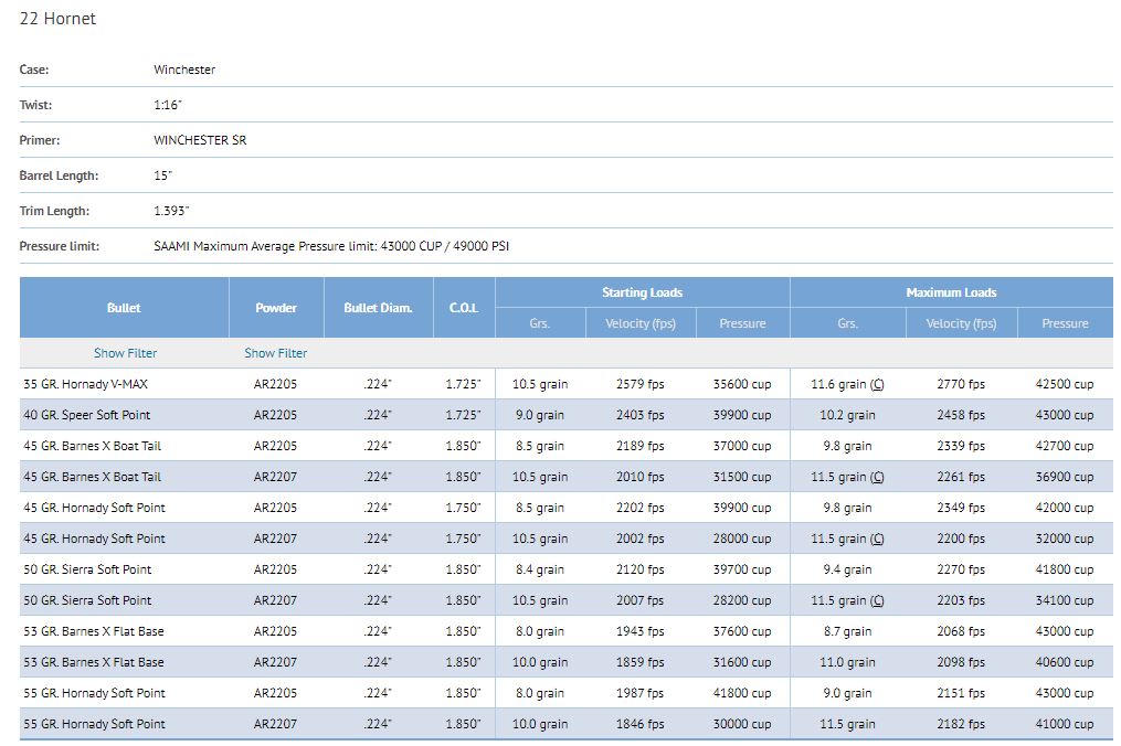

Post by bladeracer » 30 Jul 2020, 4:07 pm
Having the house re-wired the last two days but we finally have power back on :-)
5.7x28mm is listed as case capacity of 13.9gn of H2O.
.22 Hornet is listed as 14.0gn of H2O.
Virtually identical.
.22H pushes a 35gn bullet around 3000fps in rifles.
5.7x28mm makes about 2350fps with the 31gn bullet, but in a 10.5" barrel.
In the Hornet, ADI list AR2205 and AR2207, I would use the AR2205 myself. Their max load with the 35gn bullet makes 2770fps in a 15" barrel, on 11.6gn of AR2205 (same load makes 2900fps in a 24" barrel). That loads sounds about identical to what you'd get in the 5.7x28mm in a 15" barrel. I would load single rounds from 10.0gn to 11.5gn and shoot them to see if they cycle the pistol, and watching for pressure signs. Once you have that you can play around for accuracy if you want to.
ADI Hornet Pistol Loads.JPG (117.36 KiB) Viewed 22468 times
Posts: 13757

I forgot to add that the .22 Hornet and thew 5.7x28mm both operate at similar pressures as well, 49,000psi and 50,000psi, so similar loads should be safe in both.

Burn rates are not equivalents, I would use AR2205 unless you can source some of those foreign powders.
The data I used from the Hornet is with the 35gn bullets in 15" handgun barrels and should work fine in your handgun.
