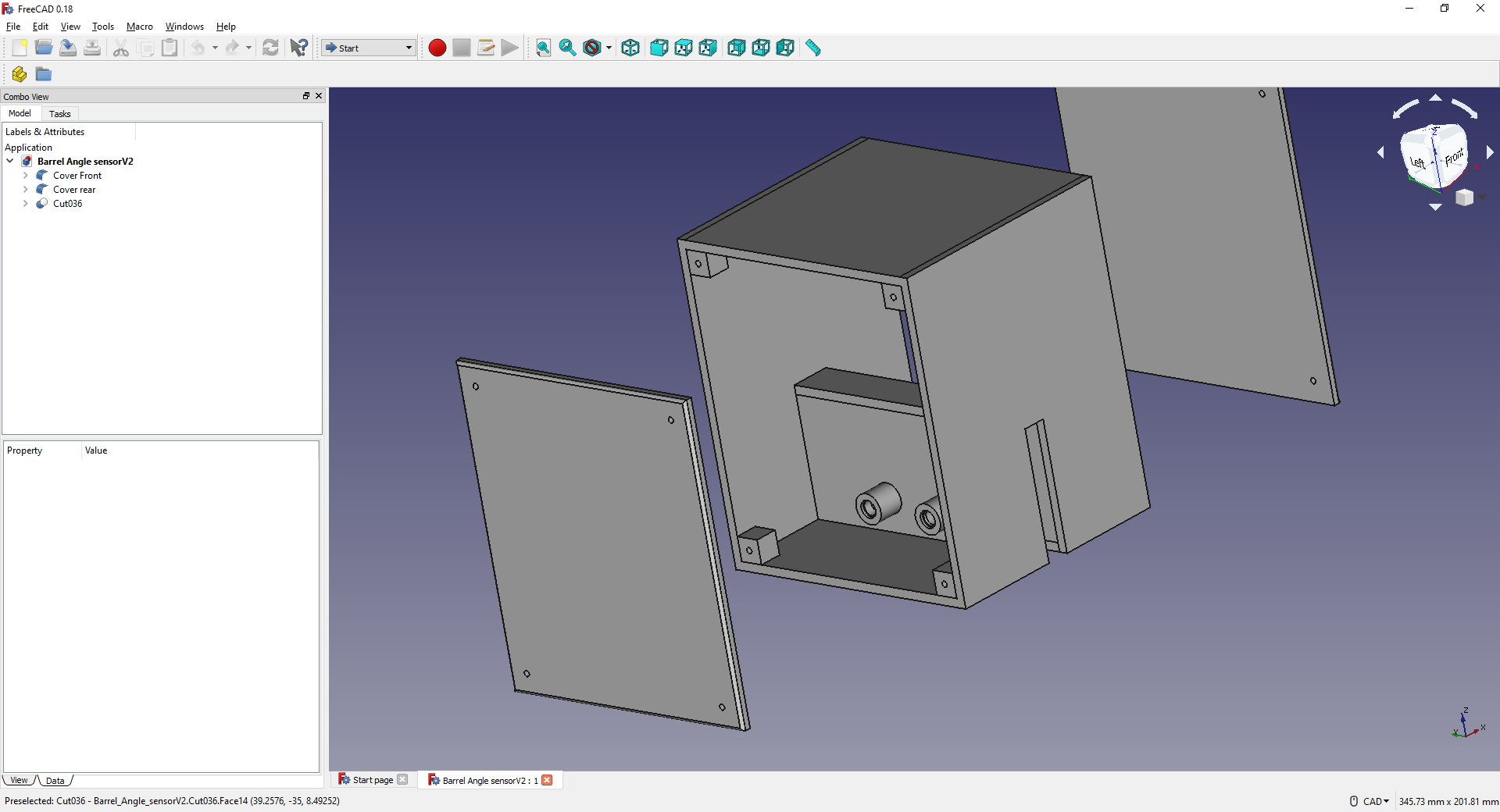

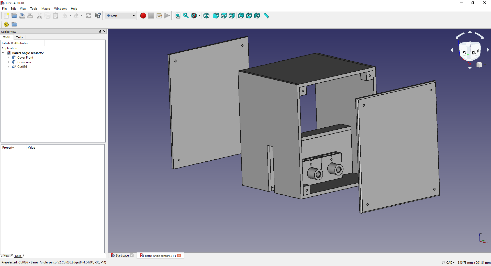

I designed a housing that looks like this- it holds 2 led's one one side, and two opto sensors on the other. The slot in the bottom is where the film attached to the barrel goes. It is upside down in this view- the slot should point upwards when in use.

I have calculated the positive compensation required for a 6.5 Creedmoor at 600 meters- it is .0035 milrad for every foot per second delta in velocity.
I think I am on that part of the curve, due to trial and error results, and soon I will be able to confirm that. I am kind of hoping that it is not.....because then there is another factor at play that I need to learn about and maybe apply some more creative skills to measure........
I need to do some more work first. I know that the sensor works in testing. Next steps are to check the gain settings are optimal, test a microphone setup I made that will pick up the sound of the firing pin hitting the case and start the oscope plotting a single sweep. If those both work at the range, I will make another sensor that detects the bullet leaving the muzzle. This will use the same setup as the angle sensor without the polarised film. When the bullet leaves the barrel, it will break the light beam and the voltage will drop. I can then plot both barrel angle and bullet exit signals on the oscope in sync. I will call the device build complete and let the ballistic measuring begin.

Interesting - amazing if you can get this transported and set up at the range. I’d struggle with mirroring lab bench / range bench accuracy - sounds like your on it though :drinks:
Link provided by MM is very good as well, lots of potentials at play.

TT,
The setup is small- 100mmx100mmx120mm, and the oscope is a digital handheld unit- both run on batteries so it's easily portable.
I am reading through the link posted by marksman. Interesting that the author and I have a similar background in RF.....Keep in mind I am measuring only the vertical barrel whip- not the "donut" expansion of the barrel that is targeted in the article.
Thanks for posting this marksman! It has the brain going full speed........
