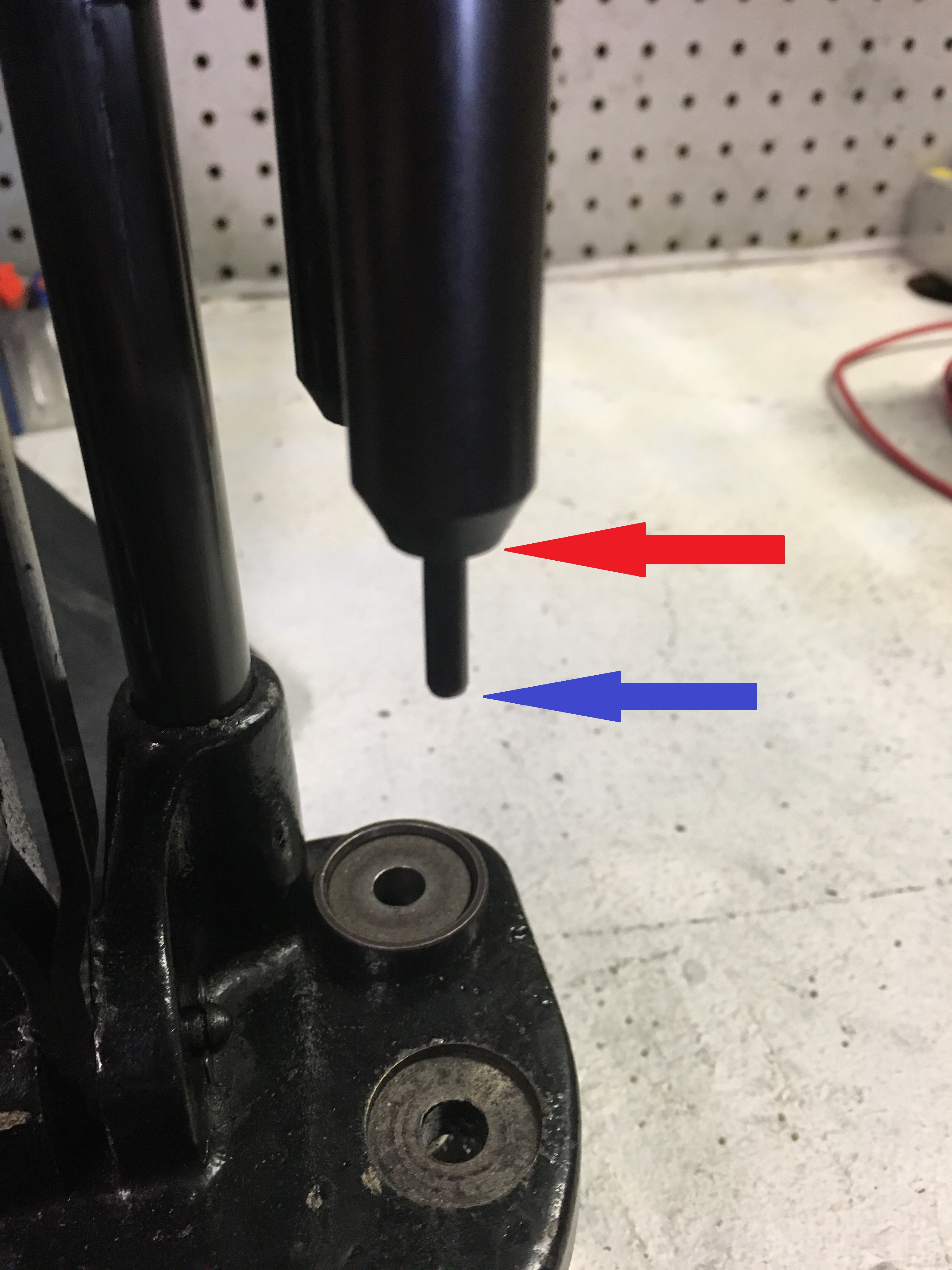

If you are loading the cheaper hulls- you can tell these as they have ribbed plastic instead of smooth- you can get a tight primer pocket buy using a pocket press. My ancient Stirling reloading press has a pocket press (red arrow) on the de-priming punch (blue arrow) . You pull the handle down on the press until the primer pops out, then keep pulling until the pocket press contacts the primer pocket. Give it a squeeze- the primer pocket gets flatter and smaller and your primers will be tighter. Most presses have this feature but not many people know it is there or how to use it. Once you do this- it will not matter what primer you buy. They all fit. I buy Winchester 209's unless there is a significant price difference for another type.
