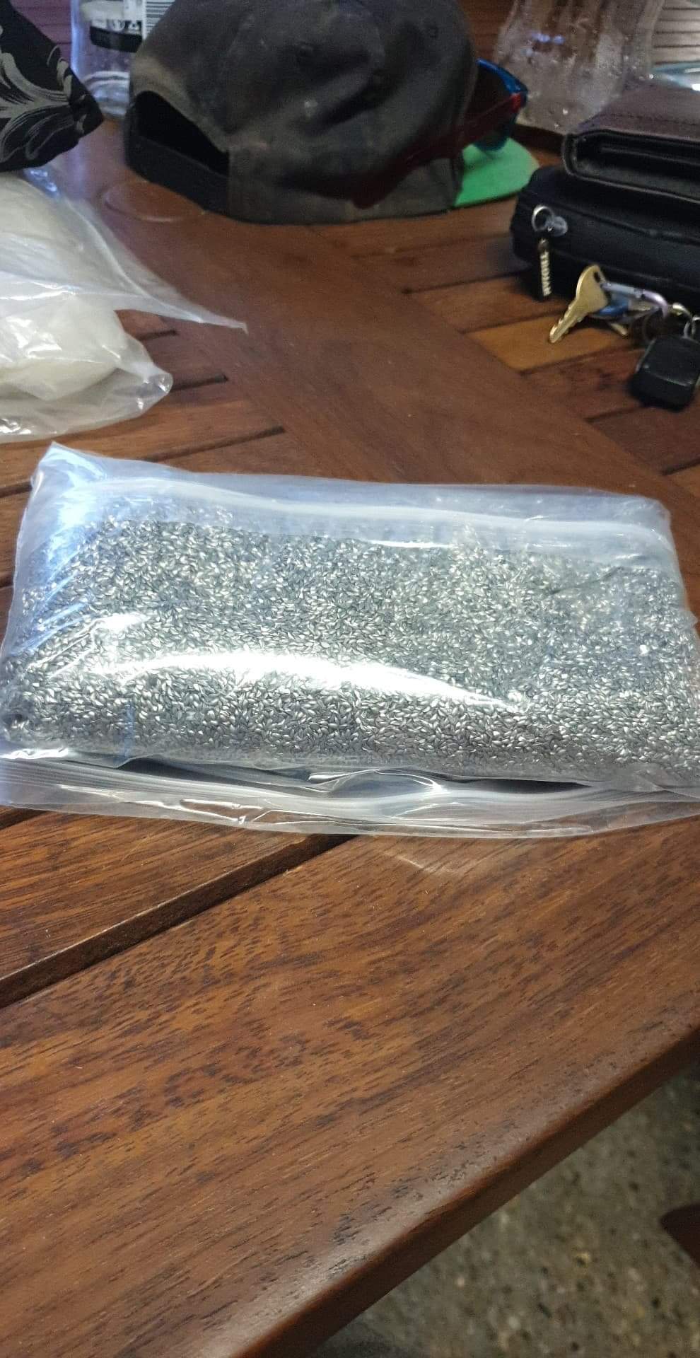

I found some cheap pins on EBay.
The ends were cut rough as if cut to length with side cutters but their doing the job perfectly.

l have got some decent reds around kilcoy
thought l'd put up a pic of what my cases come out like to set a standard
Do they stay that shiny MM? Or tarnish up ? - they look better than some of the brand new win cases I’ve purchased...
Re: Wet tumbling- what is the Australian magic mix?
Post by marksman » 21 Aug 2020, 6:32 pm
they usually stay like that for 1 firing, when they get used or age does dull them, l only clean them like this usually after first prep
Post by Larry » 21 Aug 2020, 7:10 pm
Chuck or at least put aside any media that you get with the ebay Chinese tumblers they will rust as already said. I found some Lyman tumbler pins on ebay and they have been great for several years in water nearly all the time may help.
I use a really good squirt of cheap dishwashing detergent and 1/2 teaspoon of citric acid. Risnse out well with cold water until the tumbler is running clean non soapy water out the top. dont worry about any bi carb or other anti acid methods that some people recommend clean cold water does the trick. Dry with towel then put in case to keep them separate and dry for as long as possible. if you dont dry with towel or let them touch each other you will get spots and blemishes rather than shiny spick and span.
