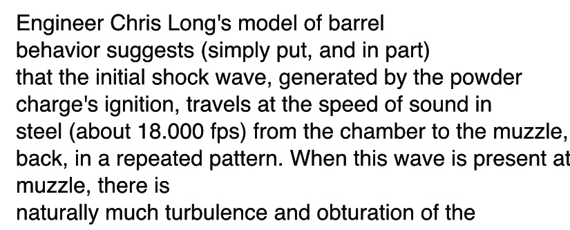

Interesting read - but is this speed of sound correct ?
l've sent Chris Long (tech shooter) an email to find out
l'll let you know when he has replied TT :drinks:
l have received an email response from Chris regarding your question TT :thumbsup: what a nice guy :drinks:
Mark:
The data is out there, but a bit hard to find easily. I found this source to be the most comprehensive. There is a slight variation between alloys, but not enough to worry about as the process only gets you to a good starting point.
Specifically, 416 stainless steel, the material for all the barrels I shoot, has a mean velocity of 0.236 inches per microsecond. This works out to 19666 ft/s. It is pretty fast compared to the speed of sound in air. This has been empirically confirmed over many years of testing.
Cheers,
l will send the information to you Tassie as its to large to put on the forum :drinks:
