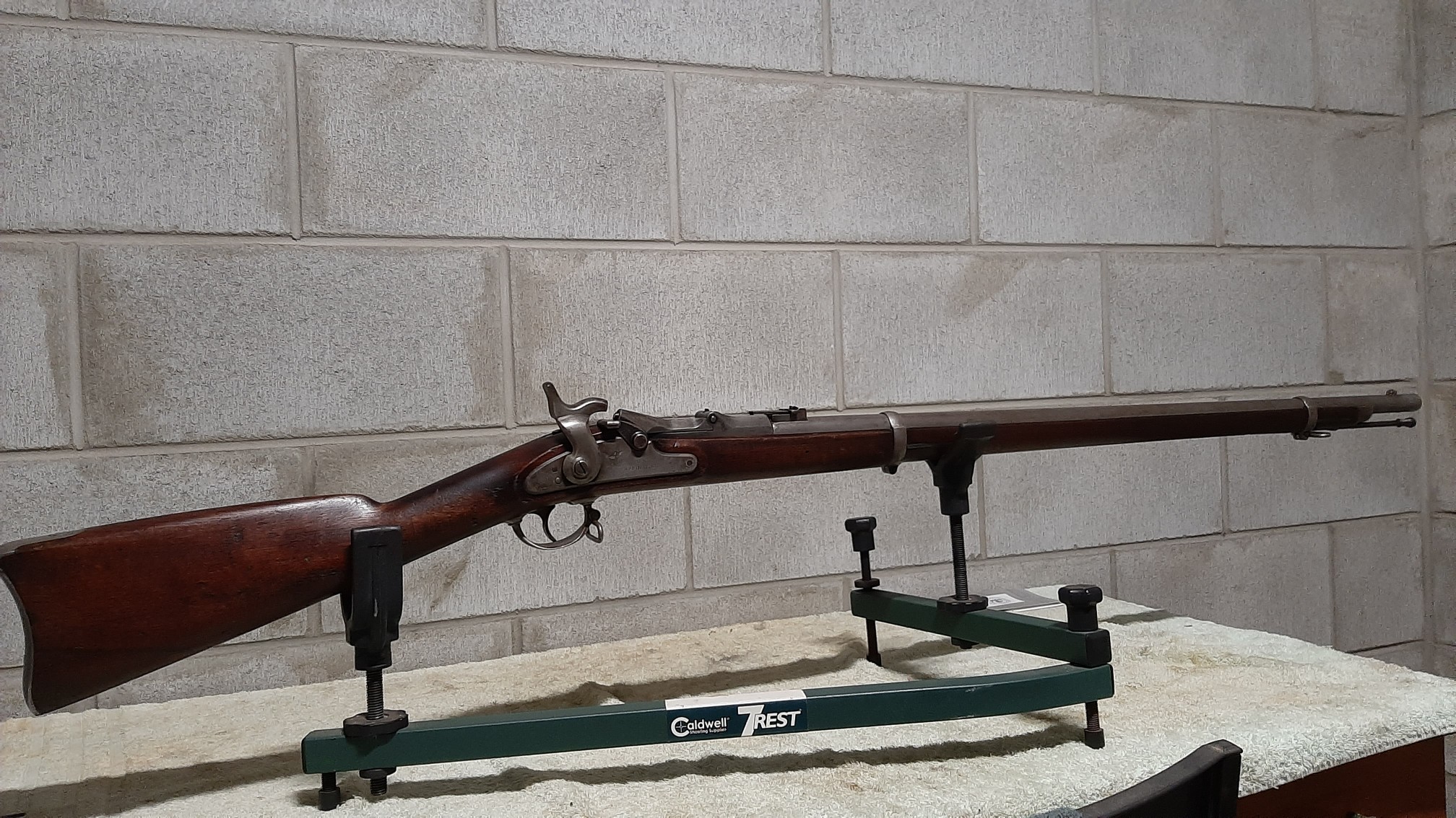

Picked up the 50-70 yesterday and it's so cool I have to show it off!
Kelsey Cooter

The US Springfield
Kelsey Cooter

1870 trapdoor conversion
Kelsey Cooter

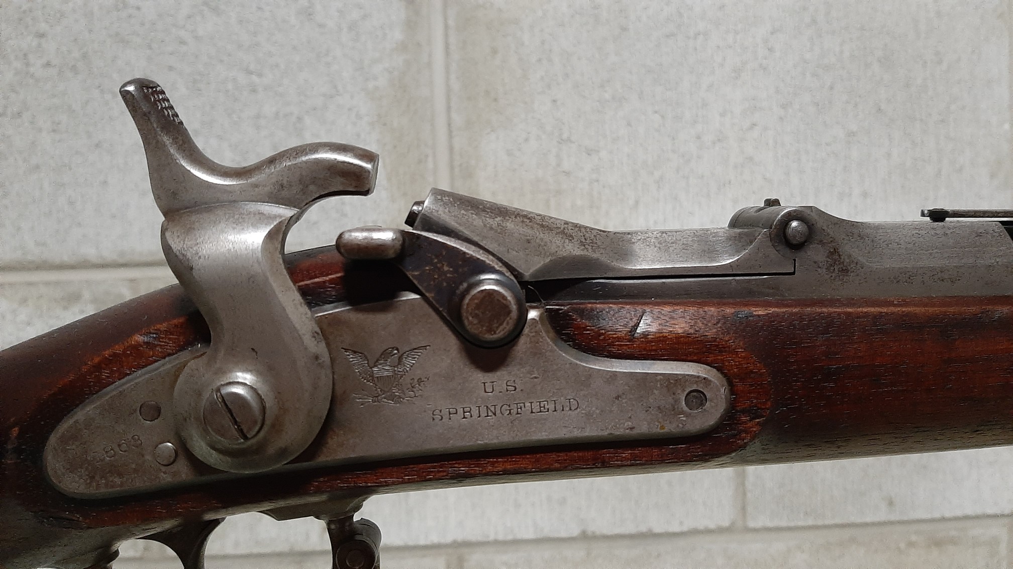

Post by Kelsey Cooter » 11 Nov 2020, 12:23 pm
1863 lock plate
