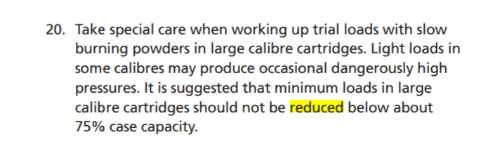

Post by Oldbloke » 19 Feb 2018, 7:45 pm
This is out-of the ADI manual.
reduced loads .jpg (39.15 KiB) Viewed 10867 times

Post by RoginaJack » 19 Feb 2018, 8:25 pm
Thanks OB. I've read where .222 Remington loads could be substituted for .222 Rimmed but I'm not too sure about that.
ADI doesn't list any loads or information re .222 Rimmed that I could find and that's why I was interested in how Dwayne went. Using him as a guinea pig so to speak.

Not sure if I'd be worried about secondary explosion effect on a .222....... I've loaded them down to .22 Hornet ballistics with no problems. I was of the belief that it was more symptomatic of large capacity cases using slow-burning powders? I think that the last case I ever heard of was a .25/06 being loaded to sub-sonic? However that was on an American website so I don't know for sure.

". I was of the belief that it was more symptomatic of large capacity cases using slow-burning powders? "
Correct. See above.
Not sure if 222 would be a contender for "large cartridge". . " And I think you can load a little lighter with 2206h. If in doubt just email ADI.

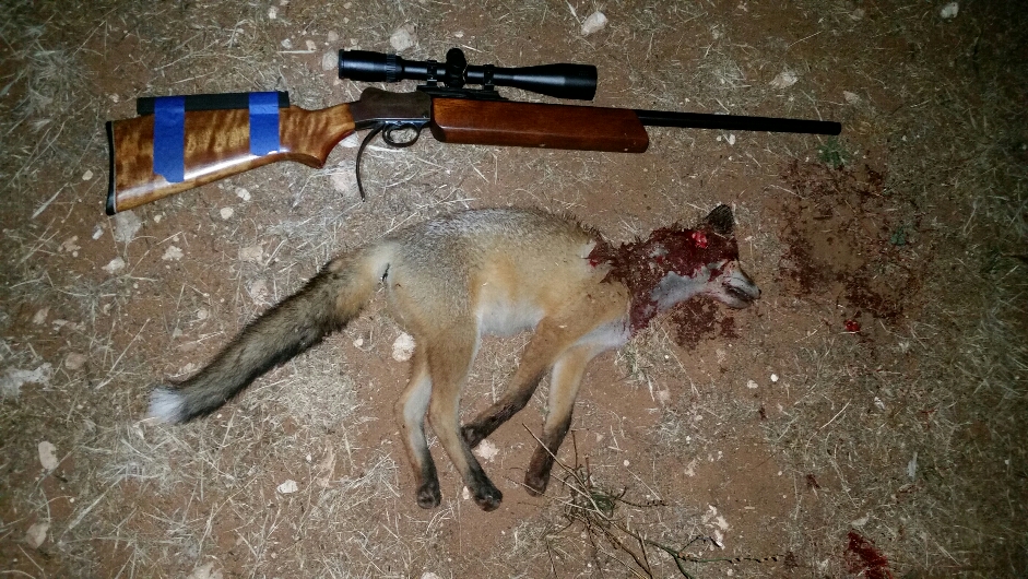

Here is a fox that crossed paths at 90 yds with my .222R...
.222 Rimmed, 40gr Zmax, 22.5gr BM2.
2017-10-30 20.34.37.jpg (528.08 KiB) Viewed 9351 times

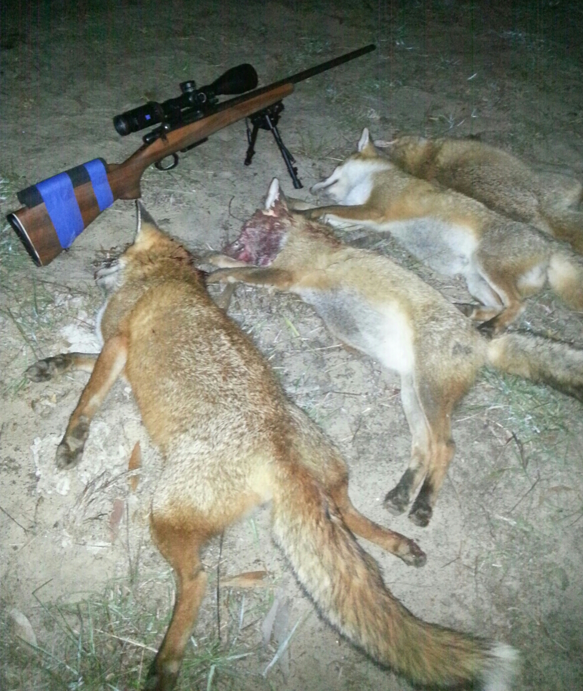

Here's another rifle...
This method seems to work pretty well...
The 22-250 & tenterfield team...
2018-02-22 13.14.45-1.jpg (1.24 MiB) Viewed 9332 times
Let me know if your interested in one mate...& ill send you the blueprints... :clap: :thumbsup:
