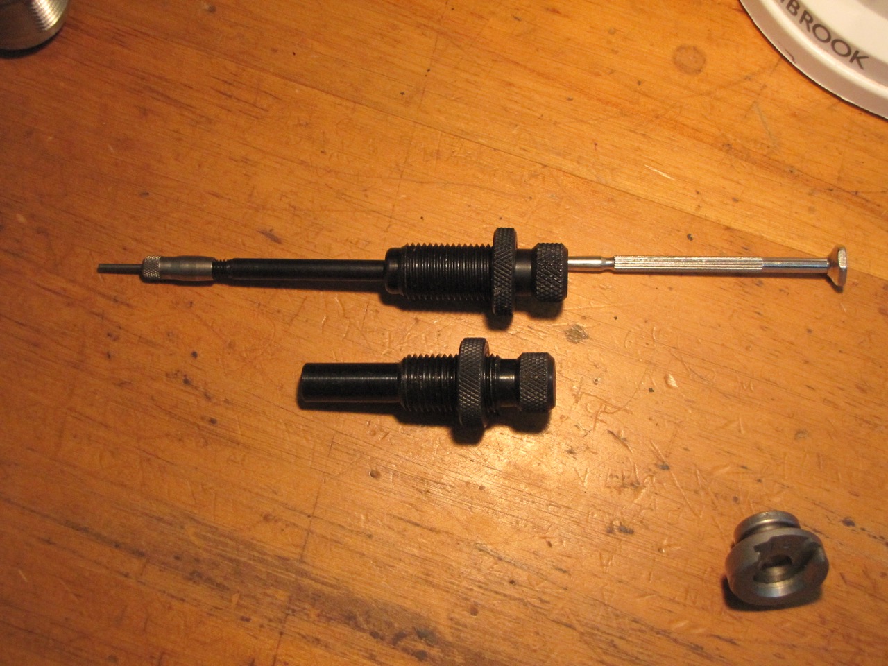

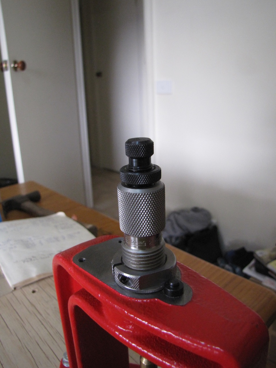

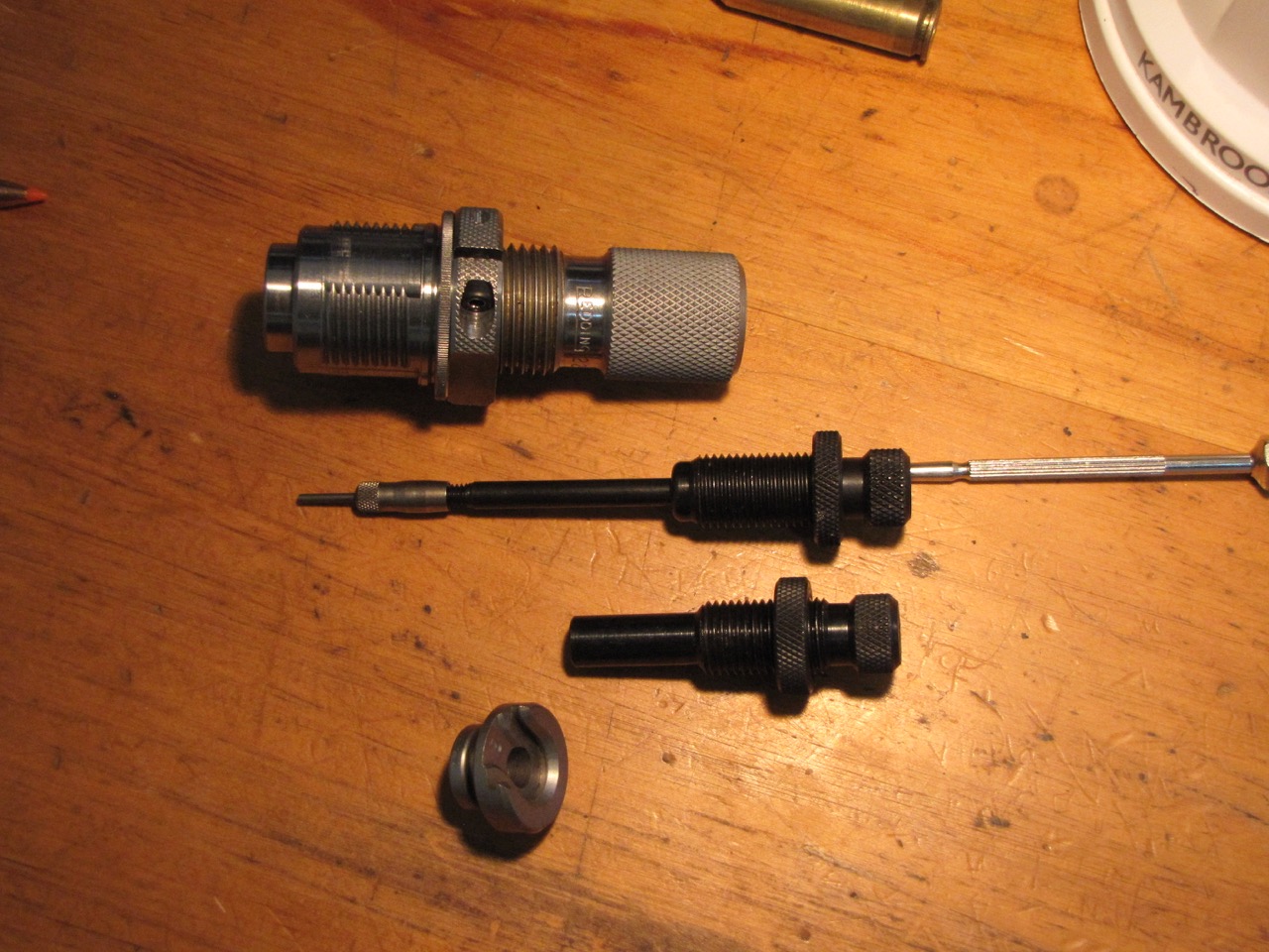

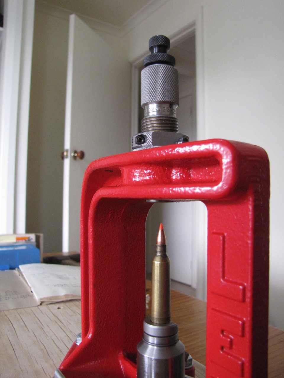

I did a thorough clean of the threads and a bit of tinkering. In the photos below I used the resizing/ depriming plug to check how far the seating plug was screwing down. The lock ring is at the max depth the plugs screwed down. You will see that the seating plug is not screwing down as far as the thread allows before bottoming out. I am guessing this is because the stem of the seating plug is bottoming out on the internals of the die where it would be doing the projectile seating? Doesn't seem to make sense that the seating plug would not be capable ofusing all the thread as per the diagrams/pictures you had included.
