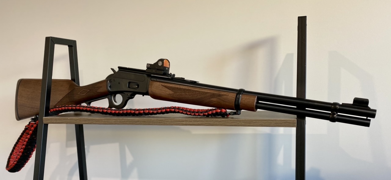

Post by JJD » 14 Dec 2020, 11:25 pm
My Marlin 1894C 38/357
JJD

Post by boingk » 15 Dec 2020, 12:00 am
Very nice, love the red dot on it.
