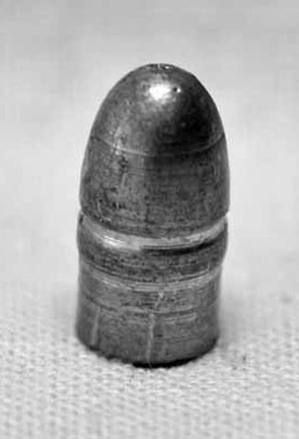

It's a long. I've an old drawing of the cartridge and the bullet and the bullet is definitely heeled, but I can't find the drawing - it's lurking there in cyberspace. When I find it I'll flick it across to you. CBE catalogue for that round also shows a definite heel.

Post by bladeracer » 18 Dec 2020, 11:26 pm
IlovemyLE wrote:It's a long. I've an old drawing of the cartridge and the bullet and the bullet is definitely heeled, but I can't find the drawing - it's lurking there in cyberspace. When I find it I'll flick it across to you. CBE catalogue for that round also shows a definite heel.
CBE certainly show a heeled bullet, .225" with a .216" heel.
How much shooting do you plan to do? It wouldn't be a huge effort to turn the tail of cast .225" 55gn bullets down to .216", and take a couple mm off to lighten them, provided you're not doing thousands of them. What is your case length and what is the CoaL you want?
Since your brass is .220" ID I'd just turn them down to that to get a snug fit without having to crimp it.

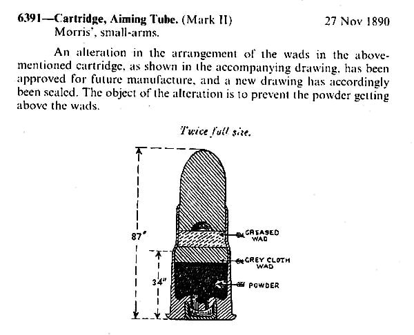

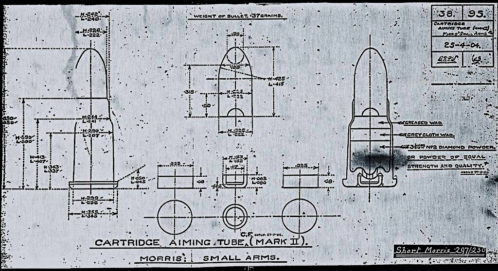

Post by No1Mk3 » 19 Dec 2020, 2:51 am
G'day IlovemyLE,
The original Morris bullet was not heeled as you can see from this 1904 drawing. The use of heeled bullets today comes from the making of brass from 22 Hornet cases, by the time you shorten the case and form it the neck is quite thick and it becomes problematic to use normal bullets without reaming the cases so the mould from CBE casts a heeled bullet. I have also had some success pulling bullets from old 22 RF both lead and jacketed HP, Cheers
Posts: 2329

Post by No1Mk3 » 28 Mar 2021, 12:39 am
G'day justdave,
Look at the drawing I posted with that, it clearly shows a non-heeled bullet and is dated 1904. Also the post from bladeracer shows original drawings of non-heeled bullets, Cheers.
