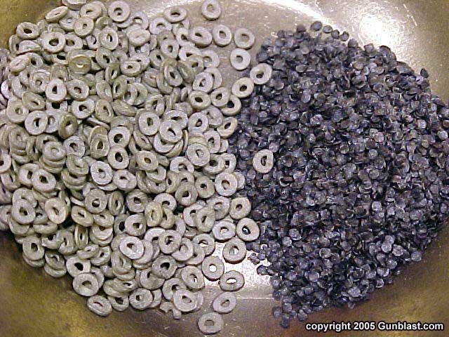

Good picture here from GunBlast demonstrating how much space the different powders occupy for the same weight.
Trail Boss' unique shape and added bulk are apparent when compared to a powder such as Bullseye. On the left is 6.1 grains of Trail Boss, and on the right is 6.1 grains of Bullseye.

47gr of Trail Boss powder would fill a .308 case 3x over.
Case density isn't going to be a problem ;)

Like delicious Cherios.
Delicious, explosive Cherios :D

Ahhhh!
Googling a picture would have given me my answer I see.
Makes perfect sense now. I didn't realise it would be so different.
