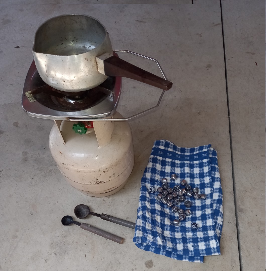

Pretty easy even using basic gear like I use. But can be a bit of an art.
Wear leather gloves
Safety glasses
Keep water away from molen lead
Plenty of ventilation. Open doors and widows if doing it in a shed.
Look after your moulds.

Post by Blr243 » 09 Jan 2021, 4:23 pm
The pic from sir old bloke just goes to show you don’t need to lash out on gear. That stuff is already in everybody’s shed
Re: Casters in Vic
Post by Oldbloke » 09 Jan 2021, 5:21 pm
Blr243 wrote:The pic from sir old bloke just goes to show you don’t need to lash out on gear. That stuff is already in everybody’s shed
Yeh, given the amount of casting I do, I could never justify buying the good gear.
I get good results but I'm not after competition type standards. Mainly just for fun.
I would encourage anyone to have a go on the cheap like i have. If you decide your keen and shoot a lot go for it and buy decent equipment.
P.S. I just use Lee moulds. They do the job but as Noisydad said, may not last as long.

I started with a $25 camp stove, gravy ladle, muffin tins (for ingots) and a $3 saucepan from vinnies.
Still use most of this for making ingots but now have a bottom pour pot.
Lets face it. The process was done over a campfire by thousands for centuries.
