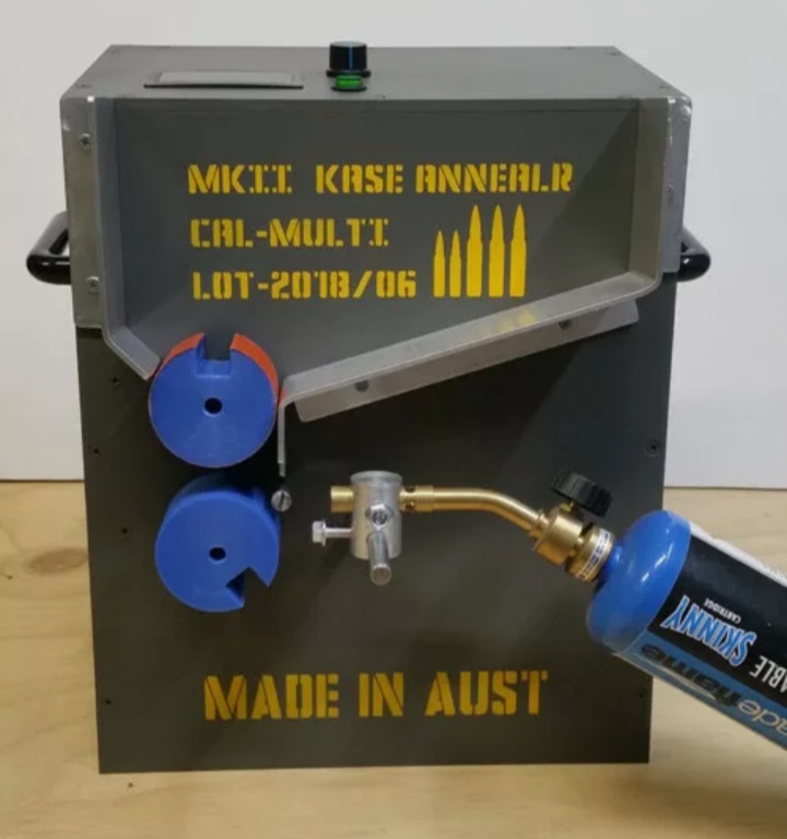

Or you can spend up to a grand on an annealing machine which does a better job. :allegedly:

Or you could go all out and buy a killer machine
