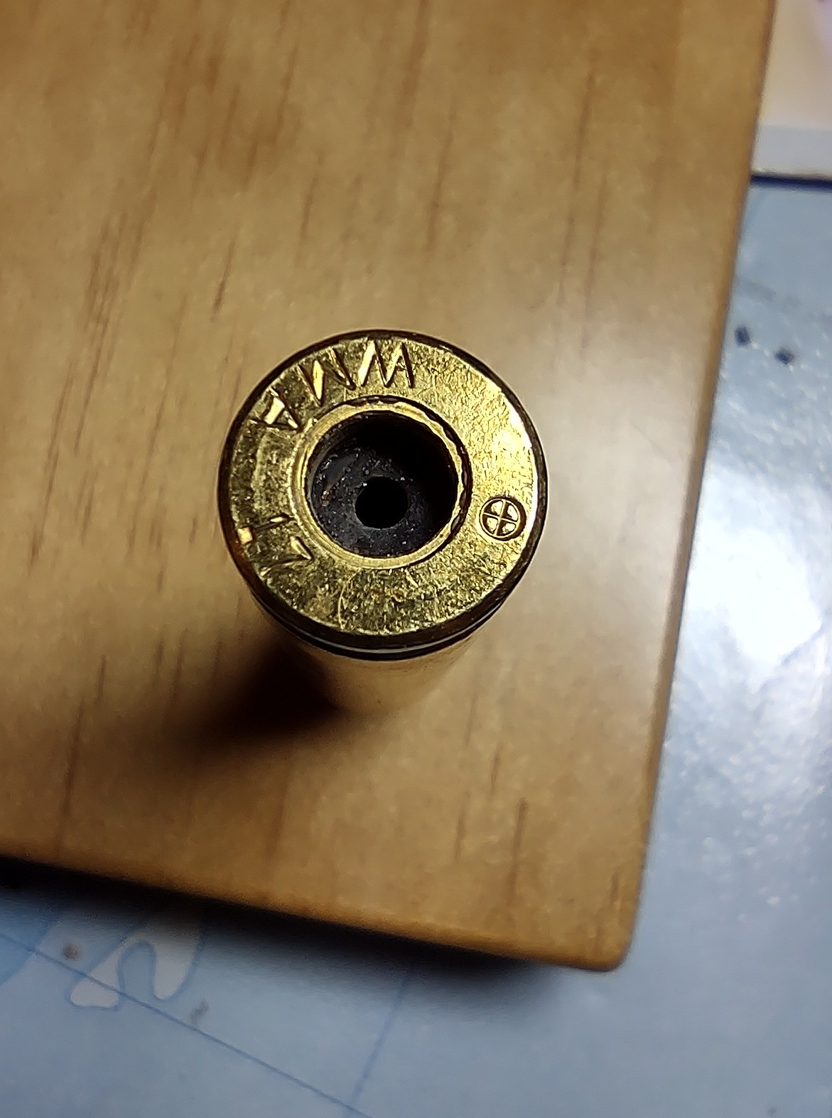

Post by Pinkmus » 11 Mar 2021, 7:50 pm
Thanks for the help guys. I only used a cleaning tool initially (that said there is still visible carbon in the pockets) and tried both the hand priming tool and the press mounted priming cups/arms. I used the chamfering tool on the primer pockets and it solved the issue. I might pick up a primer pocket uniformer but the chamfering seemed to work well.
Cheers Will.

Post by deye243 » 11 Mar 2021, 8:14 pm
Pinkmus wrote:Thanks for the help guys. I only used a cleaning tool initially (that said there is still visible carbon in the pockets) and tried both the hand priming tool and the press mounted priming cups/arms. I used the chamfering tool on the primer pockets and it solved the issue. I might pick up a primer pocket uniformer but the chamfering seemed to work well.
Cheers Will.
That ring around the primer pocket is the crimp just get your deburring tool and make about half turn primers will go in no worries at all

Post by bladeracer » 11 Mar 2021, 8:27 pm
Cheers Will.
Yep, crimped primers. You need to cut it away.

Post by on_one_wheel » 11 Mar 2021, 10:00 pm
WMA (Winchester Military Ammo)
The cross is a NATO marking
The cartridge was a 7.62, their external dimensions are the same as .308 however the internal dimensions differ, it has much thicker walls giving the cartridge less internal volume, this may cause issues with consistency and possibly even pressure issues when mixed / reloaded with other civilian brass if you don't adjust charges accordingly.
Great solid brass, but personally I wouldn't mess with it unless all my brass was the same to ensure consistency.
As already said its crimped.

Post by wanneroo » 12 Mar 2021, 12:44 pm
Yep that looks like the NATO headstamp there.
7.62 NATO brass has about 1.5g less capacity than 308.
Personally in my case for a lot of my 7.62 NATO and 308 brass, I am loading a general target shooting 147g FMJ bullet and I am several grains off max loads and I mix the brass together and load it with no issues and no giant issues with velocity variation or pressure. My advice would be if you are NOT doing something like that then separate out the 7.62 NATO from the 308.
If you want to check case capacity yourself to see the difference, fill a fired case with water and measure it and compare it to other brass.
7.62 NATO brass is almost always 100% going to have crimped primers in the event it's run through a machine gun. You can ream them or swage them, your choice.
