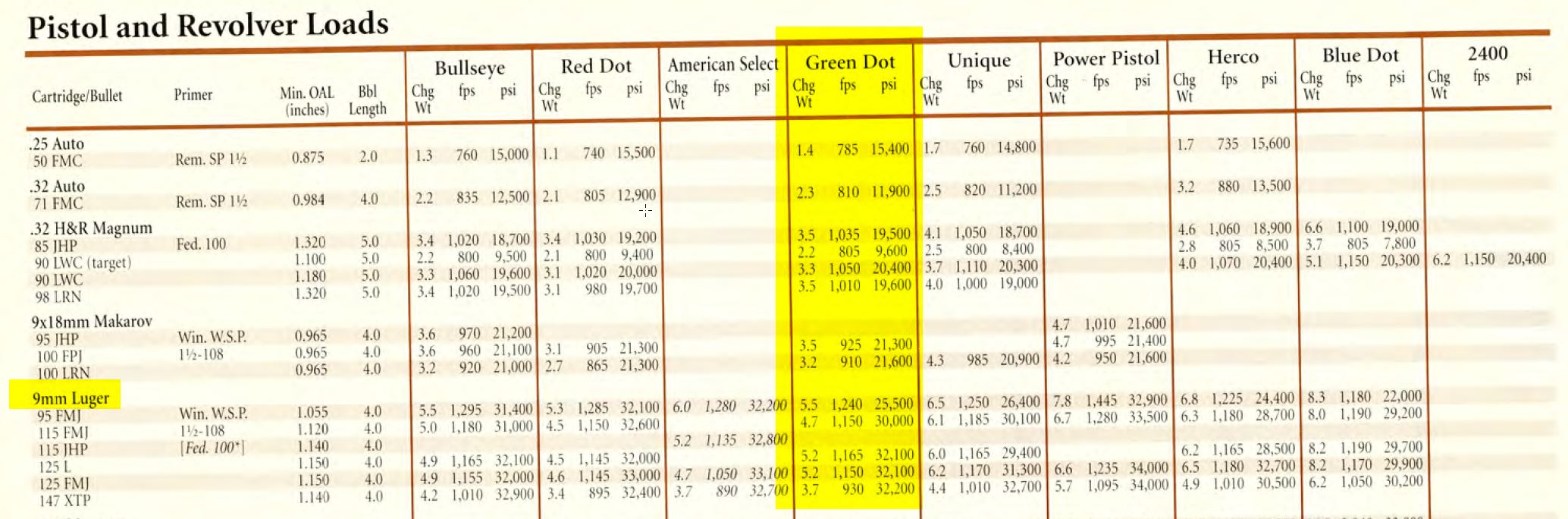

This is only true in the recent Alliant load books.
They used to used to provide load data for Green Dot in 9mm. Commercial decisions often mean that they drop data for one powder in favour of another.
I agree that Unique would be a better choice but currently its a case of what you can get and Green Dot will work.
Taken from the 1996 Alliant reloading book
