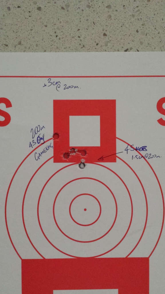

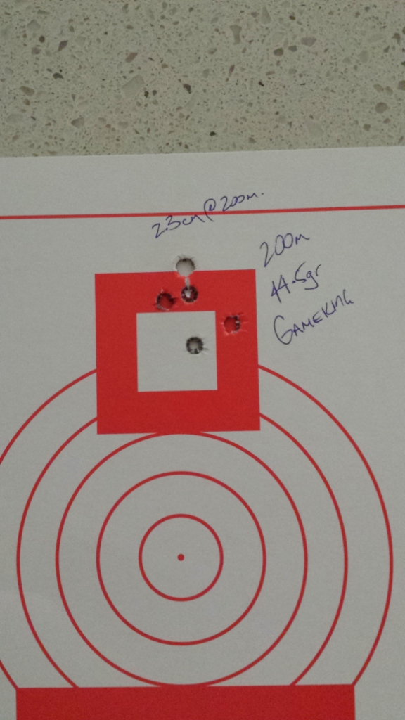

Post by Hogester79 » 10 Jun 2014, 3:35 pm
Hi there,
I have a 243 Tikka Varmint with a Whiskey Rifle Stock, 6-24x50 blah blah and I've spent a considerable about of time working up decent loads with various bullets.
Starting ladder testing, always 5 shot groups with a minimum of 30-45 seconds (sometimes closer to 1 min) between each shot, first group with it, using the standard stock before moving to the Whiskey was about 0.5MOA, not bad with Federal 80gr factory stuff!
Anyway, for some reason I just can't get the VMAX's to tighten up, sub MOA but not where I wanted to be. Switched over to the Sierra 85gr HPBT (Gameking's) and @ 200m 43gr 2209, 4 of the 5 shots were inside 1.5cm (total was 3cm at 200m) and other group of 5 with 44.5gr was 2.3cm...the 43gr (4 shots) are 0.3MOA and the 2nd is just under 0.5MOA.- COAL is 2.65".
I have been unable to get the Game kings recently and found some Berger 87gr VLD's that I will be working on this weekend out at the range, took me HOURS to find the right measurement to the lands (2.735" haha). Will be focusing around the 42.8/43gr level but ladder testing initially on COAL before narrowing down the grain loading.
Can upload some pics if anyone want's to see the targets. BTW the VMAX's, Sierra's and Berger's will all be good out to as far as you could shoot a 243 as long as you are shooting at paper. They will hold together and work well in any 1:10 twist well.

Hogester79 wrote:Can upload some pics if anyone want's to see the targets.
I'm interested if you'll post them :)
lapp
Posts: 32
Re: .243 reloading questions
Post by Hogester79 » 11 Jun 2014, 2:45 pm
Hopefully this works
I have more pics around but they are split between 100m and 200m ranges. Typically start @ 100 and then when Im happy move across to the 200m to make sure I have a 200m zero.
Game_king_200m_445
game_king_200_43gr
