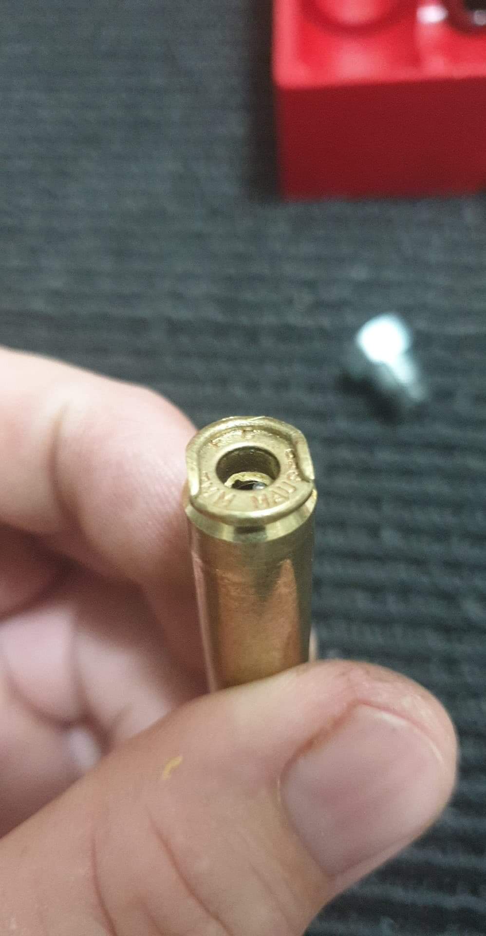

The cases do NOT go into my Lee 7x57 FL resizing die after being fired with out excessive force and if I resize bit by bit, some come out but I have had three of five stuck with the rim sheering off when trying to extract the case.
If I cut the neck off one fired case, I can resize it comfortably
To me it seems as if the neck gets stuck if it is forced into the die and then the rim sheers off when trying to extract. I know that I sould never have to use that much force, but I am just trying to figure out what the hell is wrong.

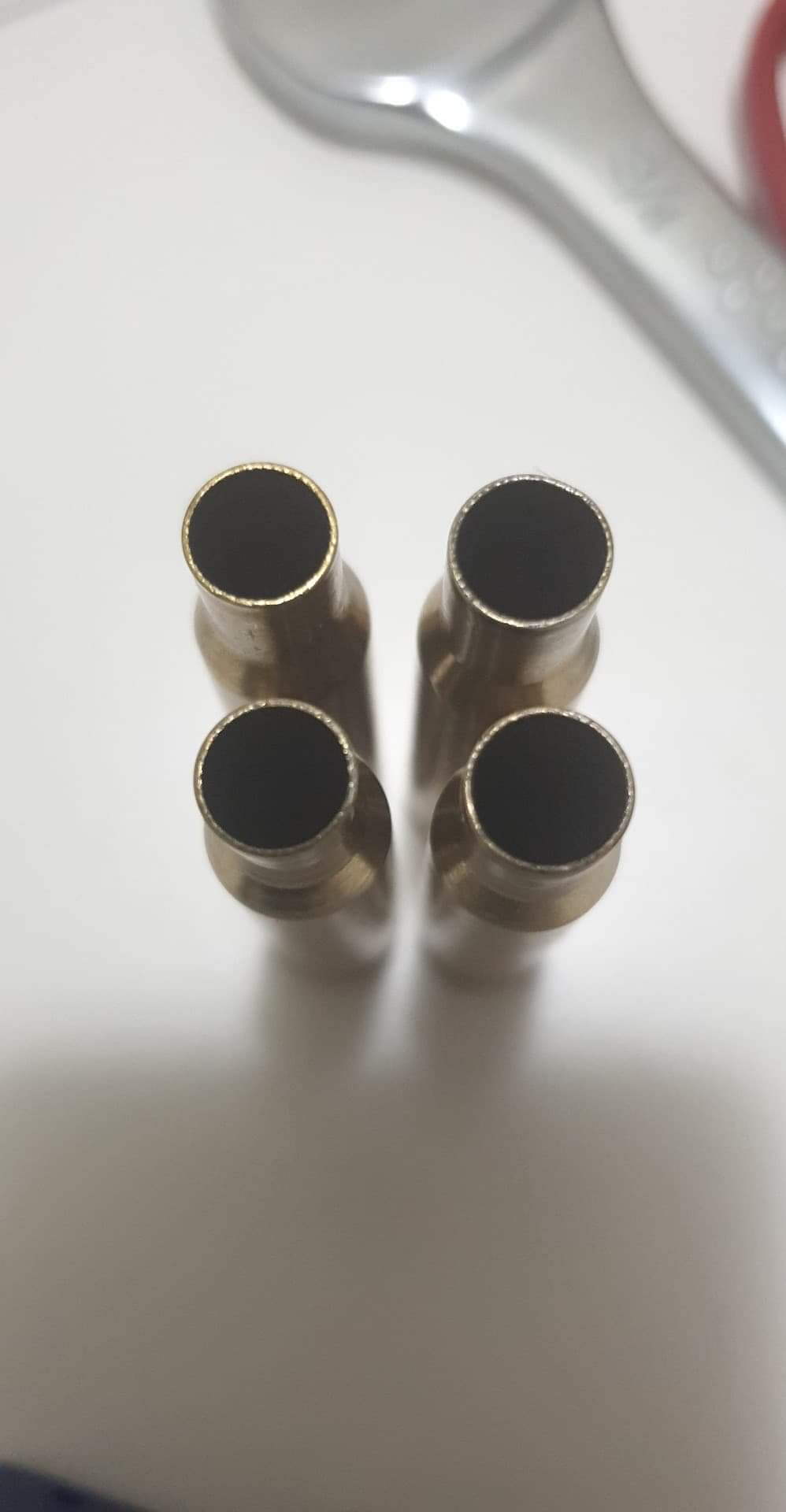

The difference between fired and sized is actually visible without measuring ... that's why I was a little concerned in the beginning.
In the photo below you can see resized necks on the left and fired ones on the right.
I successfully finished 30 cases with good amounts of Lee lube and was happy so far.
Have ordered a Redding neck only die because I don't want to resize the rest of the case every time.
Maybe that one will go easier.
pops70

Re: Issues with neck size of 7x57 ?
Post by straightshooter » 30 May 2021, 10:02 am
pops70
Having now seen the picture of the disfigured case rim I would suggest that you examine the relationship between the expander ball and the neck part of the die.
If the expander ball is too close to or indeed pushed up into the neck part of the die then that would explain all your problems.
After breakfast I will check one of my Lee FLS dies which has a collet/clutch arrangement to see if that is possible. It can't happen with other brands that have a threaded decapper stem.
