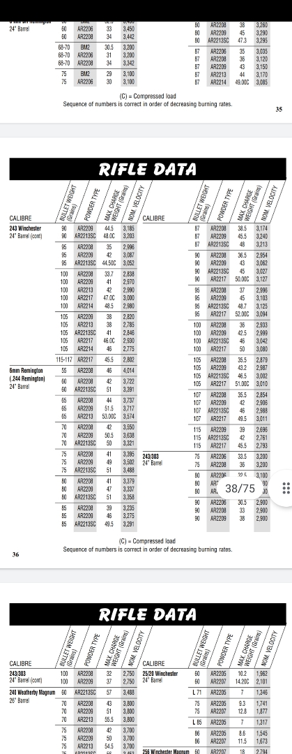

This is the 3rd Ed ADI manual 2000.
Old 243 data.jpeg (226.19 KiB) Viewed 1954 times
Edit. AR2214 doesn't get a mention in the 4th Ed

Post by Oldbloke » 16 Jun 2021, 5:20 pm
This pg 35 3rd Ed 2000
Old 243 data pg 35.jpeg (192.65 KiB) Viewed 1949 times
Edit. NOTE. They only list the MAX charge. So ensure you start about 10 or 15% below listed.
