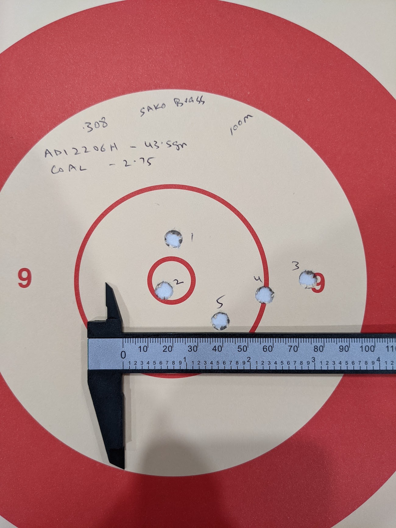

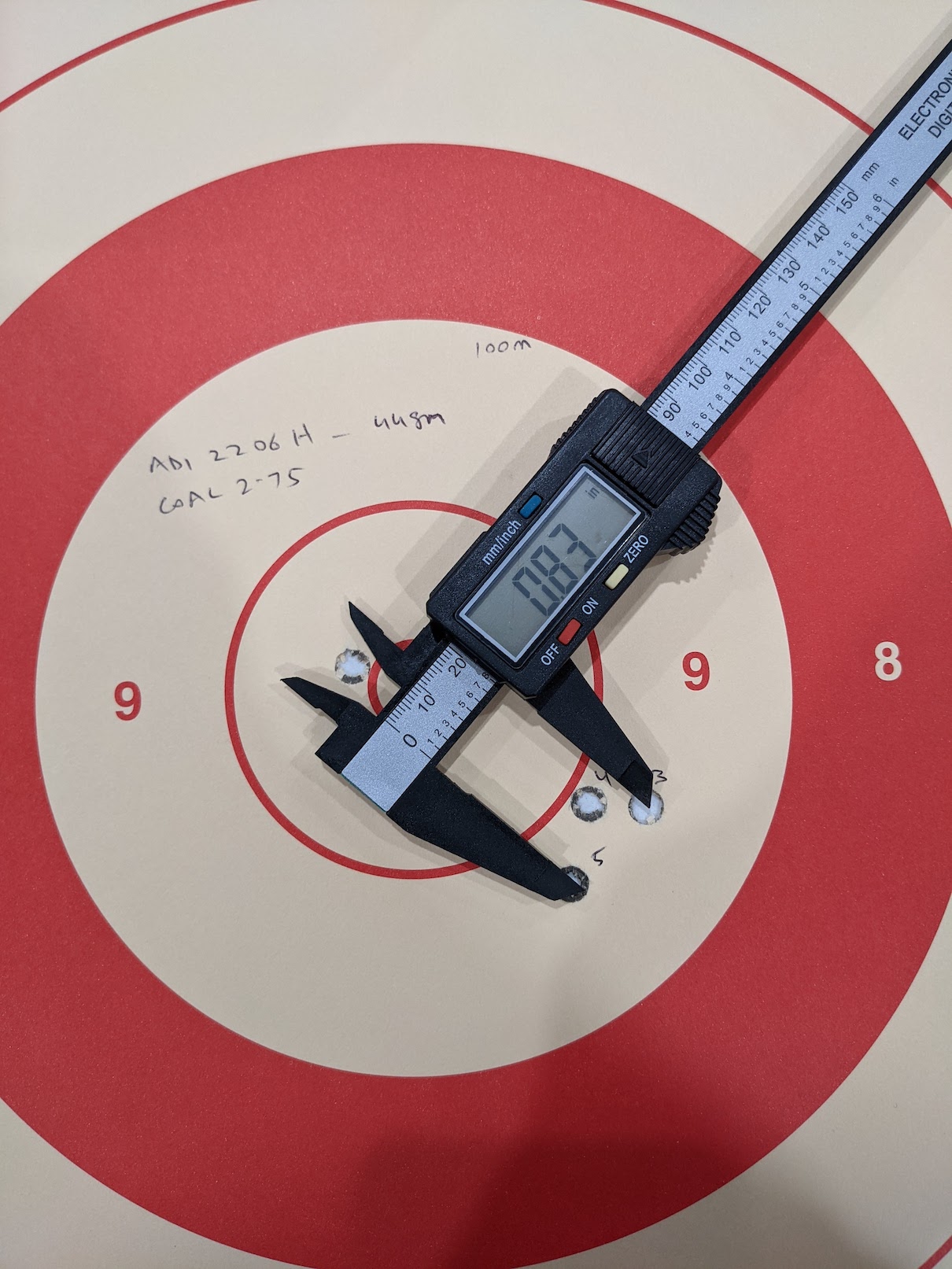

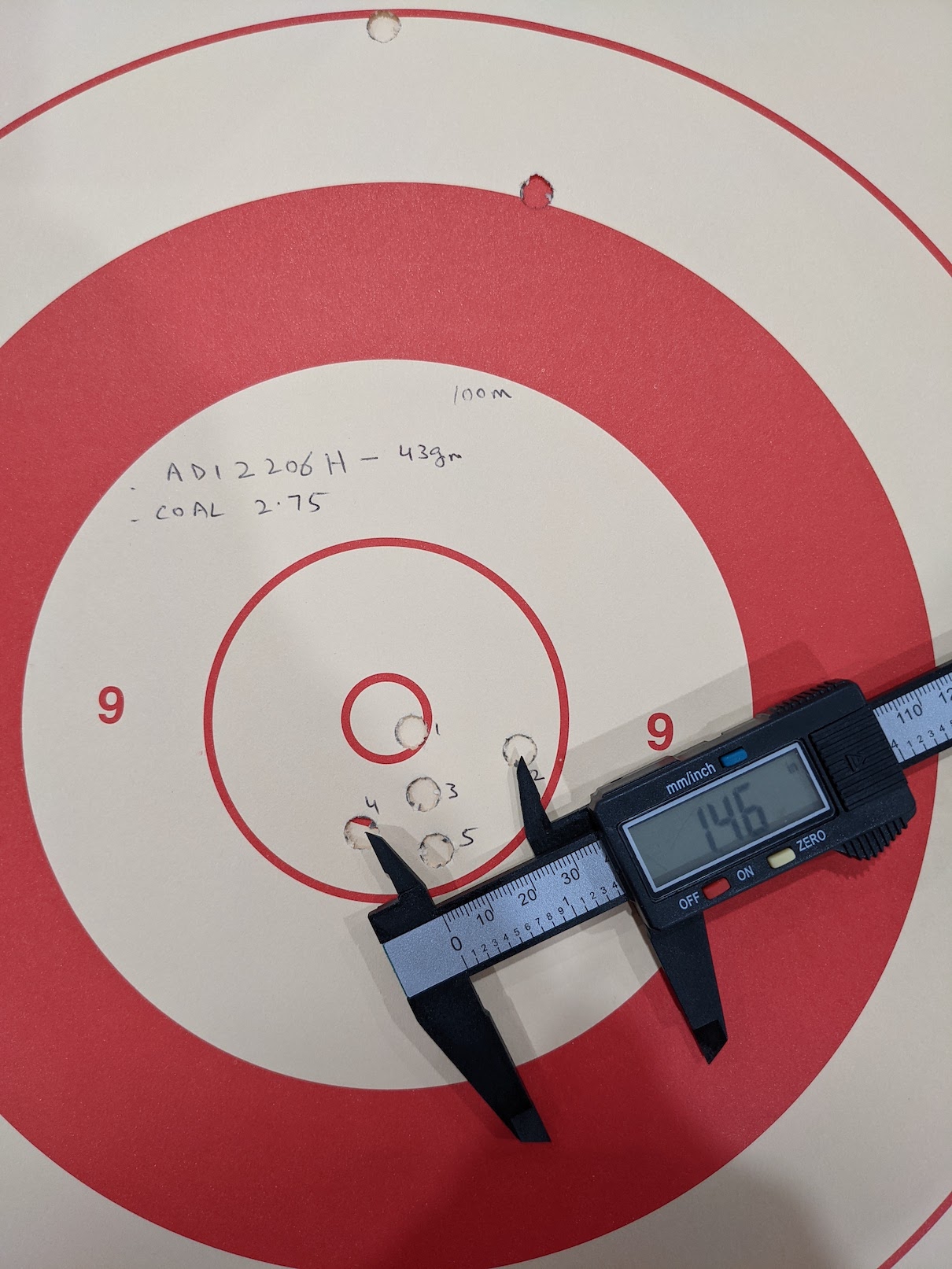

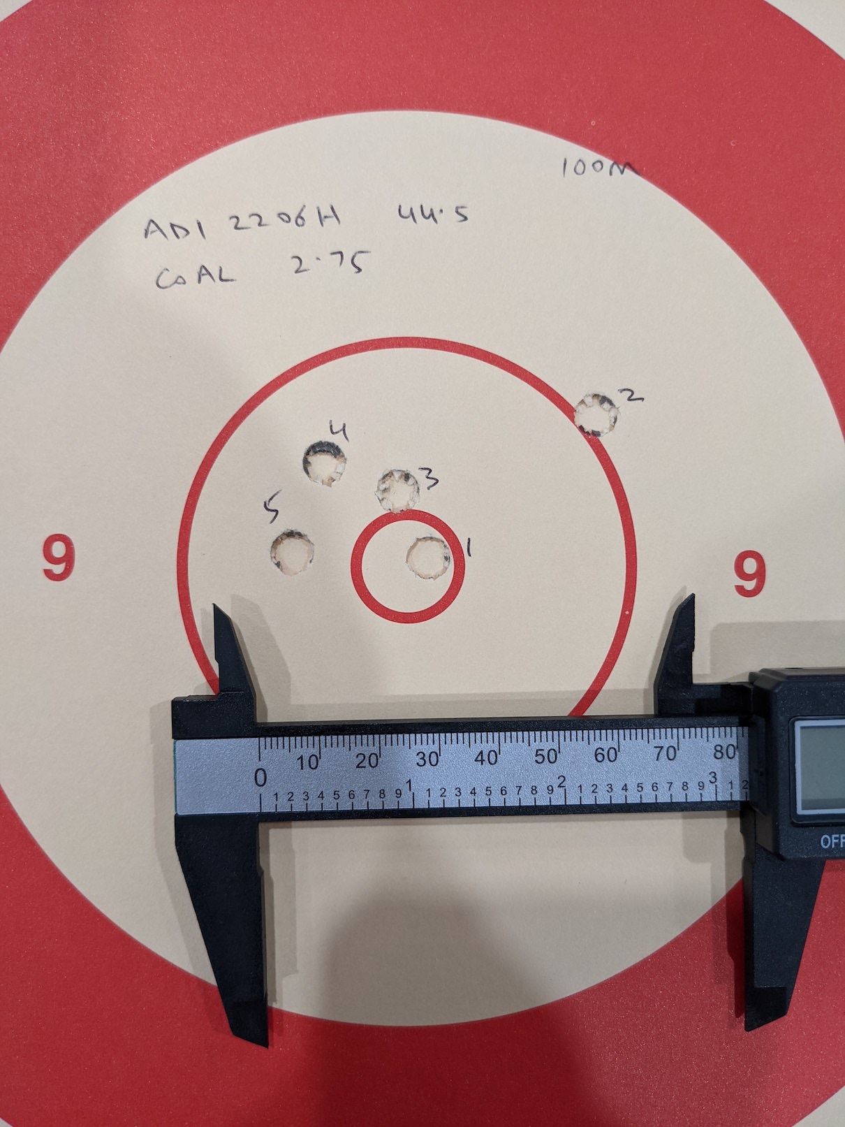

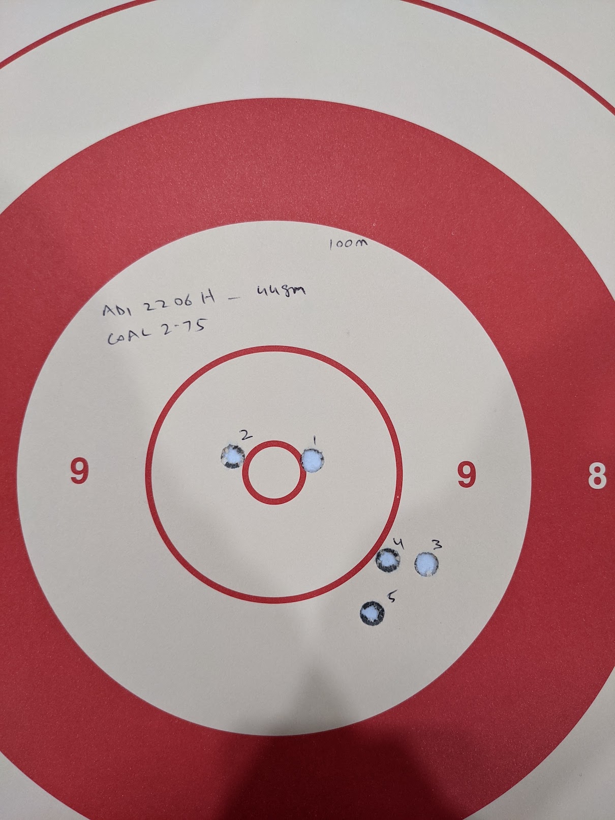

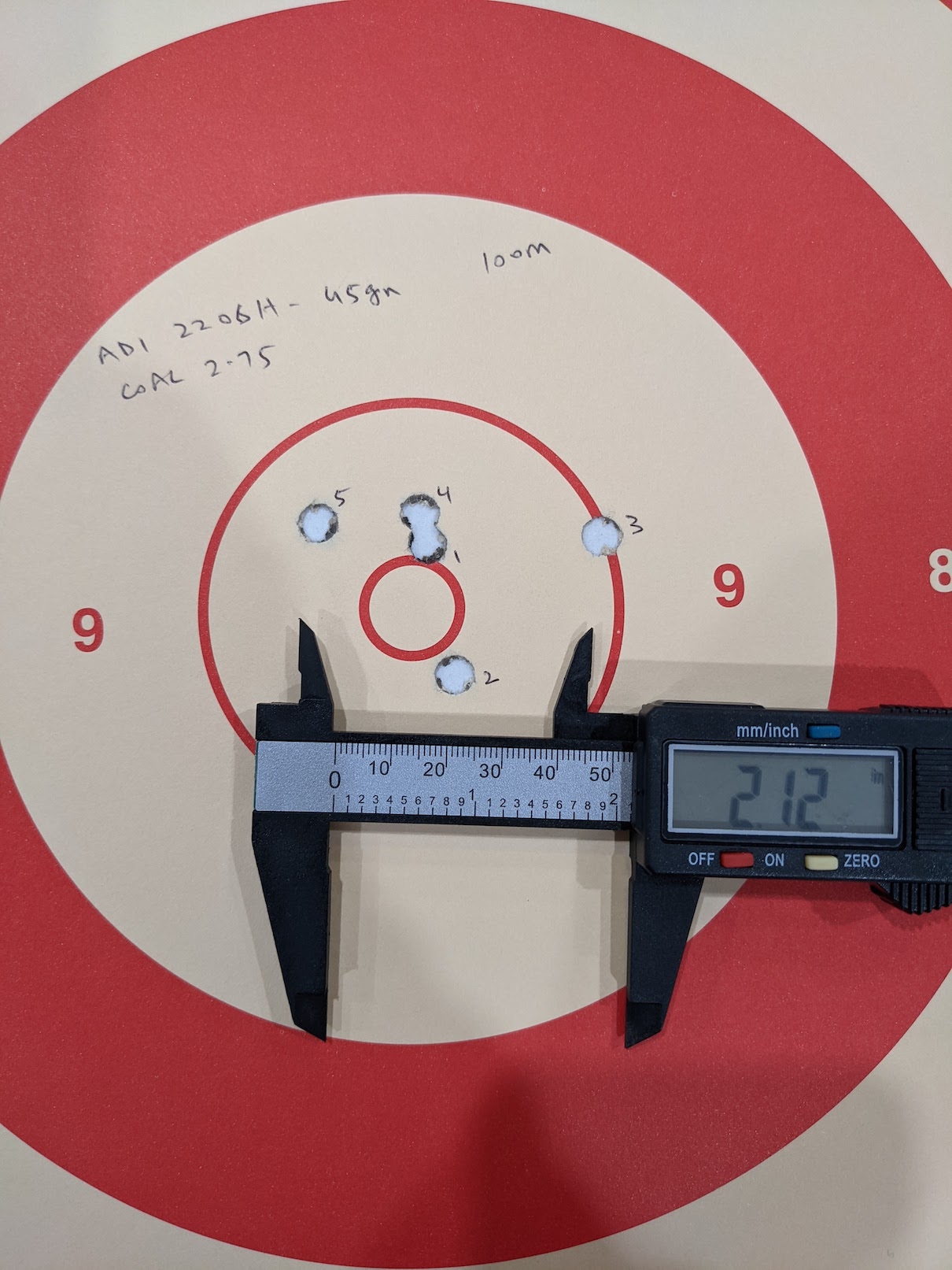

Post by oosmanch » 23 Jun 2021, 2:15 pm
HI All,
i am new to reloading, i have a Tikka T3X SS in .308, for hunting, i am a little recoil sensitive and the usual 150-168gn bullets(sako and Outback armour) were a little bit too much for me so i decided to reload, Hornady make a custom lite low recoil load (with 125g projectile)for 308 but it is not available where i live. so i decided to reload my own, i used,
once fired Sako brass(washed/prepped etc)
Federal 210 LR primer
Nosler Accubond 125gn
ADI 2206H powder
COAL 2.75
ADI website states starting load of 45gn for 2206H for a 125g projectile(sieera softpoint) (nosler doesn't have data for ADI)
as i wanted a low recoil cartridge i started a little low, as follows
5 groups each of;
43gn
43.5gn
44gn
44.5gn
45gn
Results: scratching my head as there is quite a variable spread, i was expecting shots to group better for a certain load and than i can work on that a bit more. the recoil at 45gn was similar to the factory Sako 150gn(superhammerhead).
i am probably happy to go up projectile weight and suck up the recoil
so what am i doing wrong.
thanks
oosmanch

Re: .308 nosler Accubond results/advice
Post by Bello » 26 Jun 2021, 11:47 am
Hi mate
I used the some heavier accubond projectiles in my 308 and 300win mag. I think they were 165 and 180gr projectiles
Very accurate.
Just didn’t get the expansion in the field I wanted at close range (within 100 to 150 meter ranges) so I changed projectiles.
In my 308 I use AR2208 works for me.
You could also try the pre loaded 135gr OSA rounds. I find them to be very accurate out to 200 meters and have stopped everything that has managed to walk in their way.
My light walk around 308 rifle is sighted in for these bullets.
You can also consider a muzzle break. It will reduce the recoil significantly. Get a decent one like a terminator T3 or a grisly.
My 2c
Bello
Post by animalpest » 26 Jun 2021, 4:07 pm
I think your answer may be in your post.
Being recoil sensitive may well be the problem with your groups.
Suggest you try some factory ammo and compare. If that doesn't group then it may not be the rifle.
Or have someone else who is good shooting a .308 to try it.

Posts: 349
Post by Oldbloke » 26 Jun 2021, 8:33 pm
ADI 2206H powder
COAL 2.75
5 groups each of;
43gn
43.5gn
44gn
44.5gn
45gn
Oosmanch,
That load should be very low recoil.
In my 30.06 I load 49.0 gr of AR2208 behind a 130gr siera bullet. Pretty dam mild.
Some comments, suggestions.
1.What is the bullet jump to the lands? IMO 20 thou is a good starting point. You may need to experiment a bit.
2. It's a light rifle, perhaps consider putting a few Oz of lead shot in the stock to add weight. This will reduce felt recoil.
3. 150 to 180gr bullets are traditionally more accurate. Light bullets less so. 125gr may not be long enough to be stable in your rifle. Twist rate is the key here.
4. Check for loose screws, bedding etc.
5. As mentioned earlier have someone else try a group.
6. If its for hunting usually 1.5moa will do the job.
https://bergerbullets.com/twist-rate-calculator/
Post by Greenbeast12 » 26 Jun 2021, 11:42 pm
Oosmanch,
For awhile I thought my 308 was a bit of a rough ride and I had been shooting 168 smks.
I fitted a brake to it and it was great but over time the people that I shot with hated the brake so I removed it and got used to how it shot,
Making sure that your rifle handling is good will benefit you greatly in handling the recoil aswell. Im no guru on it but I do what works for me and I happily can shoot my 308 for however long I please.
If trying to hold the rifle differently doesn't help, try a brake or maybe even a smaller cal and work back up to the full power loads again.
Beware though with a brake you may cause yourself more flinching due to the muzzle blast from them - goes with design though.
Good luck and I hope you can get yourself comfortable around it

Post by SCJ429 » 27 Jun 2021, 1:28 pm
There is a lot of horizontal dispersion in your groups, was it windy?
Post by oosmanch » 27 Jun 2021, 6:44 pm
SCJ429 wrote:There is a lot of horizontal dispersion in your groups, was it windy?
No, barely 1-2 Knotts of wind.
Post by bladeracer » 27 Jun 2021, 7:15 pm

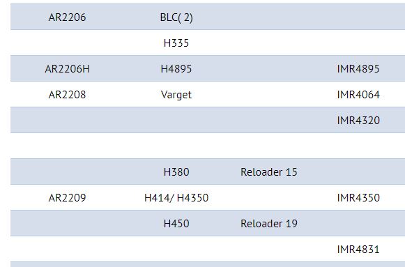

AR2206H is sold in the US as Hodgdon Varget, and I would expect all manuals to list it.
Being new to reloading, and new to shooting centrefire rifles, it would be very difficult to guess if there is a problem. It may be in your reloading technique, consistent method is critical, it may be in your shooting technique (ditto), it may be a deficiency in the rifle (what groups were you getting from the factory ammo?), or it may just be that the specific rifle and bullet don't play well together. If you have a light barrel profile, five-rounds may be more than the barrel can cope with in a session, try slowing your shooting way down and minimise barrel heat.
I finally got some of Hornady's 190gn Sub-X on Friday, designed to expand at 900fps in the 300BLK. I want to try them in reduced loads in .30-30 and .30-06, but also in full-noise loads in both. Some basic research shows that the bullet is quite accurate regardless of velocity. I don't know what you're shooting at, but a subsonic, or reduced load at around 1700fps might be an option for reduced recoil and noise, while still having a bullet that doesn't become an FMJ under 1600fps.
Post by mchughcb » 28 Jun 2021, 8:36 am
bladeracer wrote:AR2206H is sold in the US as Hodgdon Varget, and I would expect all manuals to list it.
From the ADI website.
When I see people with 6000+ posts on a forum like this giving advice to noobs. I shake my head in disbelief.
Post by ZaineB » 28 Jun 2021, 11:50 am
stick to the tightest of those groups, and enjoy, a lot of older rifles struggled to have that accuracy when strapped into a lead sled or similar, plenty of game still went down as a result, your groups will improve as you get let squirty.

Post by bladeracer » 09 Jul 2021, 2:17 pm
Just saw this.
I should have checked it before posting, big mistake.
Thanks for picking it up, mchughcb!
Post by SCJ429 » 09 Jul 2021, 7:57 pm
Try shooting off a rest and rear bag, add some weight to the rifle. Try a lighter trigger pull. Slow down and try a repeatable shooting position, good trigger control and then let the riffle settle after the shoot goes off and regain your sight picture.
Try some wind flags?
