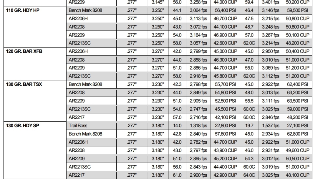

A 130gr at 1537fps for 19.7gr of trailboss. (listed max in their manual) I'm not sure it will cut it for red deer. Fallow, perhaps.
They have been dropped with less....but yes,a bit anaemic. I'd nearly bet you can get more in though. 45-70 max is about 4gn lower than what you can get in the case...
i agree OB . i don't think it would have enough energy left once this load got out there . i reckon at a minimum you'd want a 130 gn to be doing at least 2500-2750 , which at a guess would be on par with 6.5x55 swede mauser 130gn factory loads . bin a lot of deer killed with them . JMHO :thumbsup:
