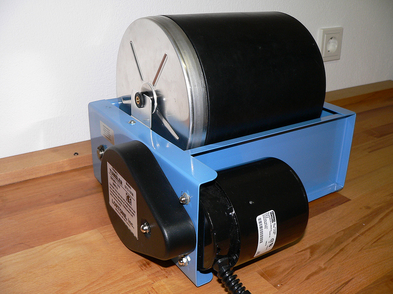

Man, those are monster tumblers :shock:

I picked up my QT12 tumbler yesterday :) assembled it about half hour ago and it's currently running. It is super quiet! The drive shaft and follower shafts are each rubber coated, and the barrel is completely rubber. So the only noise you hear is the very muffled brass moving about inside. I could run this thin I. The same room as a sleeping baby I reckon, and that's why I bought it!
Later on I'll pull some covers off the gear drive and motor shaft to see of there's anything you can get ideas from for your DIY tumbler :)

There is obviously a screw on water tight lid or something on the far side is there?
You take the drum out, fill it with brass/cleaner then lid it and put it back in the drive? Is that right?
Something's holding the water in obviously?

Post by von_klitzing » 15 Apr 2014, 4:53 pm
Ah, yes there is. Pretty hard to describe :lol: so I'll take a piccy when I'm back at work tomorrow.
It's a metal disc lined with rubber for the lid of the drum, and a cap is screwed over that to make the seal with the body of the drum.

Here's the pics of the lid for you. Doesn't leak a single drop, yet :P Image
