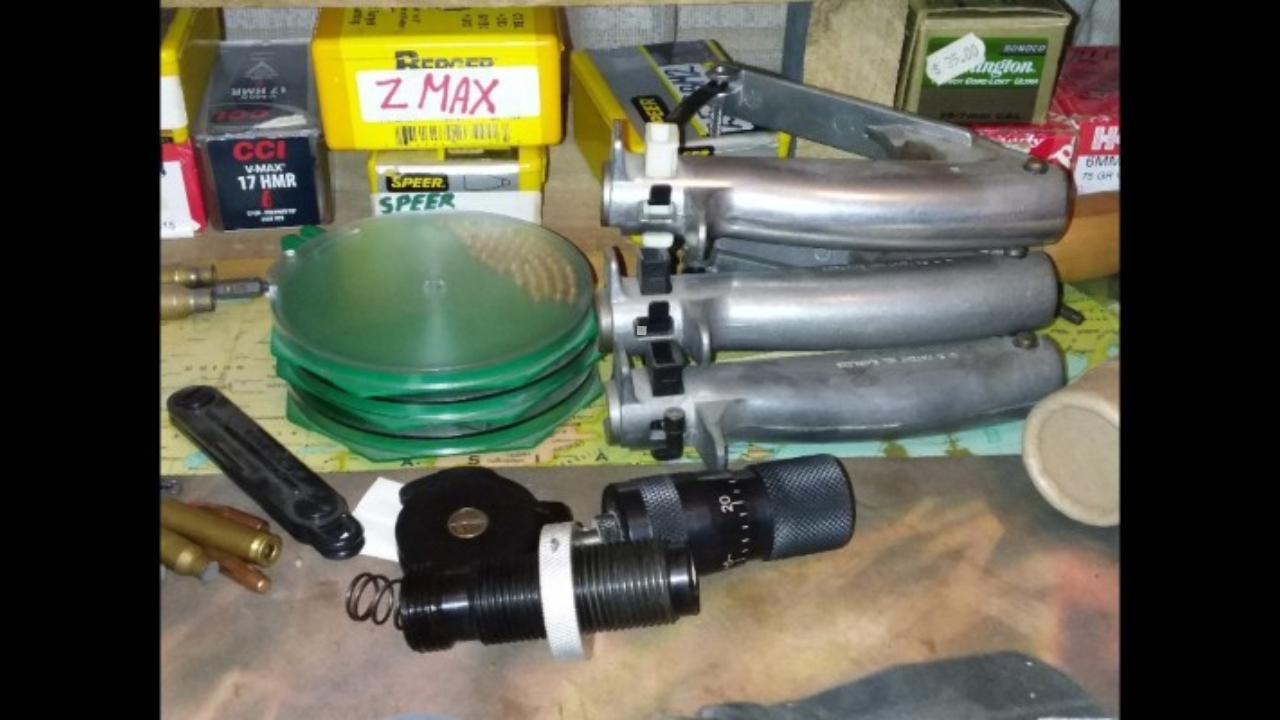

Blr243 wrote:I prime with an old lee hand priming tool. And I probably will do so till the day I die simply because it Is the way I was taught. ....but some primers being harder to seat, age and arthritis I can’t do it with the strength of one thumb anymore so it Is a two handed operation now .....I decided to add a little few drops of oil to the internal parts of the lee tool and bugger me it makes a huge difference and my thumbs are loving it ......what I thought was primer / Pocket resistance Was actually a tool issue. Now the priming process is so much quicker and easier the primers are nearly jumping into the pockets all by them selves
This is why I use these .

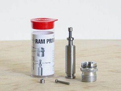

I prime on the press with a Lee die, easy to tell when a primer has bottomed, also easy to pick up a primer pocket that is a little loose.

So, are you using the Lee Ram Prime tool? Been wondering about them.

Oldbloke wrote:So, are you using the Lee Ram Prime tool? Been wondering about them.
No as fast as a good handheld or the integrated ram-prime-n-feed press system on my Lee turret press, but considering its a cheap part it works well.
The fact its included with the Lee hand press kit makes that kit in particular bloody good value - you get a press, priming tool, powder funnel and proper sized tube of case lube for about $120. Some hand primers alone run more than that.
