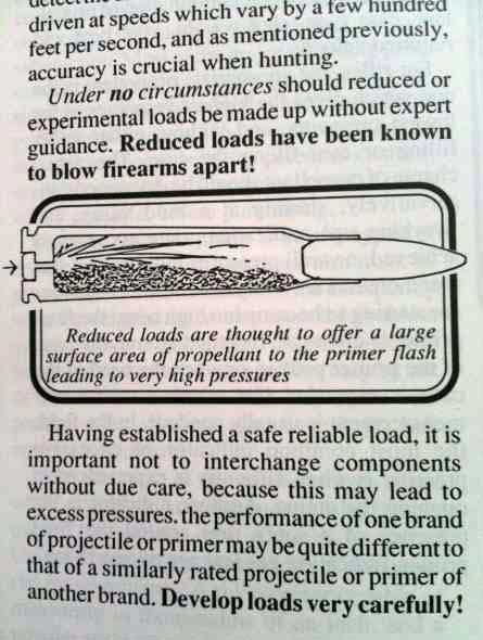

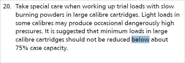

Post by Oldbloke » 13 Aug 2021, 2:30 pm
First 2 images are out of the ADI manual.
You risk a detonation using other powders other than AR2206H or trailboss.There is data around for very fast shotgun powders if you search. But I doubt AR2205 is suitable.
Reduced loads 75% of Case capacity.JPG (39.94 KiB) Viewed 5500 times
Reduced loads 60% max 2206H.JPG (72.59 KiB) Viewed 5500 times
Explosive detonation.jpeg (38.52 KiB) Viewed 5500 times

I appreciate everyone's input, although you might have missed my reference to my having used - very successfully - AR2205 for YEARS in my .270 using up to 165-grain bullets. I didn't use any filler at all and accuracy was excellent, so no pressure variation to speak of. The point of using '05 was to reduce bullet velocity to the point where it is safe to use a .308 on the Ram target at only 200 meters. I'm personally using 24-grains of 2206H behind 190-grain cast lead bullets, but I'm worried that jacketed bullets might be too fast using the 60% formula suggested [of which I am well aware].

I have been a lot lower than 60% with AR2206H with zero issues, right down to subsonic 180gn loads in 8x57mm.

I use a reduced charge of AR2207 under a 125gr pill. I also use a reduced charge of AR2206H under a 150gr pill. Both around 65%-70% case fill. This is done to keep pressures under 40kpsi in an antiquated Mauser 93 action. In a modern action, I’ve yielded impressive 100m accuracy from a listed AR2207 load under a 125gr spitzer. End personal anecdotes.
Now. 33gr of AR2205 under a 125gr pill in a modern action (i.e 70% case fill) - would I pull the trigger? Yeah I probably would. The first one off the hip. Seating depth plays a part, the deeper you go, the higher the pressure. But there’s not much wiggle room - you go north of 33gr and things get dangerous fairly quickly. I personally wouldn’t do it with any heavier than a 125gr 30cal pill. You accidentally double charge?- bad bad bad DISCLAIMER: this is uncharted territory, safe route is to ignore random forum junkies.
